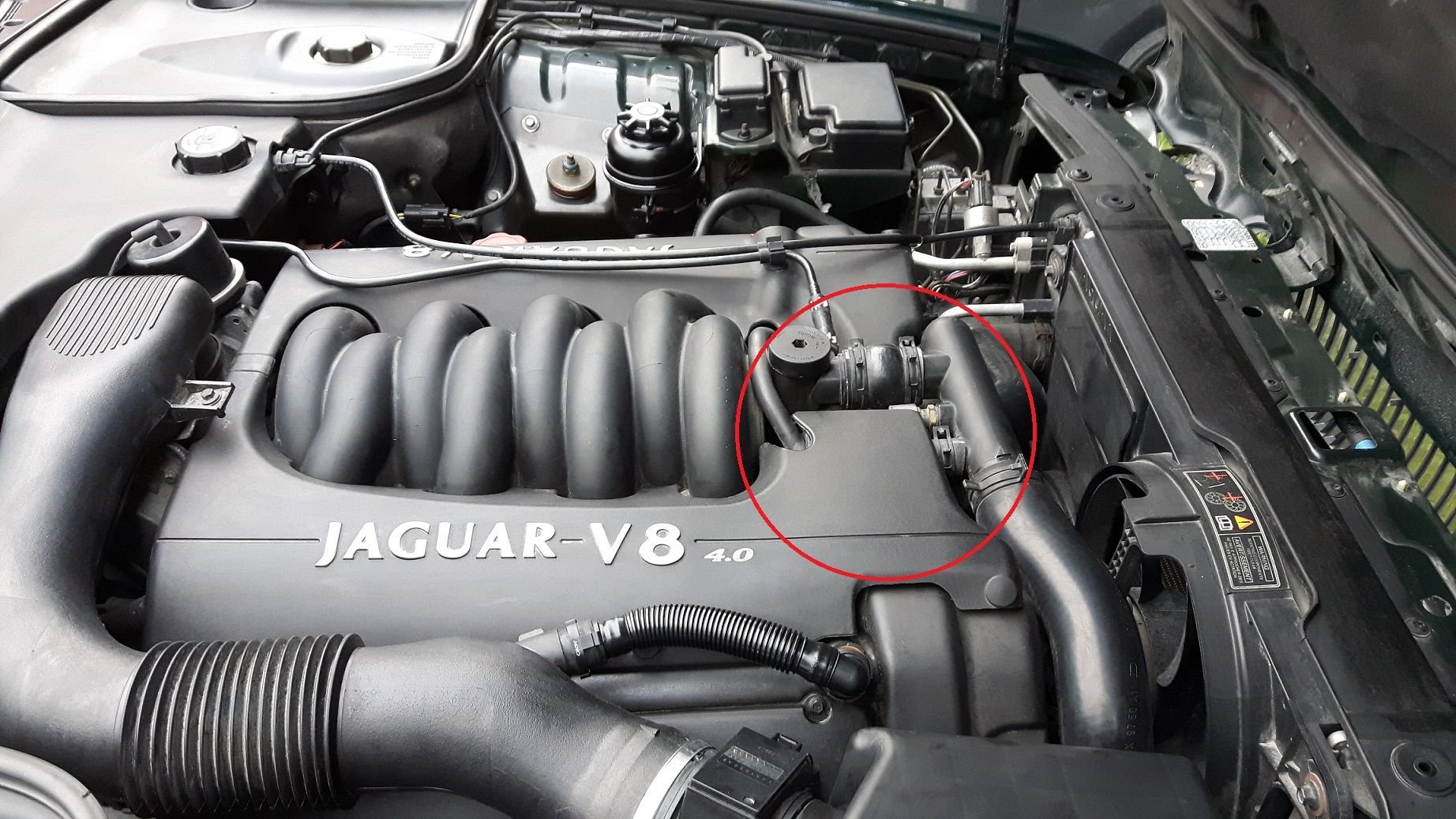

Tried with a little cleaner on hoses/fittings, no results. Removed air filter, box and air intake hose. Cleaned and replaced. Breather hose is only a couple of months old, but checked and cleaned. Checked all hoses I could find. No result, sound is still there.
But listening closely, I can't find other sound source than around the thermostat housing/waterpump or front right side (see pic). My best guess will be waterpump/impeller? I am to change to upgraded aluminium housing anyway.
I am a bit OCD about unwanted noises and it is starting to get me :-).
Any other tests or diagnostic tips or do I wait after waperpump/housing change?

I'd replace that bypass hose ASAP! Looks like it's about to blow.

You mean the "breathing hose" below the red circle on pic? It is completely new?! Bends a bit due to new plastic. Can I try to remove it and start engine briefly?

Oh, I guess you mean the short hose on termostat housing? Yes, it is a bit "blubby" but by inspection it feels ok. No abnormal pressure, just tight fitting. I will replace it together with new housing and water pump.

Bcrary3 is referring to the short coolant hose between the crossover pipe and the thermostat tower. It does appear to be bulging and should be replaced. It would also be a good idea to replace the thermostat tower, thermostat and crossover pipe. An aluminum tower is available.
