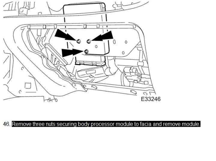

A *good* picture would be helpful at this point.
I don't remember any difficulty with access and I was up in there with both hands, a soldering gun and wires making modifications to circuitry.

Plums - Here you go:
Jim Lombardi

BPM Removed. Thank you guys.
