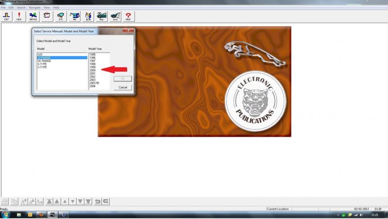

1. open JTIS. Select XJ RANGE and your MODEL YEAR (shown here arrowed in red):

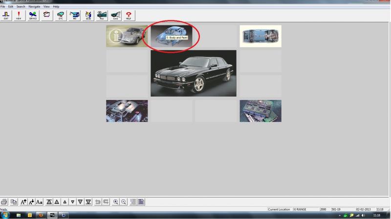

2. click on the second graphic from the left on the top line (circled in red):
It will show '5: Body & Paint' as you hover your mouse over it.
