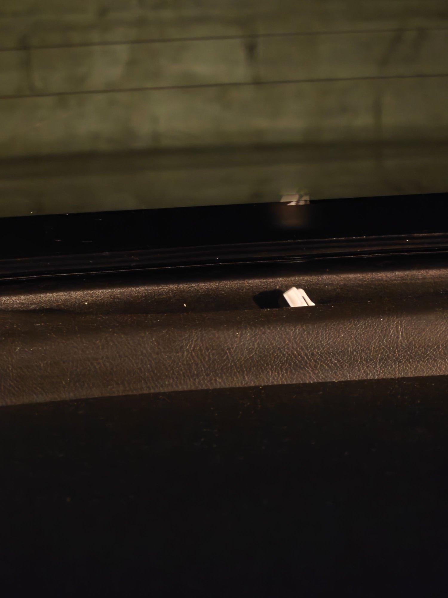

Middle bottom of rear Window, something missing
So I just went down to check the aerial end. Is it at the top? If so it is making proper contact. If it is at the bottom, it seems I am missing something? I attached a picture, maybe someone can also help me identify what goes on there?
Old Jan 29, 2025 | 02:14 PM
motorcarman's Avatar
Posts: 13,699
Likes: 9,645
From: Wise County,TX
The connection is at the TOP of the glass.
Old Jan 29, 2025 | 02:28 PM
Time0n's Avatar
Joined: Jan 2025
Posts: 6
From: Germany
Hm well then it is connected. Unlucky, any other possible solutions? Thanks anyways!
