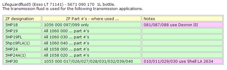

Eriksson Industries filled the transmission with Lifeguardfluid5 (Esso LT 71141) after they rebuilt it.
Here is a photo of the 1 liter bottles:
Here is reference guide:

Thats the original fluid - interesting how ZF specifies that the authorized rebuilders use the original fluid. I get it through Autohaus ... They used to consider the original a semi-synthetic vs the later aftermarket full synthetic.
Autohaus used to carry the original MB fluid for the XJR .. now NLA

That is a better price then Autohaus ... although I normally only bought a few at a time.
I believe the ZF stuff is the actual Esso product -- now Mobil. You can still get the OE power-steering fluid -- that is labeled Mobil.
Anyway .. good luck!
