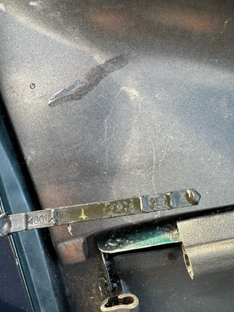

I checked mine at full operational temperature after about 15 miles.
I did this because I was in city traffic jam for 30 mins and I noticed reluctance to come out of first for age’s afterwards after getting to the outskirts of the city. Then I noticed warning light on dash “engine coolant level low”.
As I had already picked up my daughter and her boyfriend for dinner I pressed on as I was late.
The coolant warning went on and off… after reaching my destination I left her and then checked the water level.. didn’t seem that low so I topped it up with a pint of mineral water from the restaurant.
No more warning light.

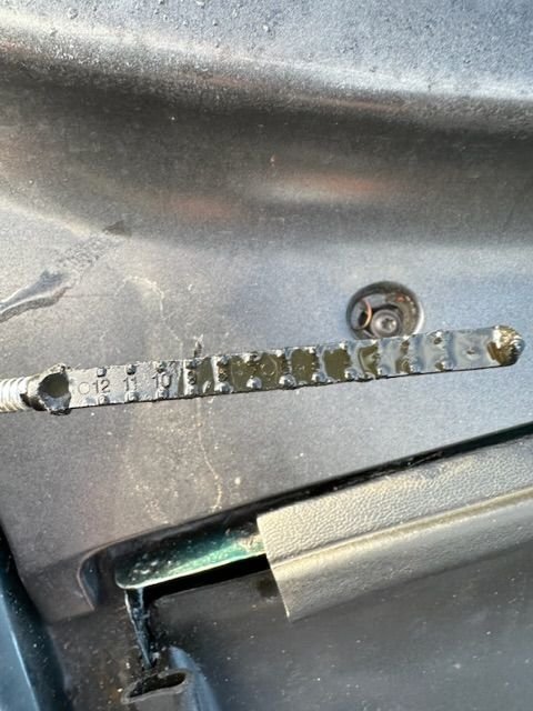

This morning I got the engine and box up to temperature and used the dipstick- she was registering at just below the max scale of the 80 degree.
Oil looked fine.
I’m thinking the oil got really hot and stressed the electrical connector again… it happened in summer’21 so may well be soft.
Does anyone have a different opinion?
does the oil level look low and need topping up, if so how much should I fill through the dipper pipe?
I’m tempted to just try and get a new seal for it and ask my mechanic to fit it.. then top up.

Unless sure about where the ATF level currently is, I wouldn't just pour in additional fluid. The Jaguar Workshop Manual warns that any excess of ATF "MUST" be removed. This is because if overfilled, the ATF will start foaming (being turned into a "milkshake" by the rotating parts) which will cause drop of the fluid pressure, malfunction of the transmission and possible damage.
You said that the level was "just below the max scale" but I see that it is just below the "min" mark applicable for 80C. Before you can be certain where the level is, make sure that the dipstick is fully inserted when taking the reading. Otherwise it will show you low level when it actually may be overfilled. On my transmission (Daimler Super V8), it would look like the dipstick reached the bottom at about 1 or 2 inches before actual fully in. Wiggling the dipstick and pulling it back a bit than in again would overcome this last resistance.
You can make a mark on the dipstick at 704 mm from its tip and see where it is after you have inserted it. According to the measurement I made on my transmission, the 704 mm mark aligns with the top of the tube when the dipstick is fully in.
