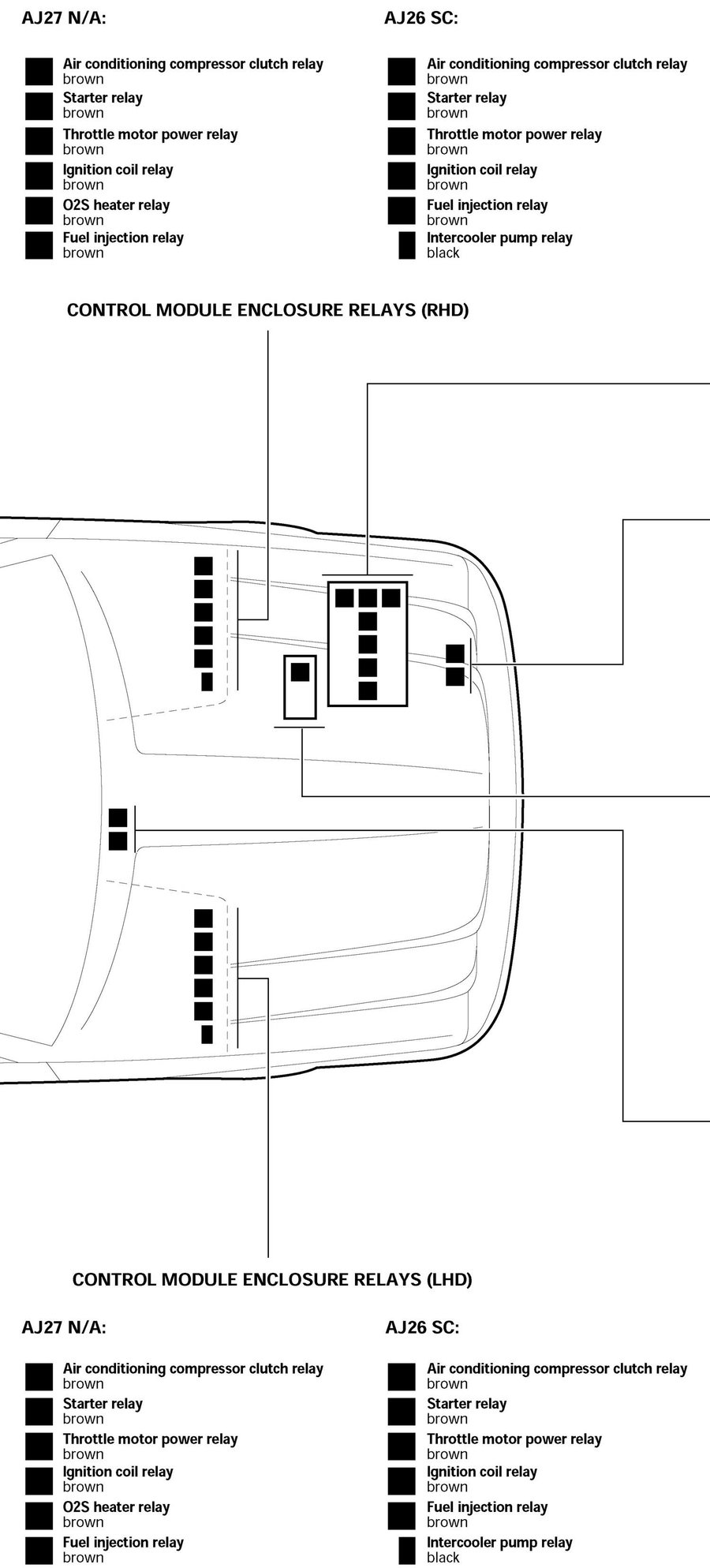

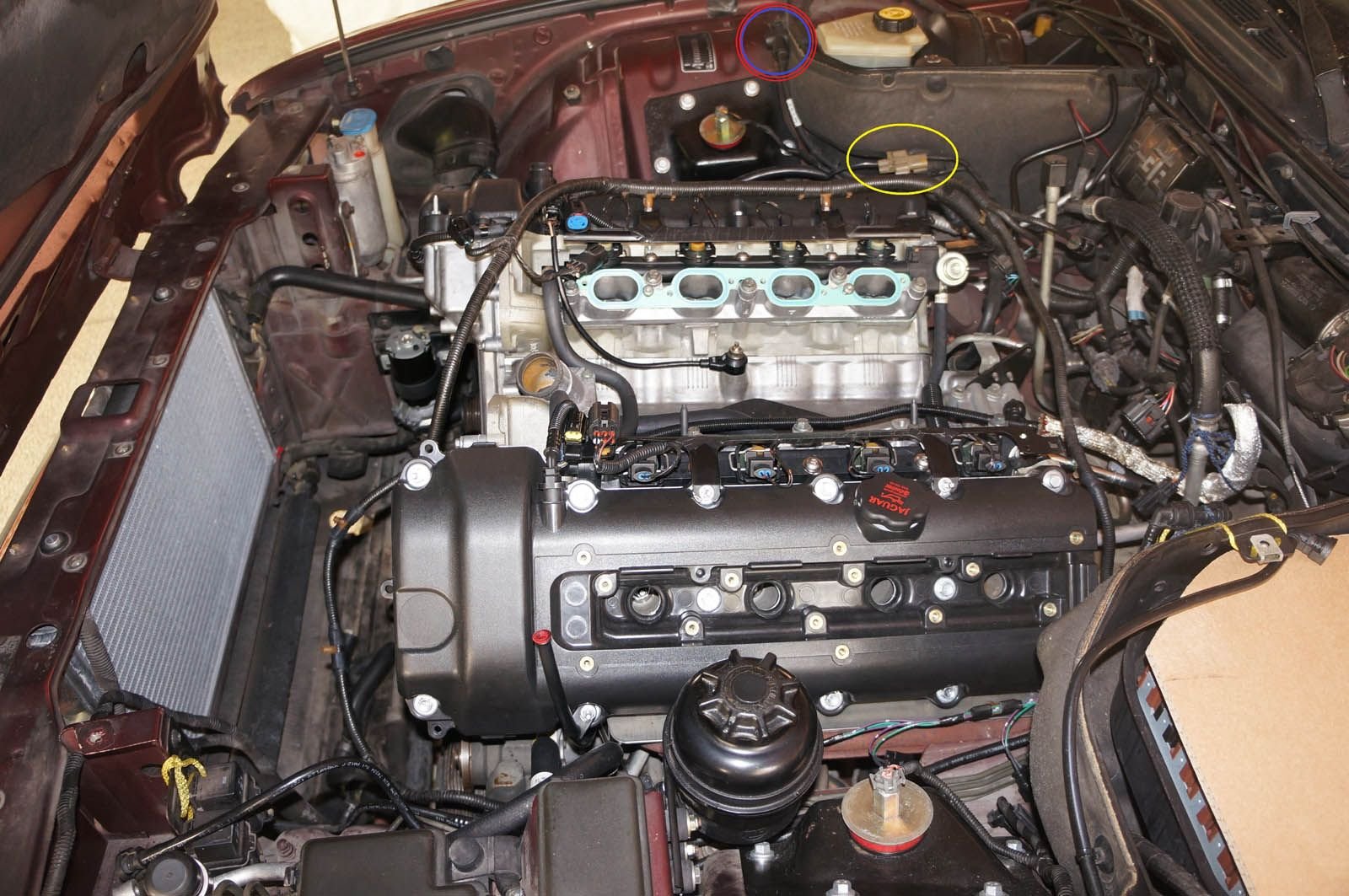

Old Nov 29, 2020 | 08:32 PM
M. Stojanovic's Avatar
Joined: May 2017
Posts: 1,699
Likes: 897
A couple of simple things you can try:
1. Check whether the starter relay is clicking when the key is turned to "start"
If the relay does not click, the problem is possibly in the Body Processor Module.
2. If the relay clicks (but the starter motor does not engage), check the inline connector (circled yellow) on the wire going to the starter solenoid for corrosion:

Old Dec 2, 2020 | 08:24 PM
Joined: May 2017
Posts: 1,699
Likes: 897
Originally Posted by Startupboy
I hear a faint noise from the glove box area when I turn the key.( I can jump the starter with a screw driver, but the car won't start )
Interior lights go out when I turn the key to start,
The "faint noise" from the glove box area could be from the starter relay which is in the engine compartment just in front of the glove box. The relay location is as shown on the diagram I posted above and in the compartment where the ECU is located. You can see this compartment on the picture I posted, bottom right corner, covered with a piece of cardboard (it will be on the opposite side on your car). If you open the compartment and verify that the starter relay is clicking when the key is turned to "start", that would be good news.
The fact that the interior lights go out when turned to "start" suggest that you have a bad connection somewhere on the main power distribution cables or on the ground cables. Check/clean the connection on the "firewall", circled red/blue on the picture I posted (opposite side on your car) as well as thick cable connections (covered with rubber caps) at the two fuse boxes in the engine compartment. Also check/clean the connections at the big fuses in the trunk (in front of spare tyre). Check/clean the connections of the engine ground cable.
