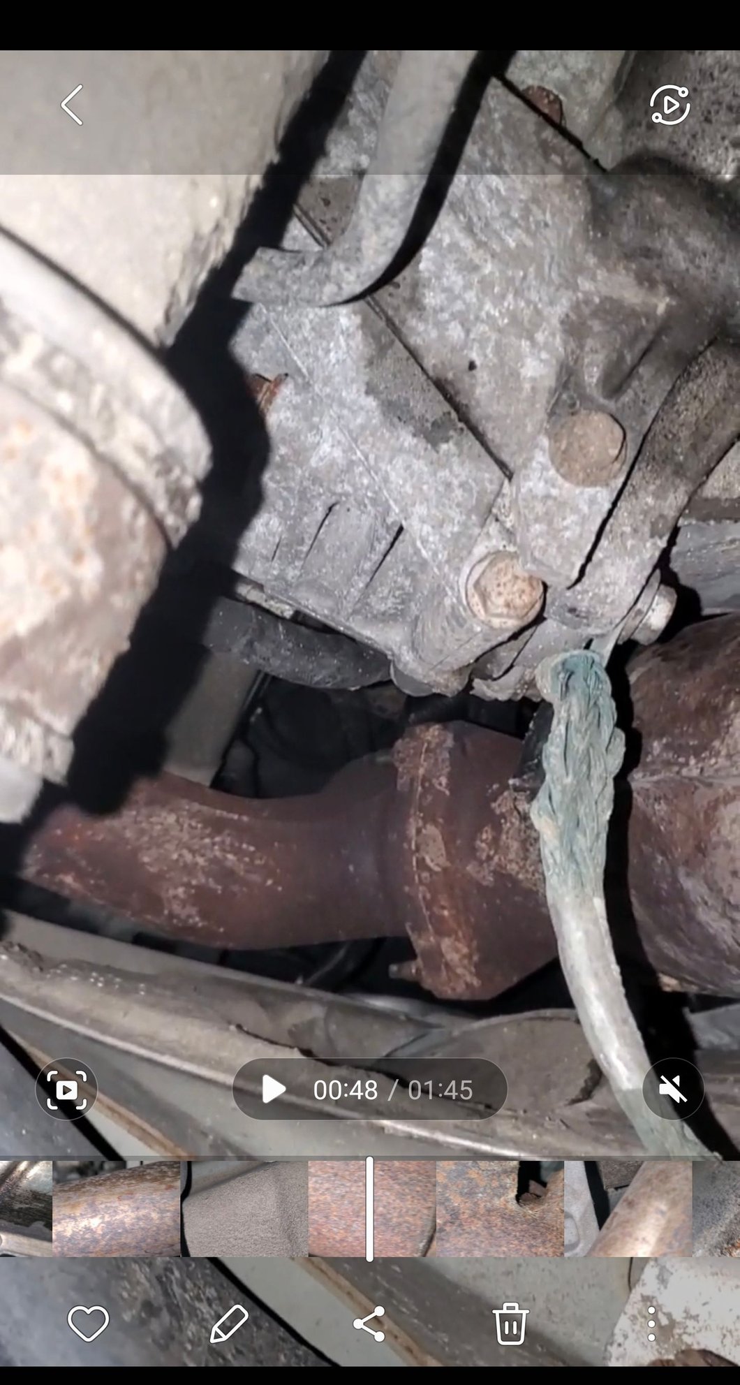

Battery tested out at 100%. Had it checked at the auto parts store. HOWEVER... I'm curious about this grounding strap located upfront on the passenger side attached to side of bellhousing.
What kinda havoc could this cause? Must be needed or it wouldn't be there but what if it wasn't? Plenty of grounds on the car and i'm not sure what its attached to. Looks like a tainted ground to me.
Just found while reviewing a video. Is it a problem?

The starter and alternator need a HEAVY ground strap.
I remember many decades ago when the speedometer on a car would stop working and the cable was found to be MELTED.
Turns out the earth strap would fail and the starter needed to get a ground SOMEWHERE so the speedo cable was it.
That's nuts! Not a place for excessive heat.
Now I'm unsure exactly where I found that ground but I did it from underneath. Couldn't spot it from up top. Looks like another ramp job. If it'd quit raining I could get it up. Thats what I told her anyway.
I did make an approach that raises the car enough to go up the ramps I have. When it clears up I'll pick my spot and take care of the ground. I've got extra phat ground wires ready to go so I'll reinforce where I can. The ones for headlights and the hood hinge I sprayed down with DeOxit D5.
After thinking about it I began to wonder Again! About the tranny codes and the location of that ground. Coincidence? Doubt it. One way or another everything is connected on a Jag!

The earth strap is as close to the starter as possible.
