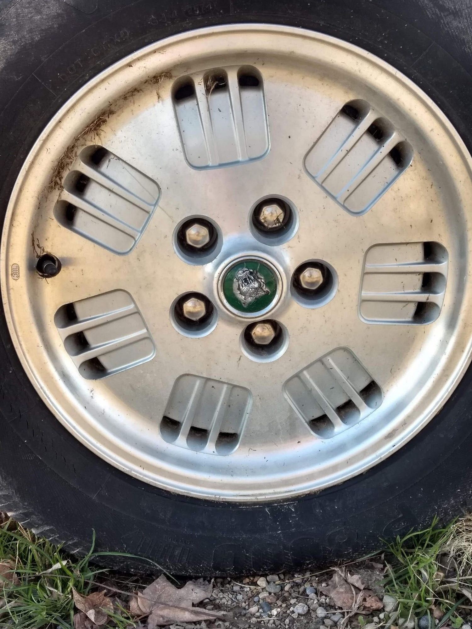

Nice aero alloy rims in good condition ...brakes no good? Is that why you're asking about them?
In my opinion, parts are not really hard to get and the cars are quirky but pretty straightforward to work on. Paintwork looks pretty sad but all dark clearcoats look like that after sitting out in the weather for years ...A bit of prep and few clear spray bombs can improve matters considerably until (or if) you get a respray.
