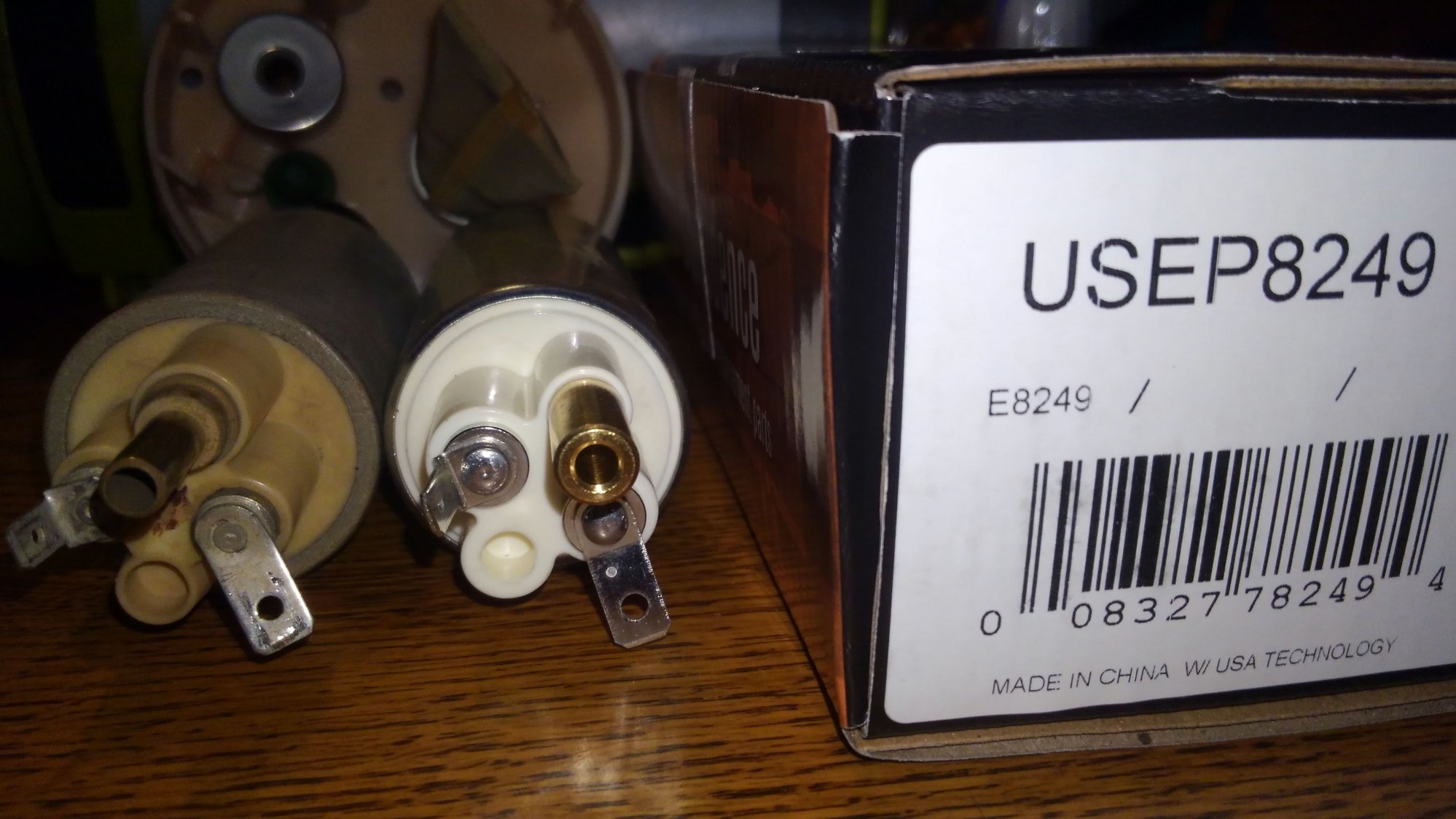

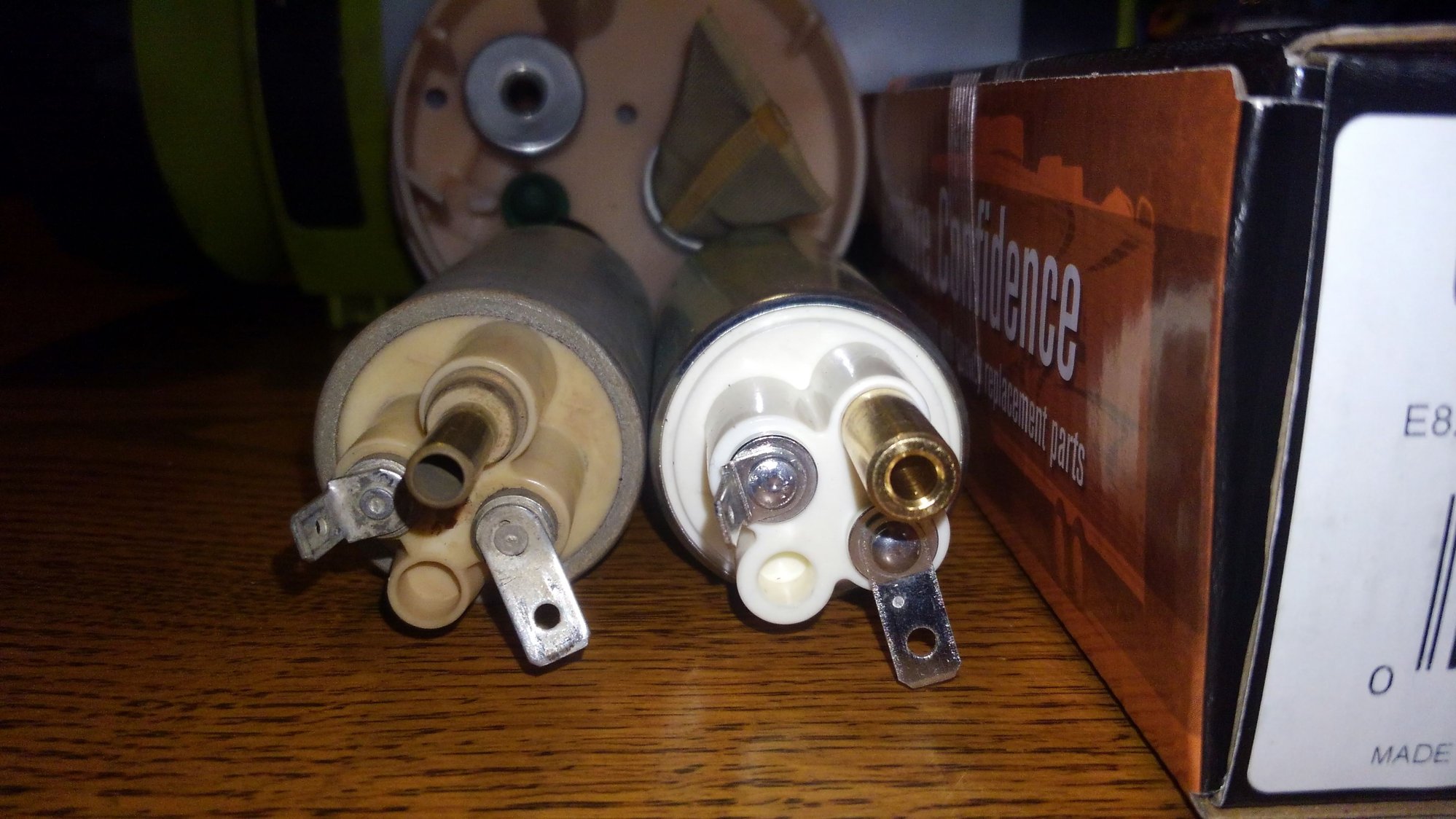

Default Not quite right
Larry, I got the USEP 8249 fuel pump from Rock Auto and most matches except output pipe diameter. It is to big to fit into the donut. It is brass and I am thinking of using my Dremel tool to remove some and polish to make a smooth fit into the donut. Also should I be able to blow through the tower (plugging the donut)? Or will it take more pressure than I got? I don't want to whittle the brass piece down and it still be blocked. Thanks ProQuest
Old May 27, 2023 | 09:51 AM
Lawrence's Avatar
Posts: 2,729
Likes: 1,910
From: Victoria BC Canada
That's too bad, major hassle. Why not return it and get another one? This one has the right size looking at the illustration ..
