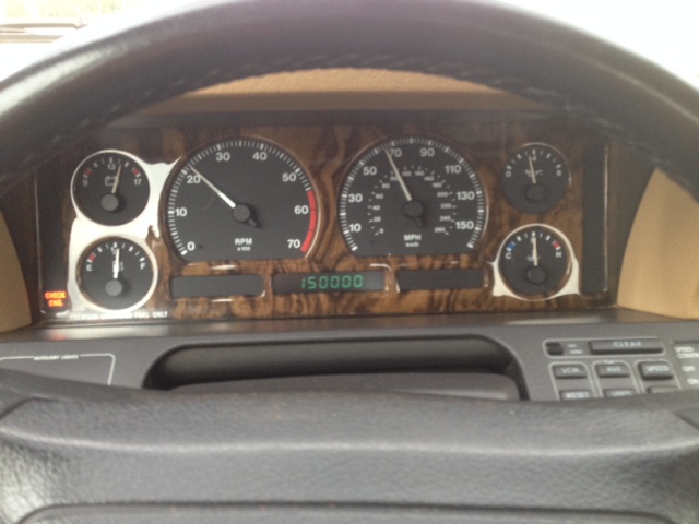

Hi all. I guess I gotta start yet another thread. The Moneyfunnel is at it again. Service engine light is on. Code is FF44. As always I have researched till I am blue in the face and done testing till I "simply caint go on."(Faints, falling backwards into the Colonels arms, drops parasol) All O2 sensor checks "seem" fine. I have 6 ohms between the 2 terminals, 12 volts to the one and (as I recall) .43 volts to the other, and .8 to 1 volt on the heater wire. The sensor in the car is under 2 years old. I have the old O2 sensor that I removed from this car with its old Y pipe- I could not remove the sensor at the time. I believe it is good. I am tempted to think its the sensor despite the test results because.... Wait for it..... No Symptoms. Car runs fine. No new noises. all the lights work (AND the windows thank you very much!) It starts same as always, still stops. I just Hate that light. As a curious aside, the car passed 150000 miles the day after the light came on. As you see, its not exactly wheezing....

I am so so so sorry. I must dredge this thread back up Yet again. In our adventure last time, we replaced the O2 sensor for a ff44 code. This cleared the code at the time. 2 weeks ago, while Roger was laid up for ff14, the 44 code came back on this car. At almost the same time it developed a 100mi/qt oil leak. Needless to say I was annoyed. Chagrinned might be a good word. Peeved would also work here. I refused to believe that a new part (the O2 sensor) could fail that fast "in My Possession" and went about finding either a connection with the leak or a secondary cause for the code. Roger was fixed yesterday of the ff14 code after I came to my senses and unhooked the battery for a while.

Received the 3rd sensor (of the same brand as the 1st and 2nd ones I installed) and installed it. I handled it very gently, didn't drop, kick, or otherwise launch it. Unhooked the battery and, since it was opening day for the '17 boating season drove by work to see who all was there. (No One). Light is out again. If this one lasts beyond the warranty I will replace it with a more expensive one when it does go.
The 2nd sensor was replaced November 8th of last year- 5 months ago, as we may recall at 150000 miles. I do not drive the cars in salt, so it sat Most of that time. The car now has 150831 miles as of yesterday April 1st. It seems like I should get more than 800 miles out of a part..... Thus ends the 2nd chapter in our exciting story. Tune in next time kids when we hear Bones say "Dammit Jim! I'm a doctor not a mechanic!"
