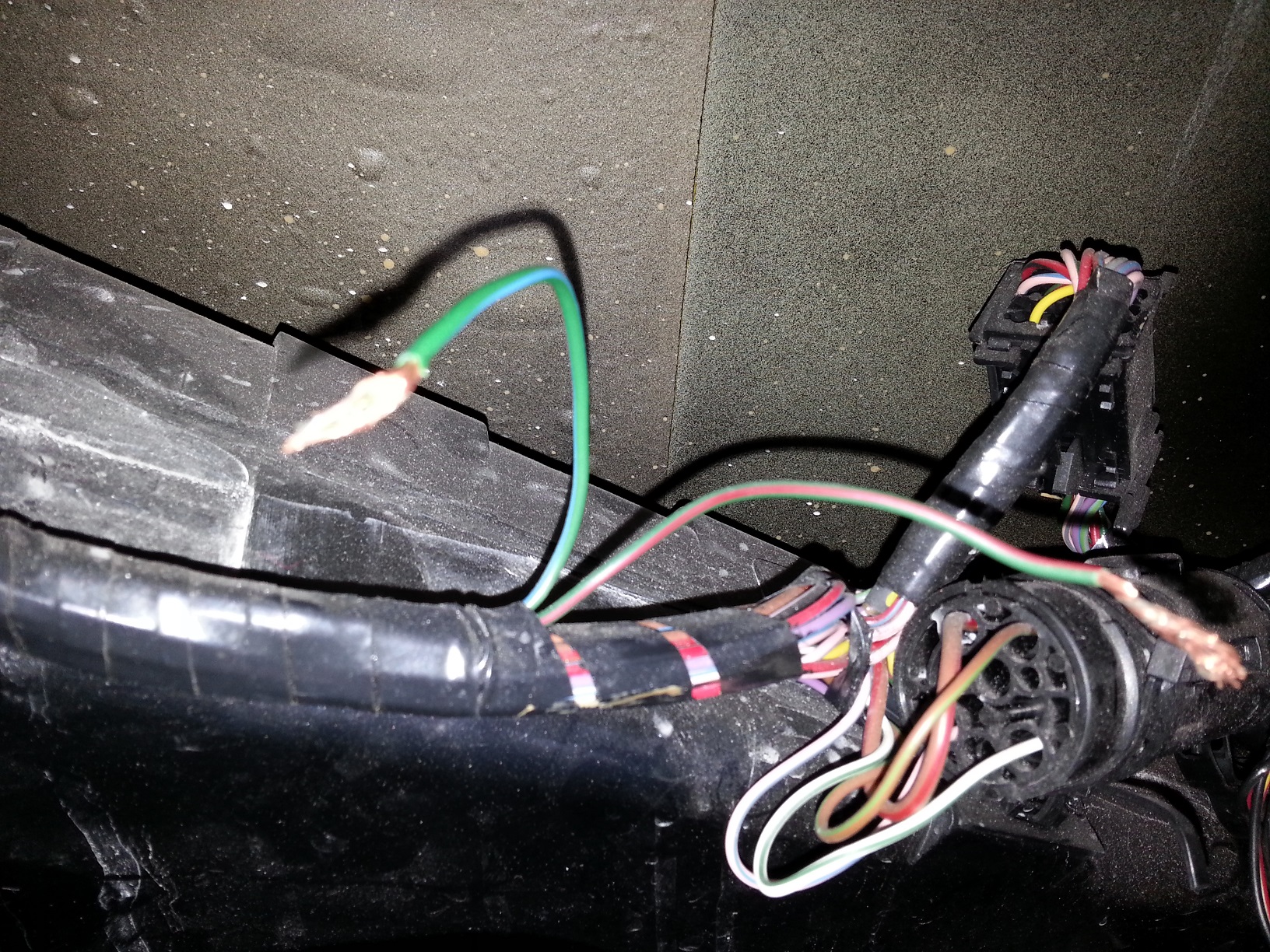

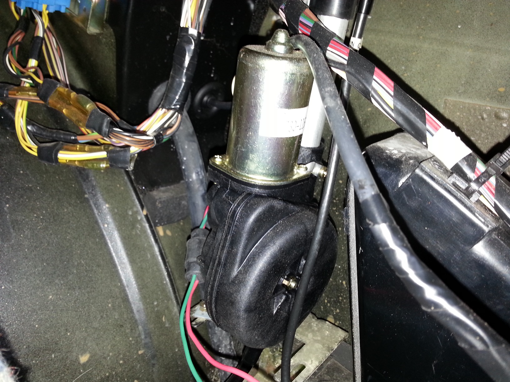

One of these is the power antenna. It doesnt go up or down. I found that the antenna was not hooked up on the Coax side. Got that fixed. Then there was a red wire and a green wire from the antenna that was not connected to anything. Also along the wiring harness in the back there are 2 wires (I am assuming for the antenna) that are green one with a blueish stripe and one with a redish stripe. They are stripped out and just hanging there. I am going to check some electrical diagrams unless one of you knows off hand what they are . I tried to hook up the wires from the antenna to the two loose wires as one should be up and the other down and nothing... I have to bench test the antenna to see if it is working at all. I think I can use any 12v battery to test right?

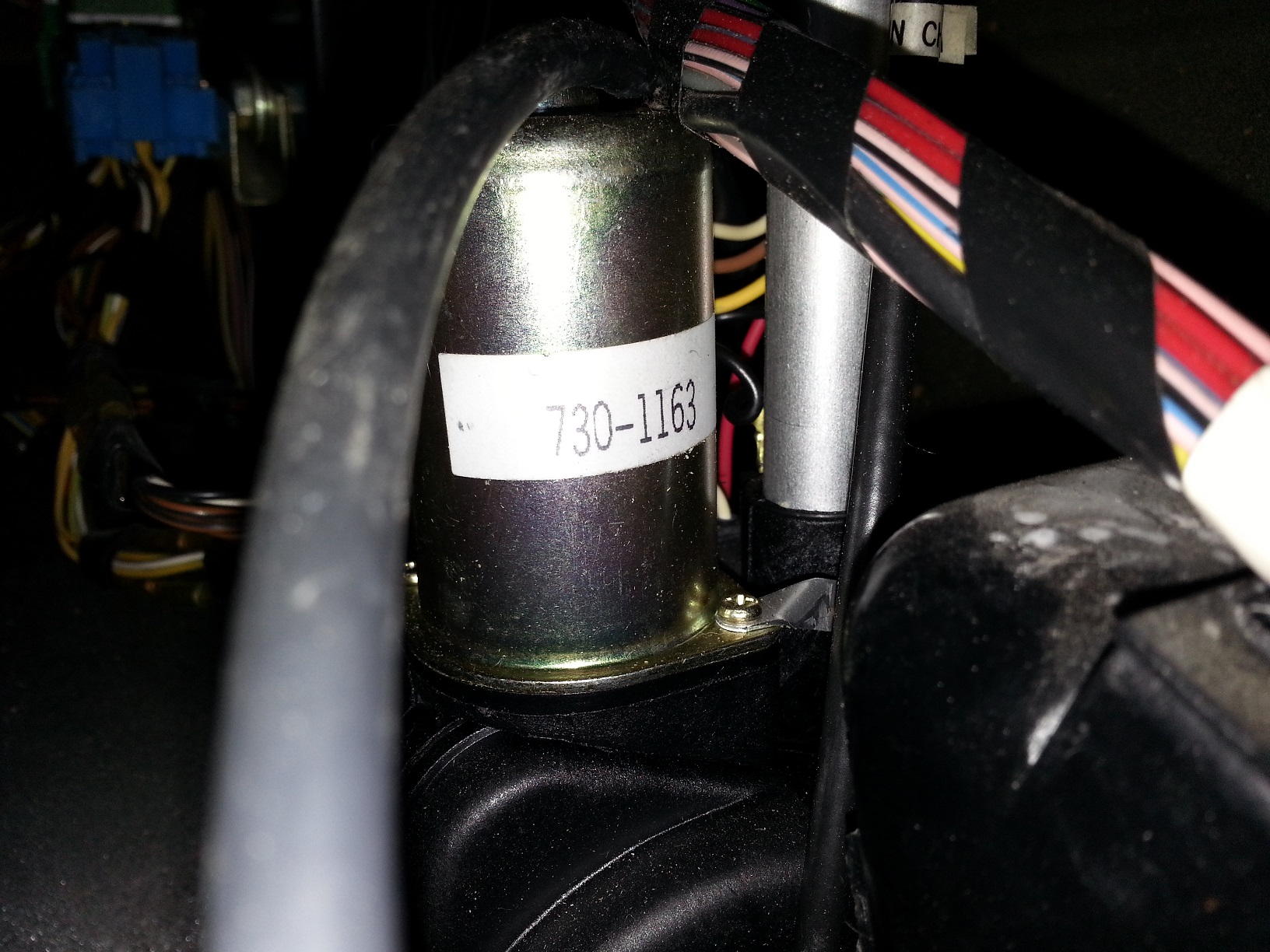

Ok more messing with the antenna. I touched the leads to a 12v source. Hear a buzzing sound but no go up or down. This is what I am working with. Since I didn't do any installs or fixes I don't know even if this is OEM or what.

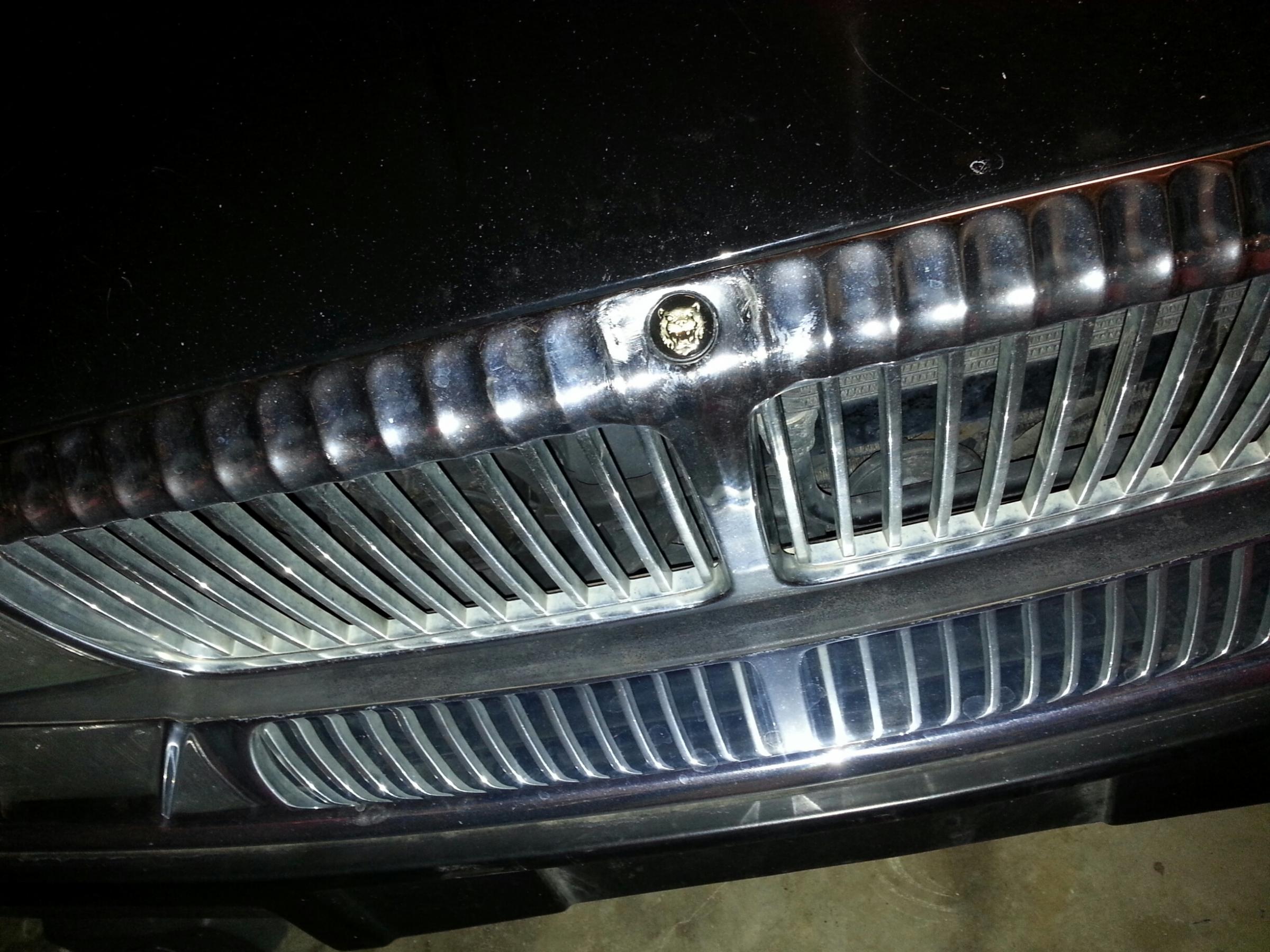

Does anyone know of a good write up or how in general to replace the Growler badge on a VDP on the grille? The previous owner had the badge stolen sveral times and replaced it with a Jag Plug. I removed the plug but not seeing how to maneuver the new badge in place with the retaining arms. I am concerned that if I bend them out one will break or I won't be able to get them tight again.
Thoughts?

reference you antenna.
the red and green wire take the aeriel up and down. if you connect it direct to a 12 volt battery, red on positive and green on negative, the antenna will/should go up or down. swap the wires over on the battery, so that green is to positive, red to negative, the mast will go up or down. cant remember without testing myself, which way round the wires operate the aeriel/antenna. without checking, i would assume the black is an earth/ground.
`I am assuming for the antenna) that are green one with a blueish stripe and one with a redish stripe.`
doubt this is for the antenna, but again, without looking, not sure what it would be for!

I used a battery for my drill and the motor makes a noise but no up or down no matter which direction I go. Almost sounds like a buzz.
I am going to have to spend some time with a wiring diagram to find out what the 2 cut wires are. I would assume to the antenna but who knows.

Oh and ps. The grill you have is different from the VDP. The VDP is "fluted" so there is no mount point. I used a pair of curved nose pliers to give me good surface area contact and bent the prongs. Slid the medallion into place and bent back. All is good with the front badge.

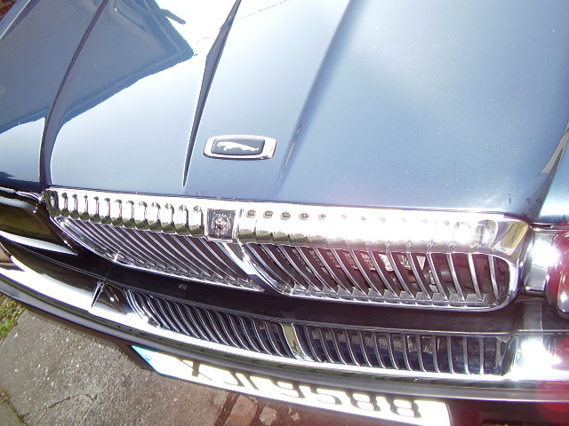

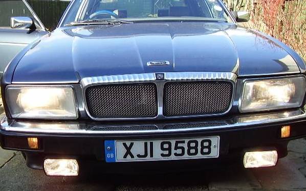

although my car is a sovereign, i have the fluted daimler grill myself, WITH growler in the middle;
Attached Thumbnails All mechanical stuff fixed now some work on misc stuff-fluted-grill-1.jpg   All mechanical stuff fixed now some work on misc stuff-fluted-grill-2.jpg

Sorry I hope I didn't offend. I didn't realize you had a different grill. Mine there wasn't enough surface area to use the sticky tape on the bigger growler. It just has the hole in the center with the little medallion.

Here is the original part. 14 instead of 60 bucks USD.
Attached Thumbnails All mechanical stuff fixed now some work on misc stuff-20130530_190344_resized.jpg
