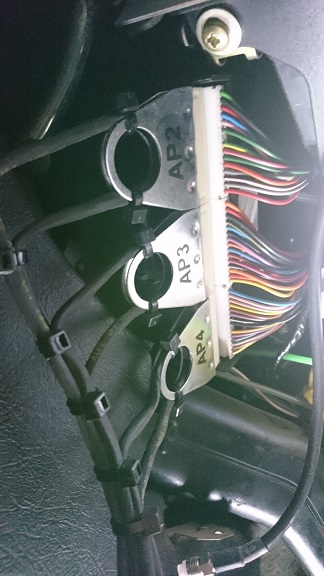

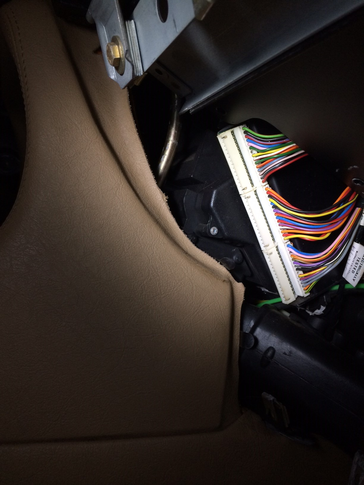

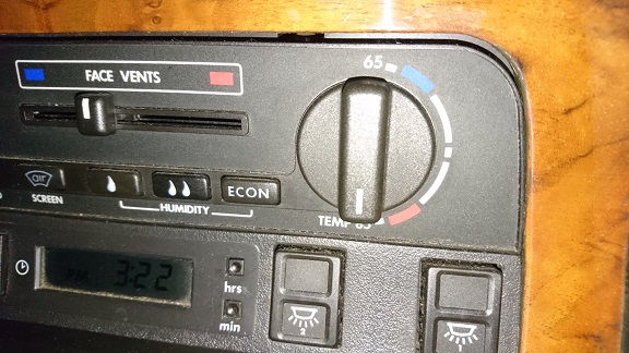

This looks like it could be fun...anyone know what connects to this connector, to the right side of the console behind the trim panel on an 1989? Looks like a ribbon cable might connect to it on the frontside...
Hi Pete,
That connector is for the Climate Control ECU. The photo album at the link below shows some additional views:
Welcome to Jag-lovers - Members Photo Viewing Page
Off the top of my head, I think the XJ40s did have a diagnostic connector, maybe in the trunk/boot? But it is a proprietary Jaguar connector that only works with dealer diagnostic equipment. I don't know about the '89, but our '93 is OBD I. The saloons weren't standardized to OBDII compliance until the X300.
I'll be curious if any of the other members recalls any additional info about the XJ40 diagnostic connector and system.

So I got into this a bit yesterday...Don, thanks for your input as always... after pouring through some Delanaire docs. Sounds like it basically interfaces with the JDS Jag Diagnostic System for troubleshooting. Is there a listing of what all of these inputs/outputs are, or what their thresholds should be?

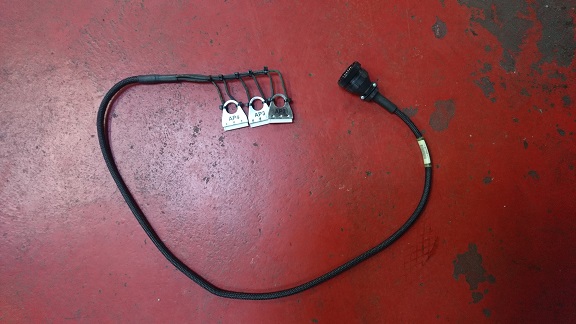

THANK YOU THANK YOU THANK YOU!
That large connector is the wiring to the Climate Control Module (CCM) Computer. Those are the wires for the rotary flaps, blower motors, vacuum solenoids, temperature sensors, solar sensor, and feedback potentiometers. I remember reading somewhere that the pins are exposed for diagnostics purposes like feedback potentiometer voltage checks when the system is malfunctioning. I always figured a technician would use a DVOM to probe those different pins and check for malfunctions that way...
Now that you've posted the picture, however, it appears that not only can you probe those pins with a DVOM, but you can also connect a Jaguar PDU (Portable Diagnostic Unit) to the Climate Control Module directly, and perform Guided Diagnostics Procedures with the help of the PDU.
My PDU stuff came with a couple of cables I couldn't identify. I think you've helped me solve that... According to my PDU manual, this is the "A/C interface adapter" for the Mklll and MkiV Climate Control systems.

Unless I'm seeing things, I believe I have the very cable that allows the PDU to interface with XJ40 Climate Control Modules. The large multi-pin connector on the end of the cable connects to the VIA unit, a big module that interfaces the car wiring to the PDU...
Intersting Stuff! I don't think the PDU was around in 1989, and therefore, I think the WDS also had this capability to connect to the car's harnesses through connectors like this. My Jag mechanic who worked at a Jag dealer for 20 years told me the WDS was called the "harness machine" because no matter what the issue was, it always told the technician to replace the whole harness.. Haha. No wonder why they needed a replacement.

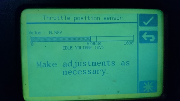

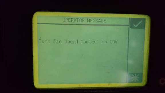

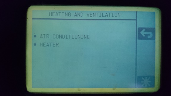

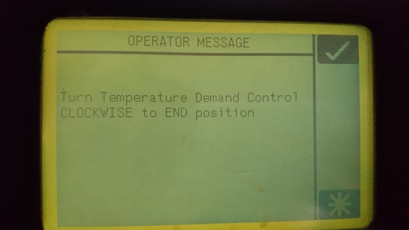

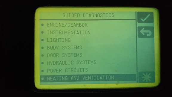

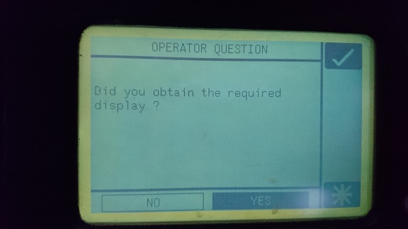

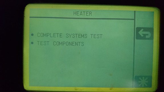

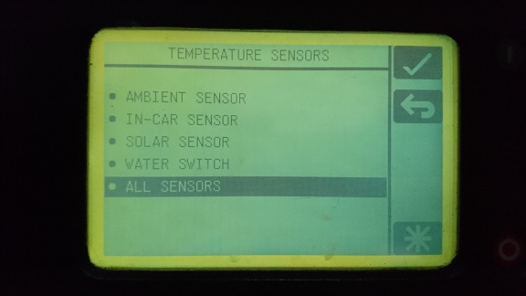

I came a cros this thread and I thought to show you guys a little bit more of the PDU. I connected the PDU to the climate control and tried to check some things. I was a bit short in time so I couldn't finish and wasn't able to do all the tests but maybe an other time but for now I have made some pictures for you guys.
Now I have to find the correct probe to do more testing and have to try an older CD version to see if that make any different. It would be nice to see the live values of the sensors.

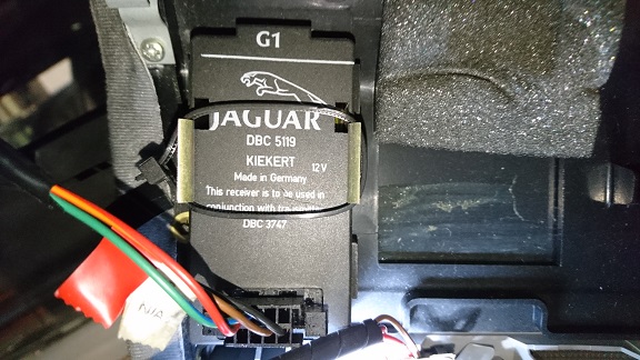

But the reason I found this thread was because I was looking where this connector is used for. I do know this type as a diagnostic connector for Rover MEMS Engine management but haven't seen in in a Jaguar before (and I know it is not the diagnostic socket of the Jaguar Engine management).
Anybody?

Old Jan 21, 2018 | 08:57 AM
motorcarman's Avatar
Posts: 13,692
Likes: 9,638
From: Wise County,TX
Is that the Infra-Red Security System connector??
bob
Old Jan 21, 2018 | 10:22 AM
Don B's Avatar
Posts: 20,503
Likes: 15,276
From: Crossroads of America
Hi Gijzzy,
Thank you for uploading the photos of the PDU in action - very interesting.
Regarding that electrical connector, I like Bob's theory that it's related to a security system that may not be fitted. It's not for a sunroof motor (that also isn't fitted). What's the year and model of the Jag?
Cheers,
Don
Old Jan 22, 2018 | 02:48 PM
Gijzzy's Avatar
Joined: Nov 2011
Posts: 121
Likes: 36
From: The Netherlands
bob
I think it isn't because the infra red receiver is in place and has got an other connector.
The car has a VIN ending with 6602** so that would make him a XJ40 MY 1992.

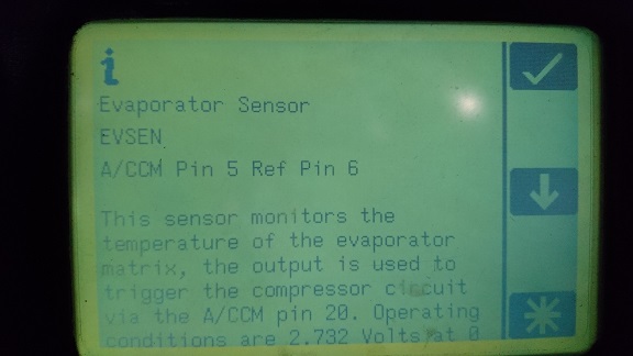

Today I was able to see all the sensors, and have made more pictures, will post them later.

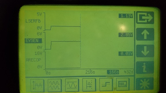

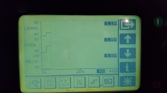

After I loaded older software to the PDU I was able to get the datalogger for the climate control to work .
Attached Thumbnails Diag connector on 1989?-dsc_1107.jpg   Diag connector on 1989?-dsc_1108.jpg   Diag connector on 1989?-dsc_1109.jpg   Diag connector on 1989?-dsc_1110.jpg   Diag connector on 1989?-dsc_1111.jpg

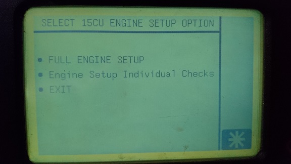

And some pictures with the PDU connected to the ECM:
Attached Thumbnails Diag connector on 1989?-dsc_1098.jpg   Diag connector on 1989?-dsc_1099.jpg   Diag connector on 1989?-dsc_1100.jpg   Diag connector on 1989?-dsc_1101.jpg   Diag connector on 1989?-dsc_1102.jpg
Diag connector on 1989?-dsc_1103.jpg   Diag connector on 1989?-dsc_1104.jpg   Diag connector on 1989?-dsc_1105.jpg   Diag connector on 1989?-dsc_1106.jpg
