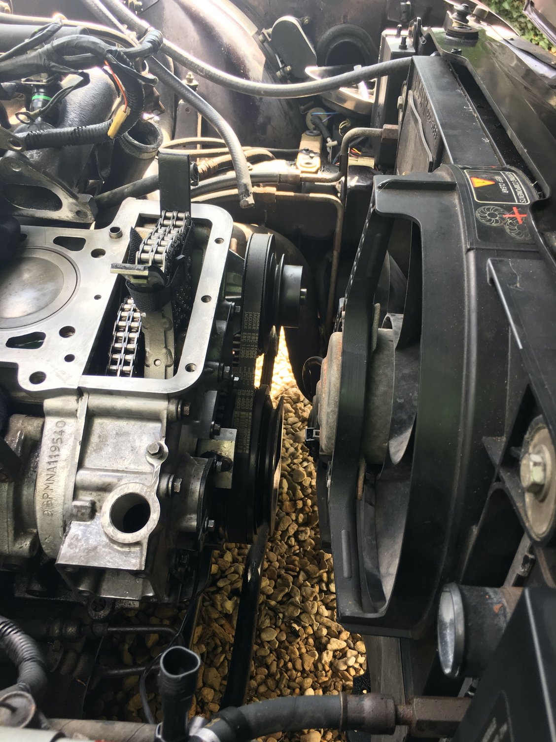

here is a pic showing my electric fans in a my94 car during my head gasket replacement works , if it looks like this then you have electric fans ?
BB
post script , as you say the fan runs on it must be electric,
so the fan cassette undoes from the two top bolts , remove the x2 fan connector supplies and the cassette pull up and out, each fan can be replaced as needed, they should be silent running, no bearing noise at all , well , it is a Jaguar.....lol , i recently had to replace one of my fans when it went noisy all of a sudden, its the bearings, the fan is used in a wide range of Jaguars , X300 and XJ8 and XK8 ( possibly X-Type as well ) , with the same setup , electrical plugs are the same as well
