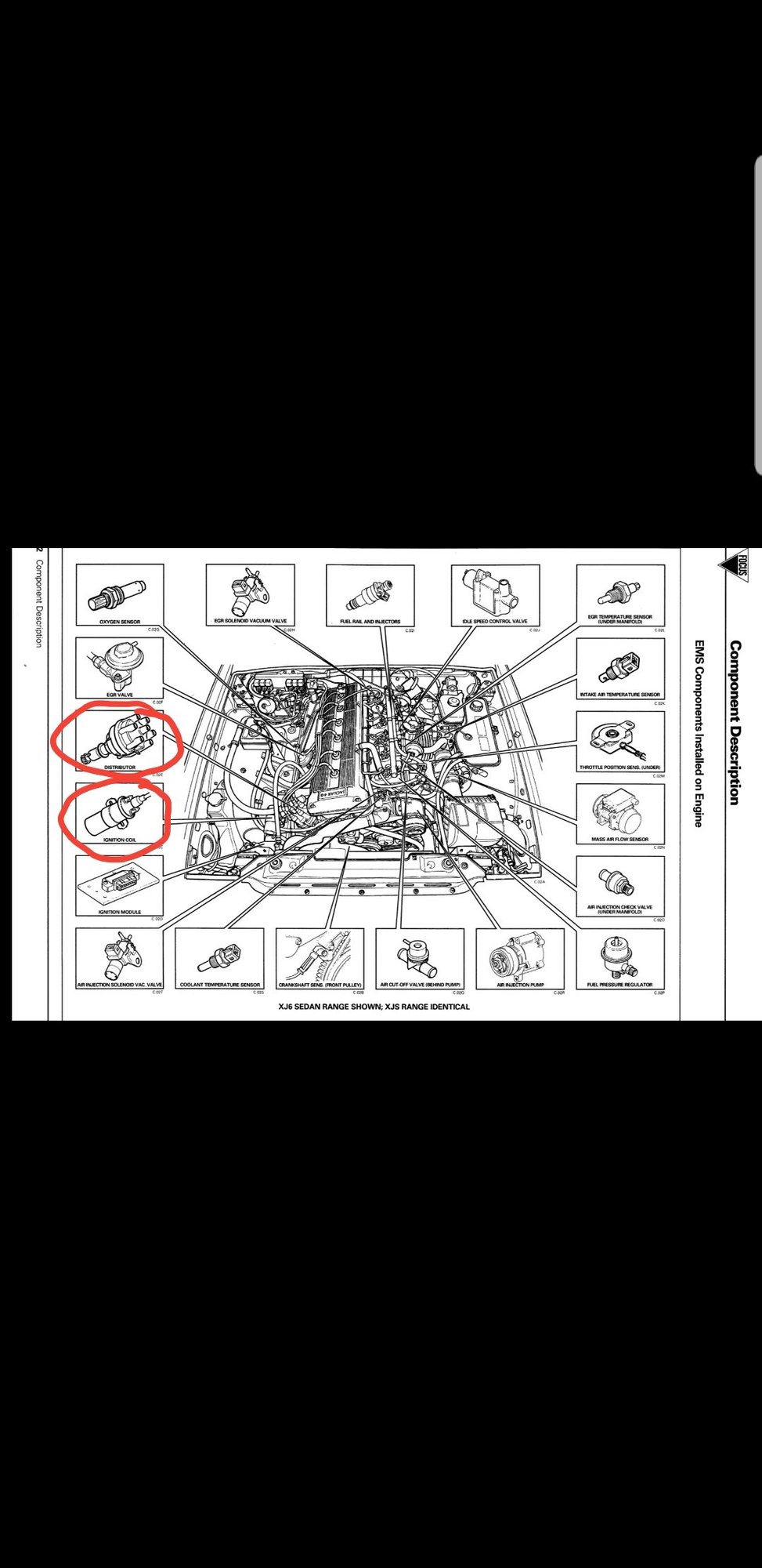

Thanks for the information. I am learning a lot from everyone here. I sprayed some starter fluid into the air intake but got no response. I felt the gas filter and can feel the gas come through. It has to be on the spark side?

If the rev counter doesn't register a few 100 rpm or so when cranking there's a good chance your crank position sensor has died ...if it does register, check the rotor and distributor cap.

After checking the fuel side I went over to the spark side and after moving the connection between the ignition coil and distributor cap the car came back to life. Thanks again for all the info and suggestions. Question now is should I be looking to replace said items (and where is best place to percur them) or should I just clean the contacts/connections?

I would just clean them and see if it happens again. How old are the cap, rotor, and spark plug wires?
