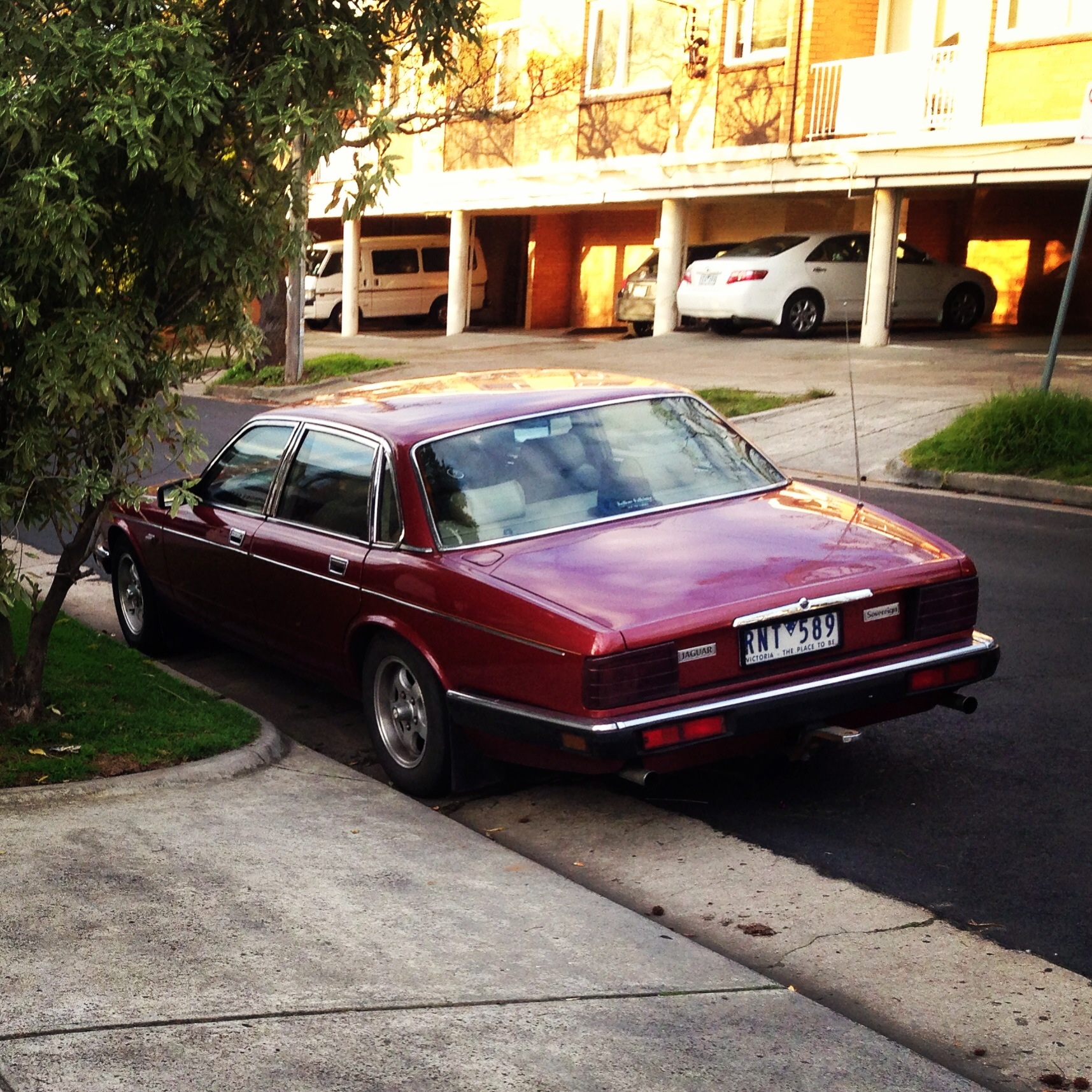

I just bought this car... Should I be regretting it
Hello everyone, I just bought a 1988 3.6 sovereign for $1100... So far so good. But it's only done around 200kms in the last 4 years, I drove it home yesterday a casual 1200kms) and it was actually pretty good, I burst a water hose which I managed to patch up, and the rubber tailshaft coupling practically disintegrated which slowed me down to about 100kmph due to the shudder, I ordered a new one today so that should be an easy fix. I also serviced the car today and changed the rear pads (as advised by the dashboard warnings), the only warning I have now is a low brake fluid warning, which I can't understand because the reservoir is full and it's not leaking out anywhere. Anyone else had this problem?
The other thing I need to sort out is the blower inside the cab, it lights up with all the other electrics but it doesn't make any sounds if I twist anything or push any buttons on it, it's not any of the fuses as I have checked those, is there a solenoid anywhere? I can't locate one and I really don't want to pull the dash apart if there's an easy fix somewhere else, anyway I hope someone can help me out, I have to go and put a towel down under the car because it leaks too much oil haha.. Here's a picture of the new toy

As I said in the intros section, welcome to the club! No, I don't think you made a mistake. Patch the car up as needed. You sound handy with a wrench. Then just drive it and enjoy it. If/when it dies beyond a reasonable chance of repair, let her go. She's already done above and beyond the call of duty compared to cars the same age.

Not really too much to regret Mark. $1100 and you drove it back from Sydney (?) Is no mean feat for an unknown. Sorry I am of no help regarding the problems. Did you say how many K's it has done?
