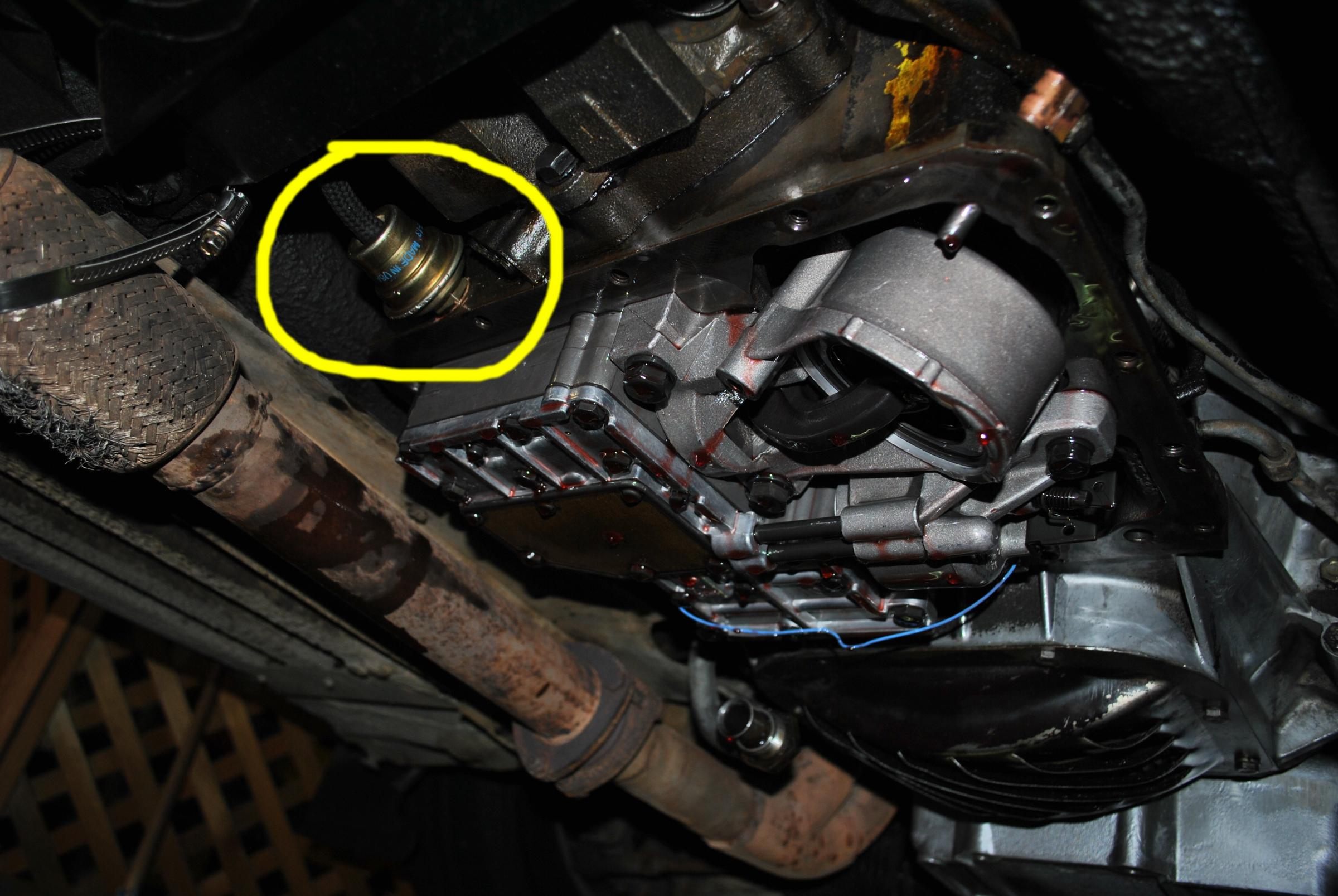

Here is a pick of the modulator on a BW12. Left rear of transmission.
Mine used 250 mls of fluid in 200 miles before I replaced it.

Awesome, thanks for the photos.
I have been meaning to get under it for a while and am in the process of making wooden blocks for my 2t workshop jack and axle stands so that I can lift and support it safely. I also have a knock from the rear suspension and a broken exhaust gasket so once I get all the blocks sorted I will do all the work at once.

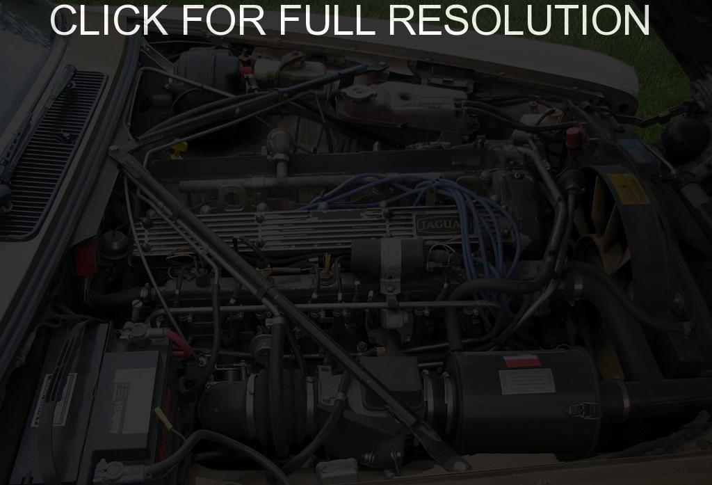

After looking at a couple of photos I see what you mean about the two different caps - my car only has one cap on the reservoir and no other caps, like below, so there are no other places to check.
Here is the link, uploading from that site doesn't seem to work: http://www.moibibiki.com/images/jaguar-xj-engine-8.jpg
