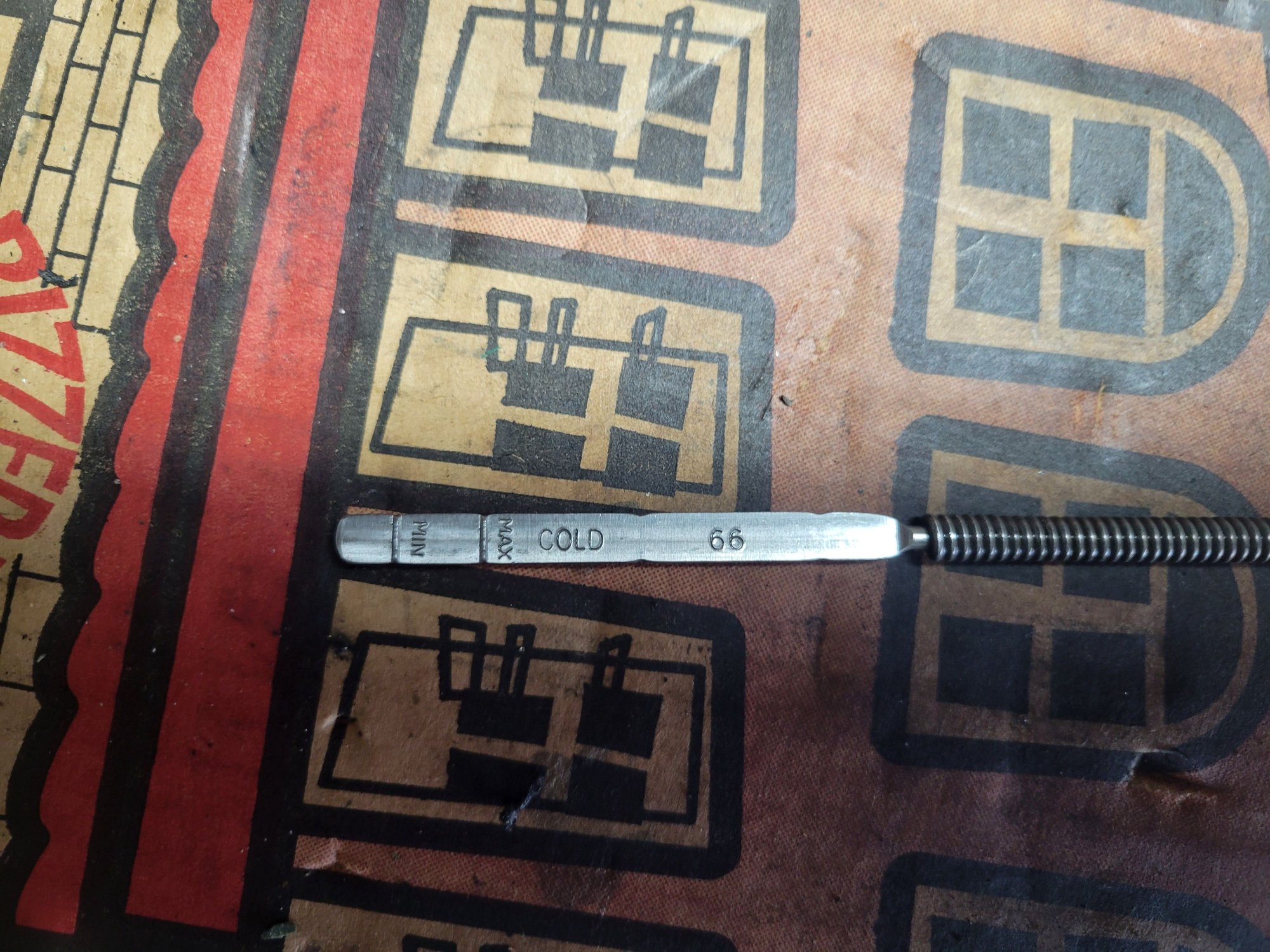

Any ideas as to why after driving my BW66 transmission dip stick would be pushed out like this. Obviously from some pressure, but what would cause that? I know what blows out an oil sump dip stick, but am at a loss for transmission? I'm not driving her hard. And the fluid level seems to be okay when checked according to procedure.

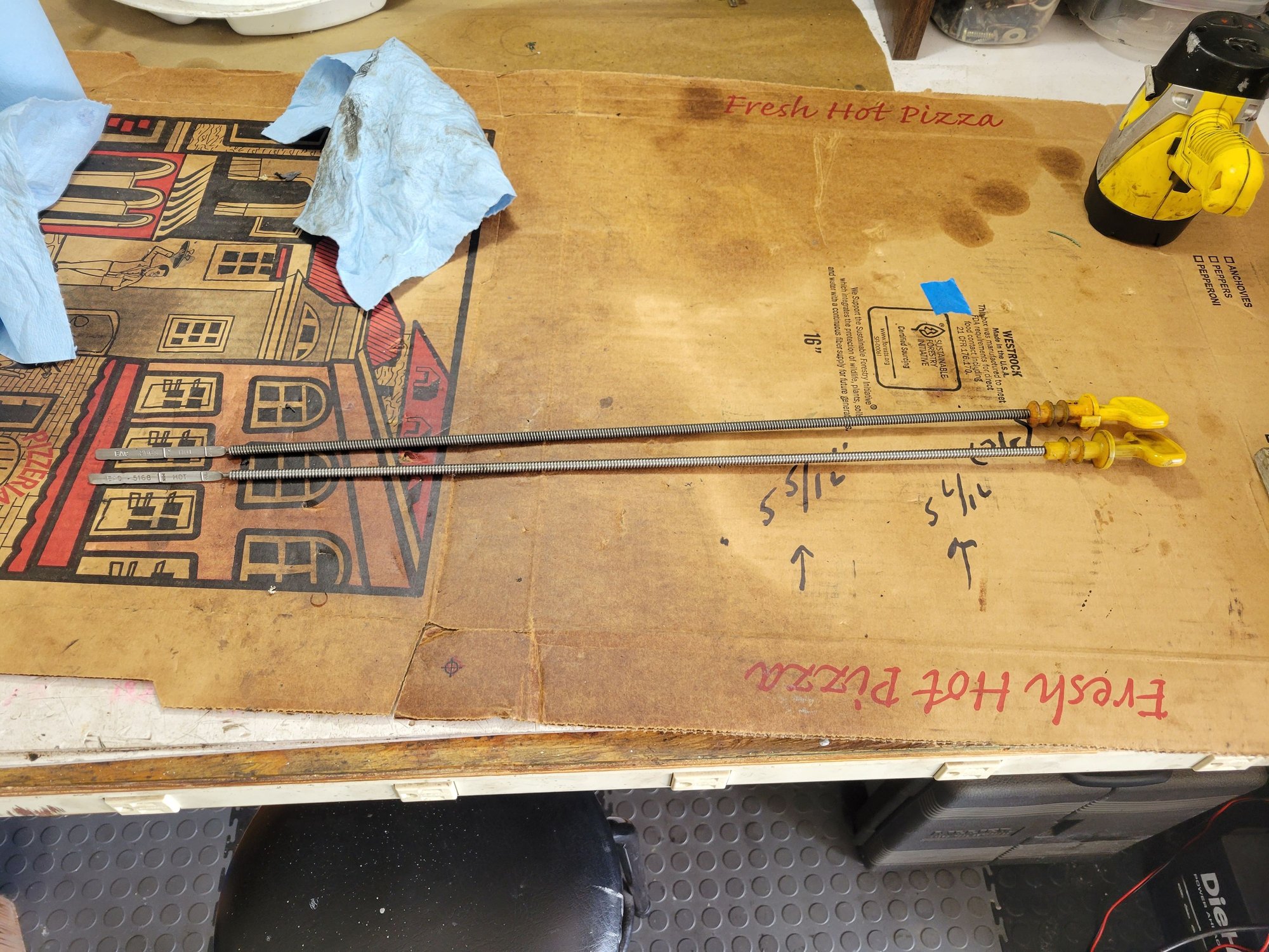

Bill, I think the dipstick in the picture is a BW65 dipstick, not BW66.

Jose - I believe the 66 on this dipstick means BW66?

Jose - No. EAC 2963. But when I lay the EAC 5168 down side-by-side, they both look the same. This is still the BW66 I got with the car that's pushing the dip stick out; not the one I got from you. I haven't given up troubleshooting my BW66 yet. Before tackling the one I got from you. And the dip stick tubes both look exactly the same shape and length. Thoughts?

the 5168 looks longer to me. Could that be the issue ?

Only in the picture. Not in real life.

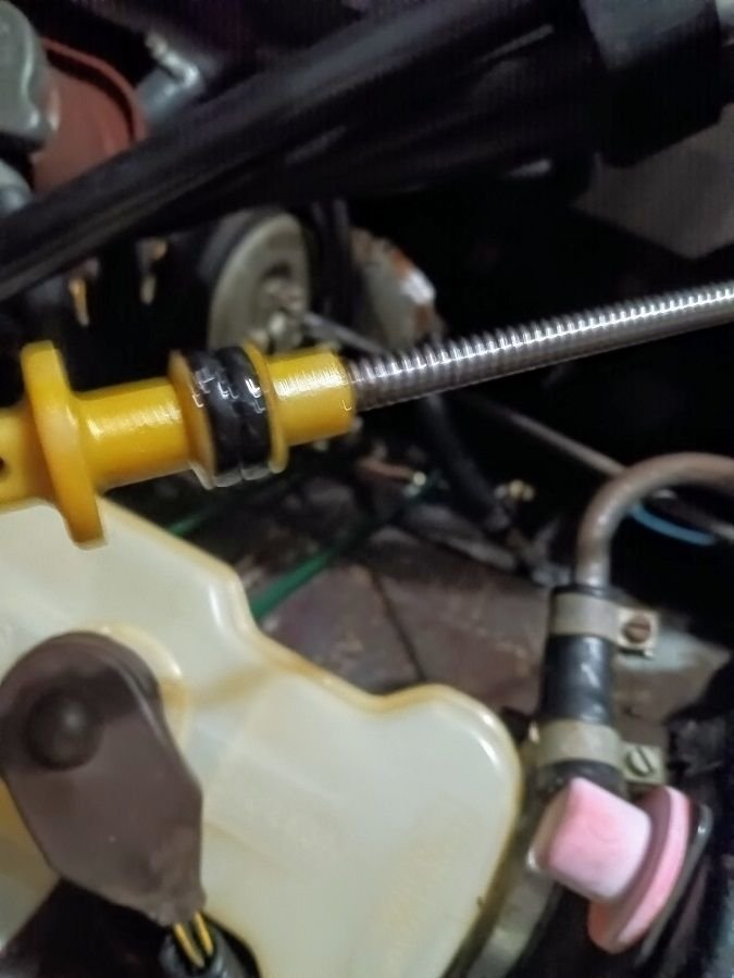

does the yellow top have the two o rings that go into the tube sort of tight ?

No "O" rings and I don't see any in the parts manual? Only a seal ring at the top, and it does have that.

Bill, the plastic top of the dipstick has twin o rings which go tightly into the tube and keep it in place. Looks like you are missing two o rings in your posting image:

Aha! Don't see them in the parts manual, but I've got a big assortment of "O" rings. I'm sure I can find some that fit. Thanks, Jose.

Bill you're welcome. the o rings are fat and extend slightly over the two plastic "stops" of the dipstick. They also touch tight to each other, kind of an "interference" fit. Just look at my picture for reference.
