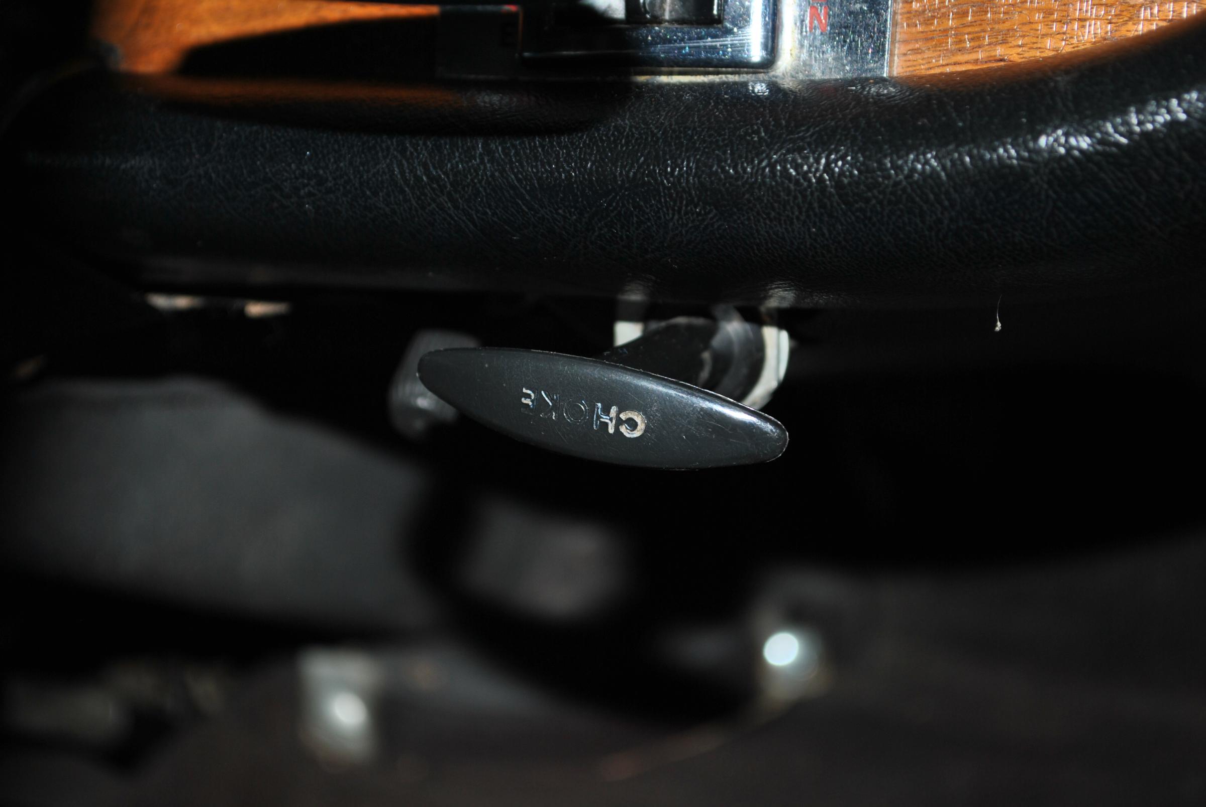

I have purchased a manual choke kit from SU in Sydney, and was looking for ideas where to place the knob, keeping with the classy Jag dash, I am looking for the E type lever but not much luck so far. All of the knob location I have seen on the web r quite ugly

Mine is just under the dash to the right of the steering column, and I just realised it is up side down.

Upside down to us, but right way up for the "northerners".
Also based on how much of whatever you have been drinking.

You have a series 1 jag, I like this style dash because it's similar to the E type config.
My cable just has a black round knob on the end no writing, very exciting-not.
If you don't mind me asking where did you buy your choke cable from please
