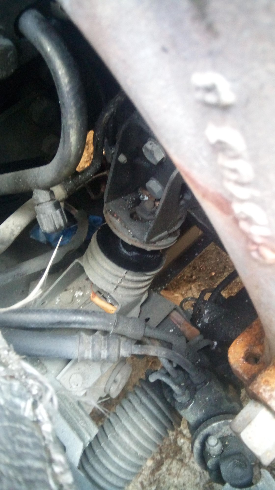

Old May 20, 2018 | 01:22 AM
o1xjr's Avatar
Posts: 28,386
Likes: 6,340
2 ton work perfect, $15 at the local parts shop.
