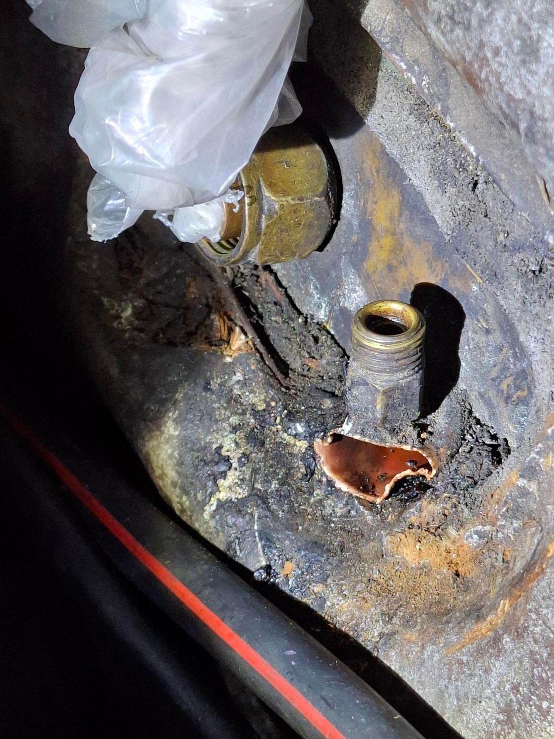

It also got worse recently, so I took the car to a local A/C technician to see what he could do. He found that the gas was low so kept the car in to trace the leak. Next day I got a call saying he had hit a snag and could I come to look. It turned out that, when removing one of the hoses at the bulkhead to the evaporator, one of the unions had twisted off.

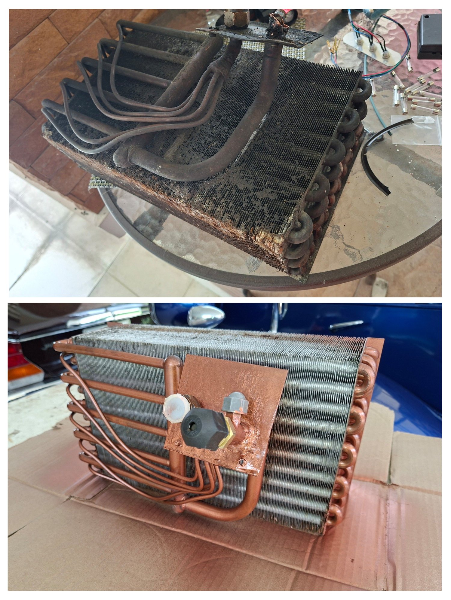

Once I had the evaporator unit out of the car, I could see that it was badly choked up with dust etc, so the job was going to be a worthwhile exercise as it couln't have been working very efficiently. I took it to the AC tech who had a new union brazed on and cleaned it all up thoroughly.

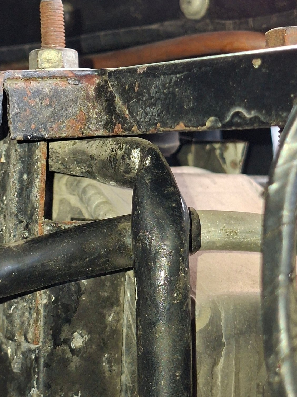

After I got it all reassembled, the AC man re-plumbed and re-gassed it. However, it was not noticably any better than it had been originally. On carrying out further checks, I noticed that one of the tubes of the condenser was badly kinked, probably causing a restriction to flow.

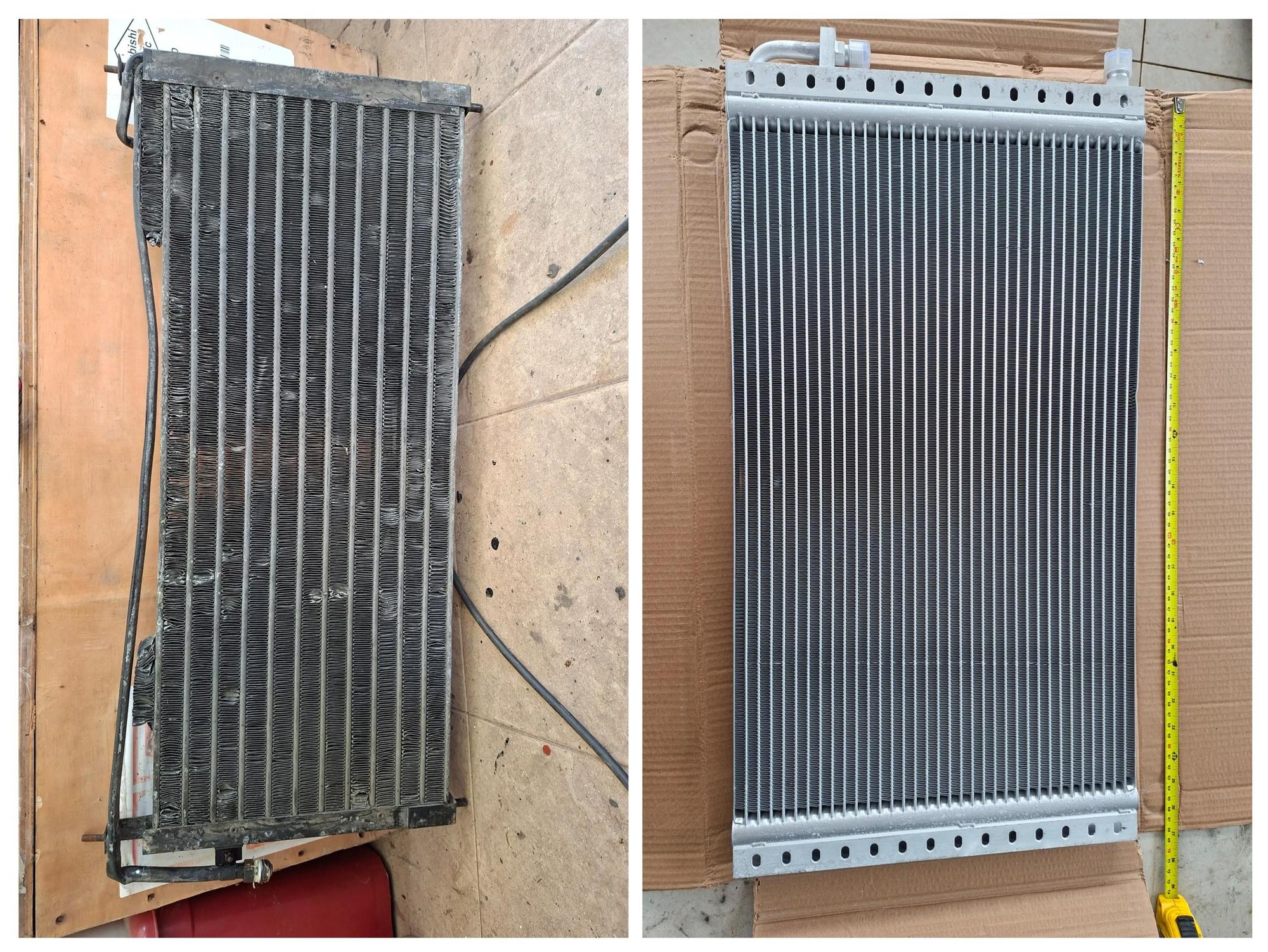

The condenser looked pretty old and past its best, so I decided to replace it with a new one available locally. The original was 13" x 28" and the new replacement was 14" x 26". I had to make new mounting brackets, but other than that, it was fairly straightforward to fit.
Then the car went back to the AC workshop again. He had to change some hoses as the fittings on the old and new condensers were different. The new condenser is the modern parallel flow type which I read is around 25% more efficient than the old serpentine type.

Excellent work! Yes, changing the condenser to a more modern style will make a big difference, as you have noticed. Being able to get rid of the heat is a major upgrade to the system.
I was cringing as soon as you said the pipe twisted off, I was expecting that. Great care has to be taken to remove those hoses and the expansion valve.

Indeed, you have to get a spanner on the valve, which has flats cast into it for the purpose, so as to counter the torque when undoing the nut.

Changing the condenser was relatively straightforward - just a case of removing the radiator closing panel and A/C hoses, although I had to make new mounting brackets as the new condenser is an inch taller than the old one. When looking for a suitable one to buy, I noticed all the generic condensers advertised are sized in inches, not metric. Must be another of those automotive things like brake cylinders that have stuck with imperial sizes when most other things have gone metric.
