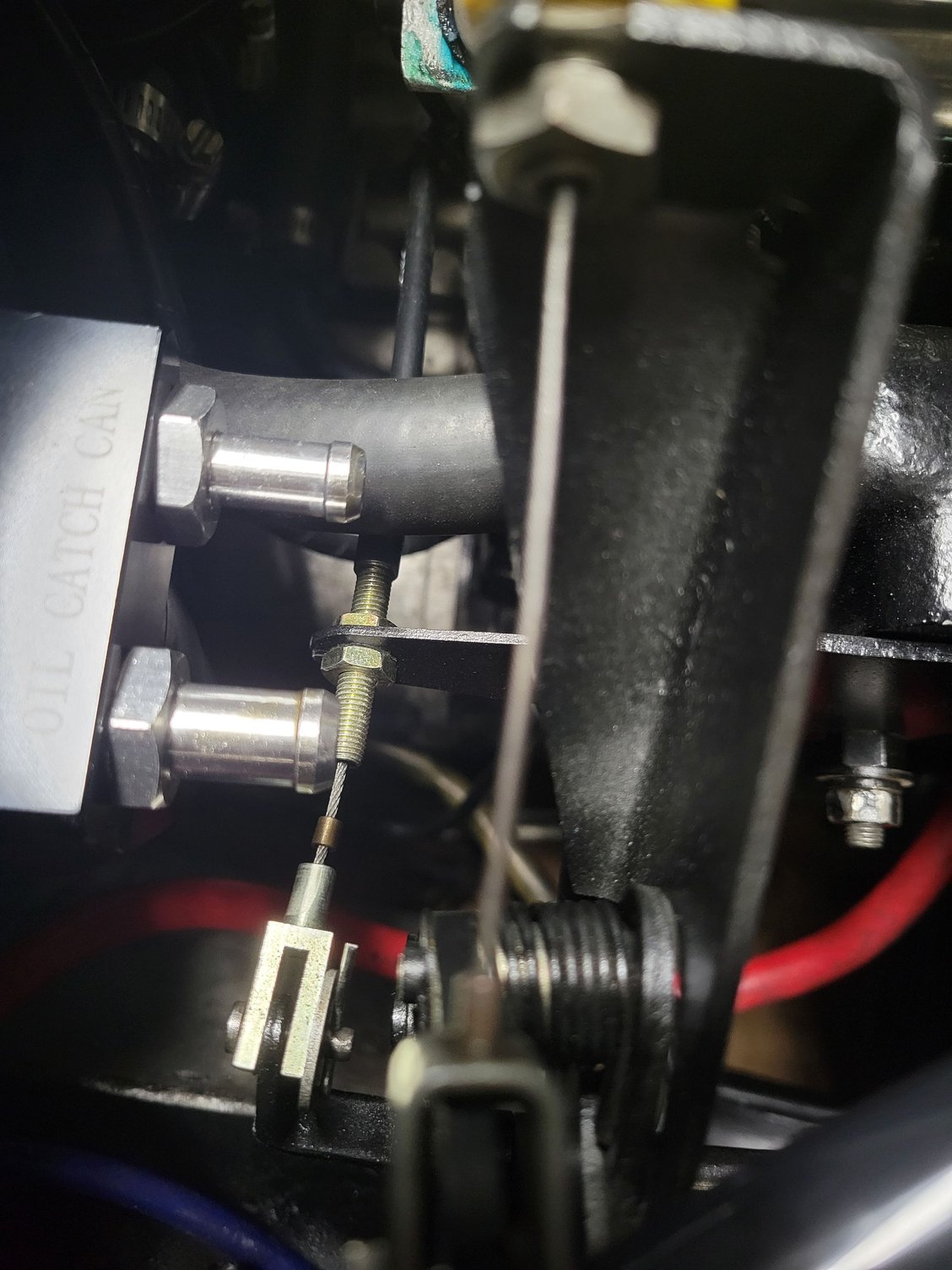

Adjustment inside transmission
Adjustment outside transmission, inside engine compartment

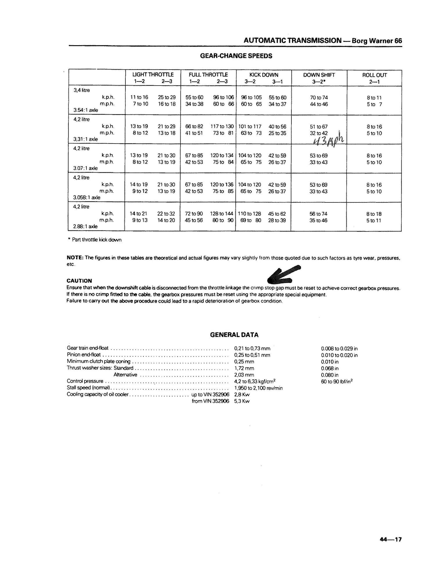

Gear-shift change speeds

The kickdown wire is broken or torn off and I need to do a magic or weld it back and that the reason I want to remove that cable assy.

Your pics look totally different from mine! Not sure what you have.
mine is on/from a series 3, how about yours?

The S2 would have a 65 gearbox, with similar cable operation, but as it has carbs, it pulls from the linkage, whereas the S3's 66's pull from the throttle.
