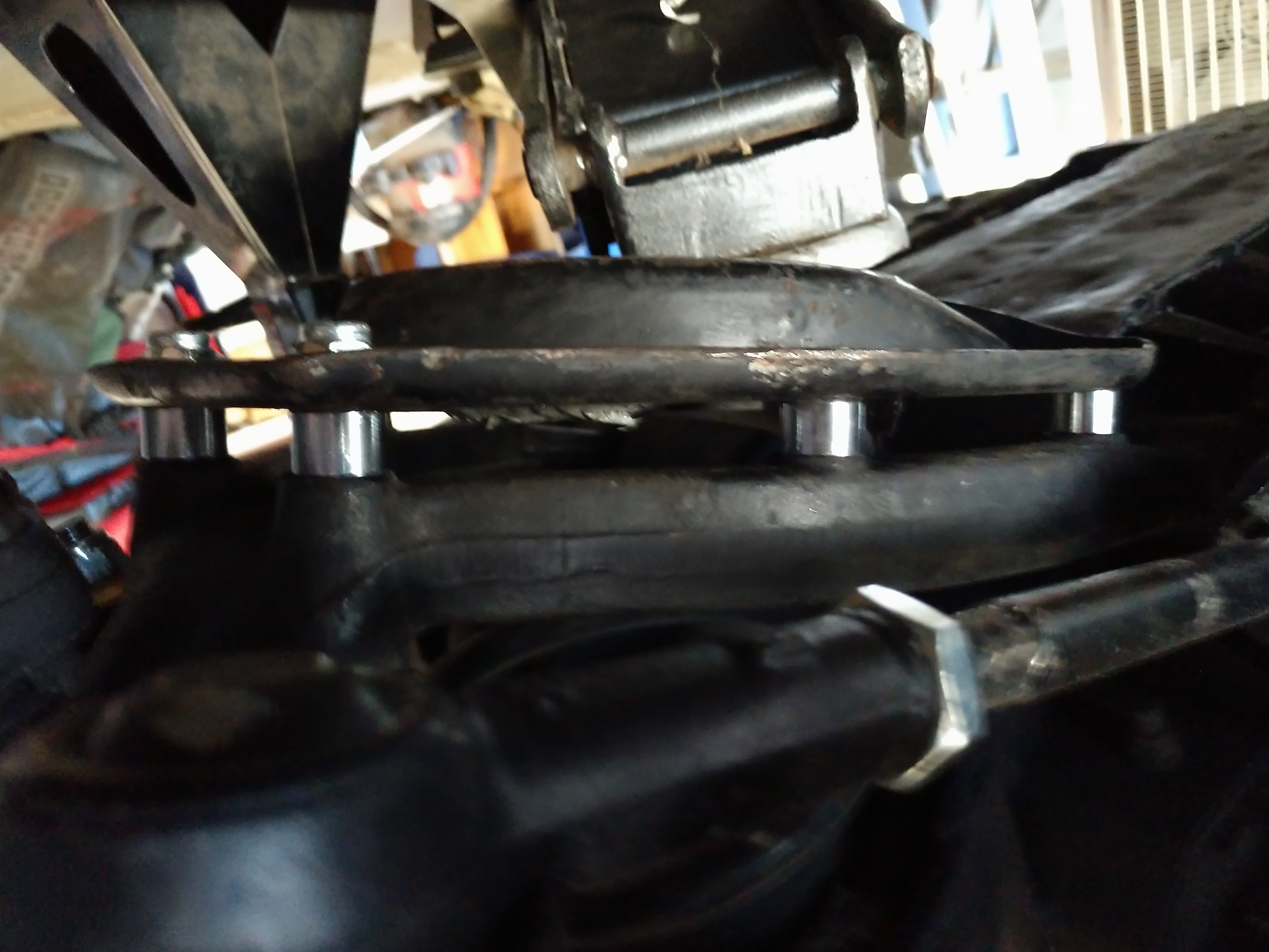

On Series III XJ6, you dont need to cut the spring to lower the suspension. The spring bucket on the lower control arm unbolts from the A-arm. You get longer bolts and make spacers or use washers to create a gap between the spring bucket and lower arm. I not certain that series I & II are the same but I would bet they are. Someone else on the forum can possibly verify.

They are and I've used that method on my ser 2 also, but I wouldn't recommend a deep drop this way unless some method of strengthening that connection is made.

30 minute Job if you have the spacers and longer bolts on hand. The bolts need to be 3/8-24 grade 8. The 2 longer bolts that hold the lower stock mounting bracket are a bit of a pain.
