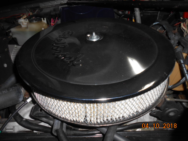

Presently, I am running the car with an Edelbrock open air filter meaning that I am pulling hot air from the engine compartment.
While I ponder whether I should go to the next step and replace the present engine with one with TPI, Is there an air horn that I can purchase to fit the Throttle Body Unit? I would like to pull cool outside air into the system.
Space is limited and the Edelbrock Air filter I am using is 14" diameter and 3" thick. Will post a pic of the Air Cleaner when I get to the car.
Any info will be greatly appreciated.

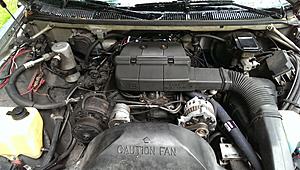

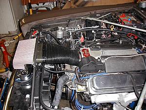

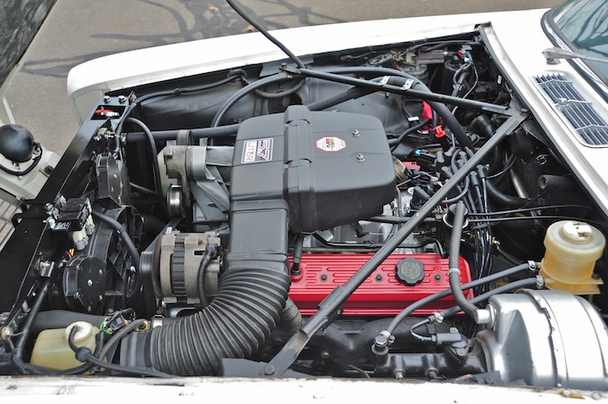

Hey ,.. This is what I am using on my 350 TBI.
Its from a 90's Caprice with TBI. This is not my car in pic. I simply could not find a pic of my cars engine compartment with the air filter in place. got some... just can't find them at the moment.
As usual you have to do a bit of creative snorkel cutting,.. Mine gets its cool air down low just in back of the radiator support member.
I get good low temps in engine compartment with the functioning louvers - air gets sucked out and cool air is pulled in in back of rad. I think the cooling fan also pushes air out of the louvers ... can notice difference in air flow coming out of louvers , with fan on / fan off. Anyway the snorkel portion has a heat vent to help with cold start ups

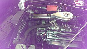

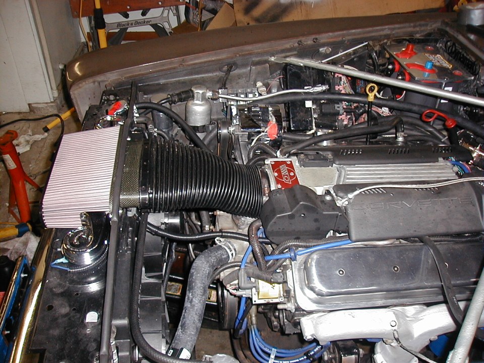

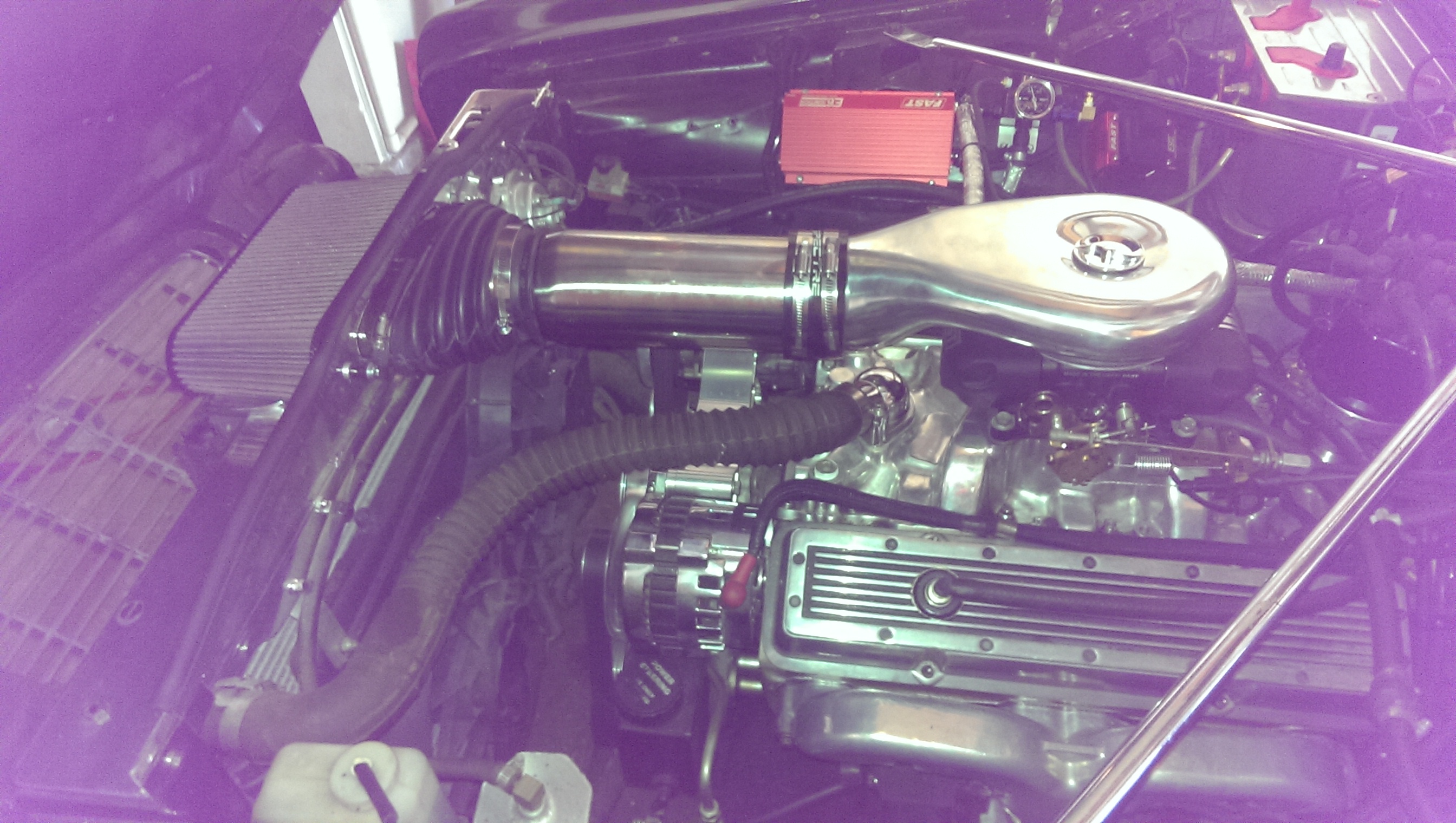

This is my air cleaner setup that brings in cold air..custom made by a fellow Jag owner, will share the info if you are interested.
I made up the new TB hat and coupling.. the air cleaner is a K&N and fits in a carbon fiber adapter in the upright support..my
car is now converted with EZ-EFI 2.0 and like yours, was a big improvement over the well sorted carb. Can start is with the just
turning the key - no throttle needed at all.
I used this air cleaner arrangement on the other S1 with LT1/700R as well, as it adapts well to a carb or TB.
Bringing in the outside air lets the engine use air that is 40+ degrees cooler when driving.
