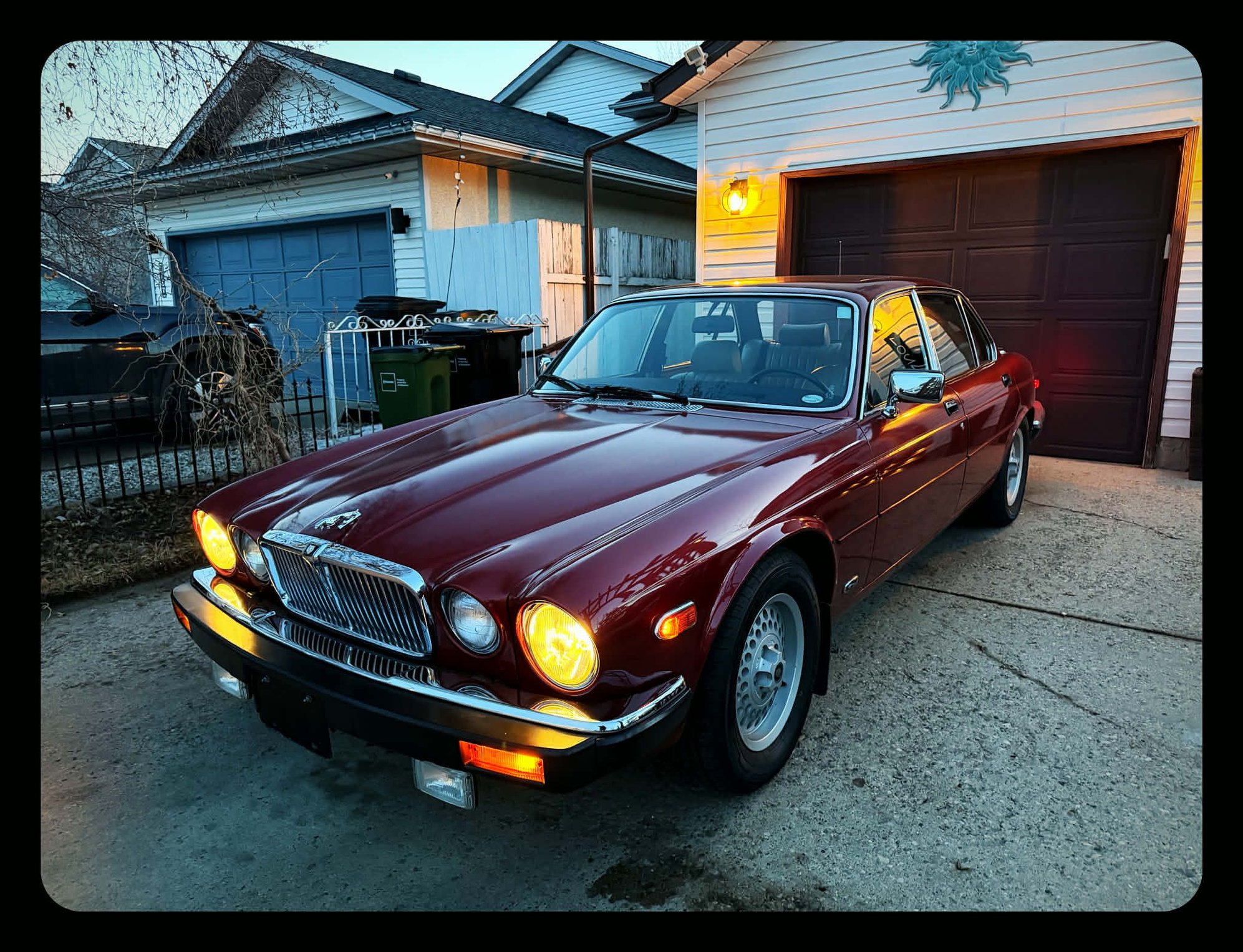

Finally got her home this week

Beautiful addition to Edmonton’s streets!
It looks like I’ll have to up my detailing skills to keep up.

It looks beautiful and, yes, this was my car. It took us on many memorable trips and we never experienced any issues, either mechanical or electrical. It was one of my favourite Series III cars. You can still see the Jaguar Car Club of Victoria sticker on the windscreen.
I bought this car in Victoria, being sold because the driver’s seat electrical connection had been lost. The seat was tilted at a very awkward angle and apparently no one knew how to fix it. I did. The ground point was faulty. A super easy fix that restored the electrical integrity…the problem disappeared, never to come again.
And to the new owner: I never received a message from you. No idea why, my apologies.
A fun fact: the Sovereign seats look to be the same as those in the XJ6. They are not. Both the front and rear seats in the Sovereign have shorter seat bases than those of the XJ6, and the leather covers for the seat bottoms are therefore not interchangeable with those of the XJ6. The reason for this? Well, British life is full of quirky things…my guess is that the shorter seat base provided very slightly more legroom or at least, the appearance of more legroom.
The wood trim was nicer than that of the XJ6, but did not reach the quality of the VDP wood. Mechanically they were identical. And the Sovereign badge is nice!
