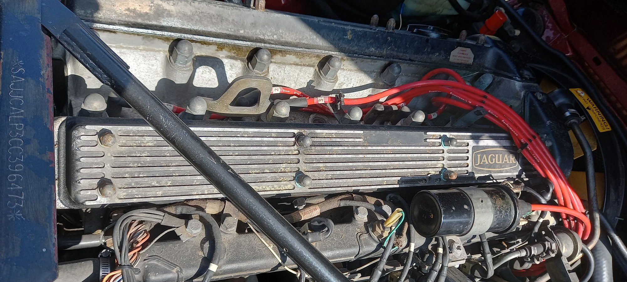

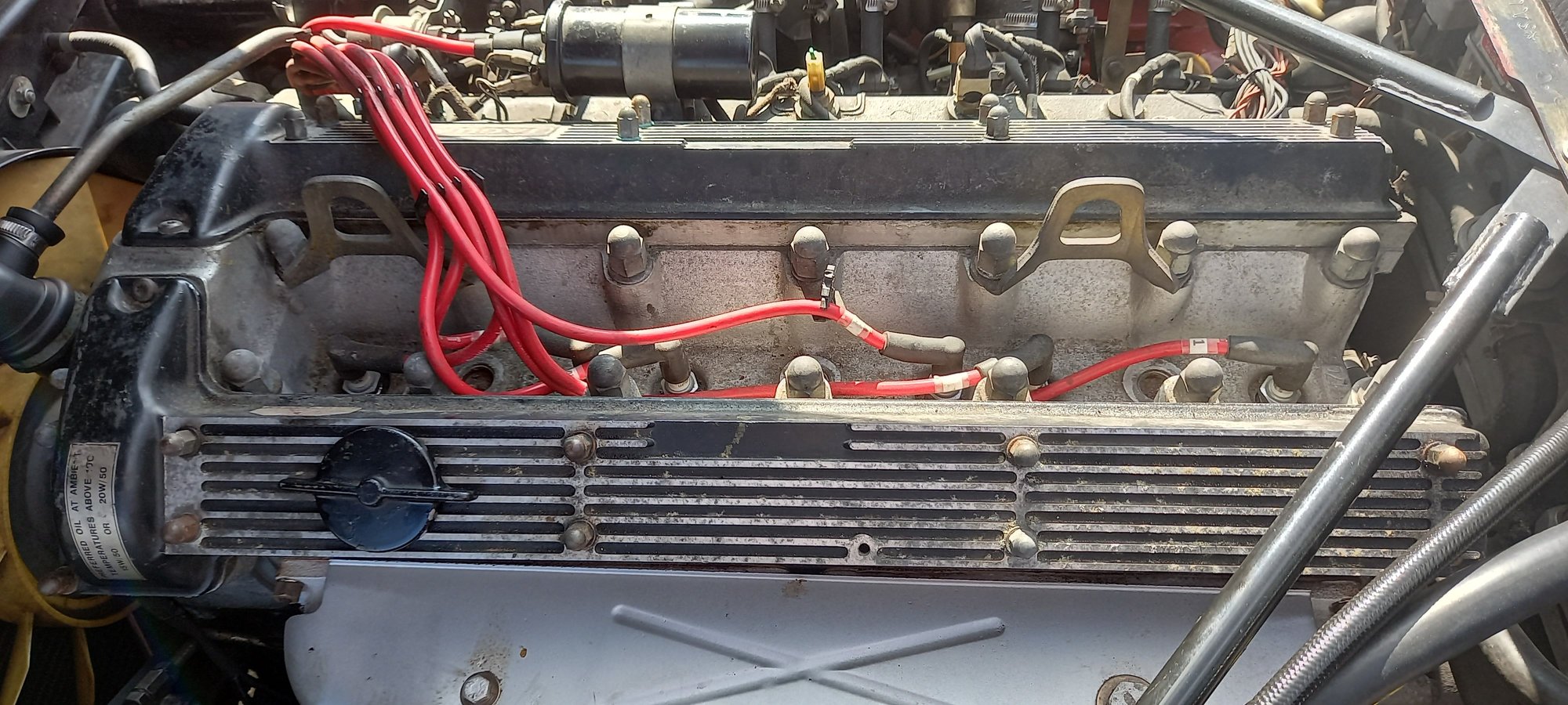

Greetings all. I have a small oil leak from the rear of one of my camshaft covers. So it's an easy job to replace the gaskets I assume. (Provided the old ones have not been stuck in place with silicon or such like!)
I thought that it would be good to repaint them and the filler plug. I would love to have your opinions on either painting or black powder coating. I will be fitting a new set of chrome plated acorn nuts and copper washers.
Once painted or powder coated I will need to sand down the tops to expose the metal tops of the grooves.
I will also buy a new Jaguar emblem and try to polish up the large acorn nuts holding the cylinder head down.
I would be grateful for any ideas and suggestions.

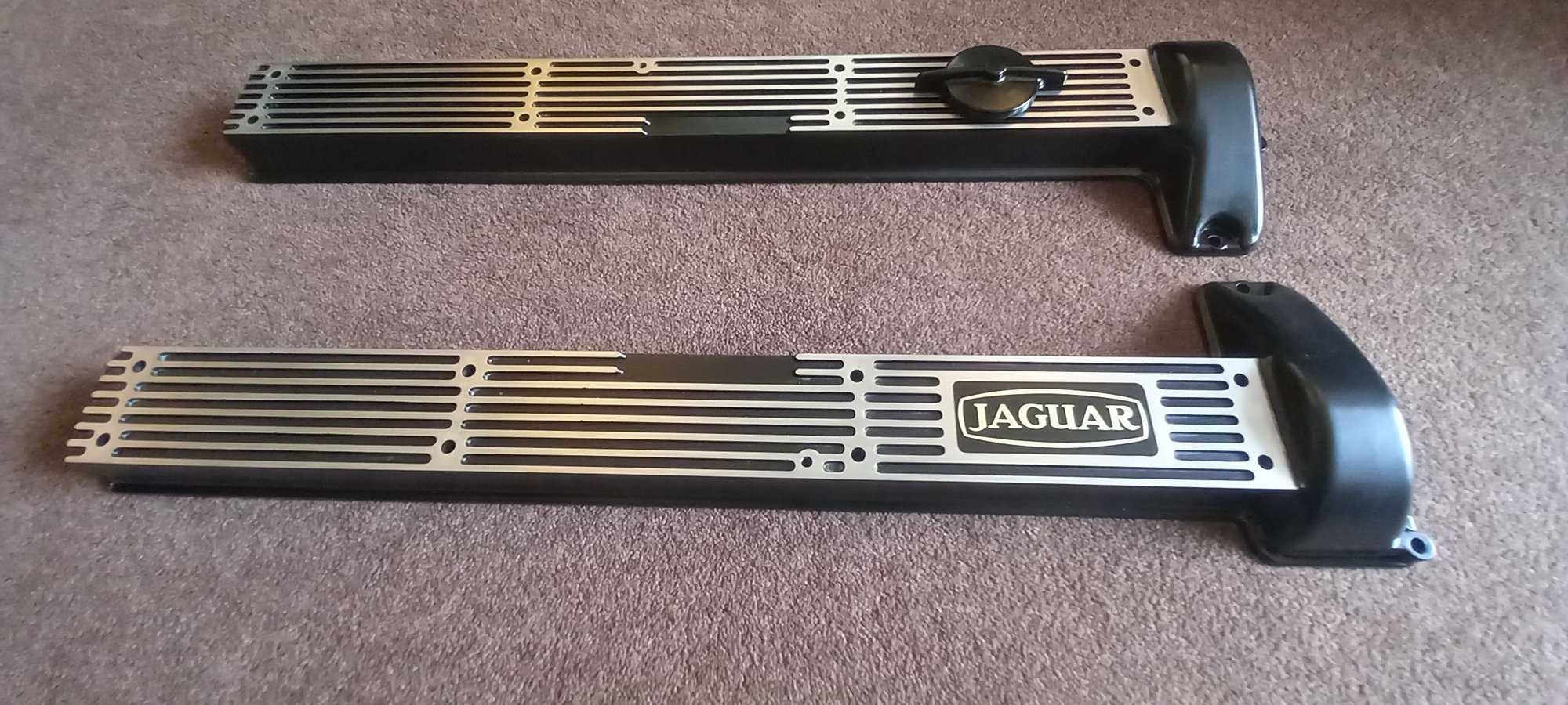

I'm very happy with my covers and will fit them soon
All new copper washers and chrome acorn nuts are ready for the reassembly. Thank you to all who offetred advice. Danny.

Those refurbed cam covers look fabulous, just like factory production !
