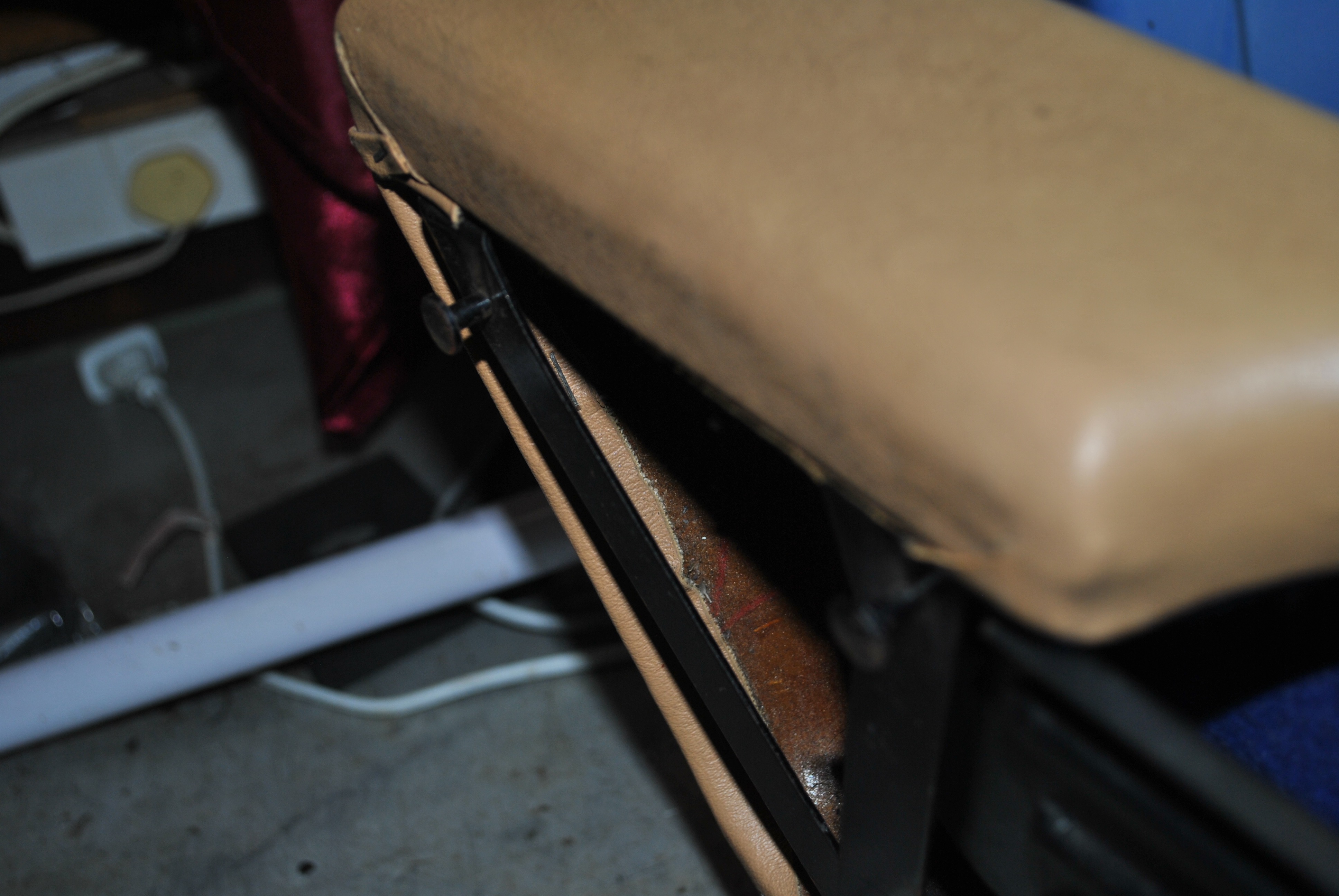

Once you remove the screws from the pocket ,tap it upwards as it has pins that go into slotted holes, I know I removed a series 3 pair today to fit to my series 1.
And remove your window winder handle(make sure the window is up first so it doesn't block the locking mechanism.
