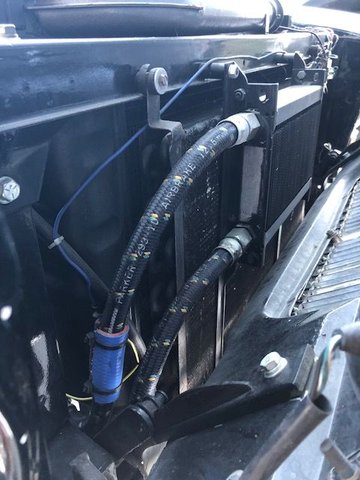

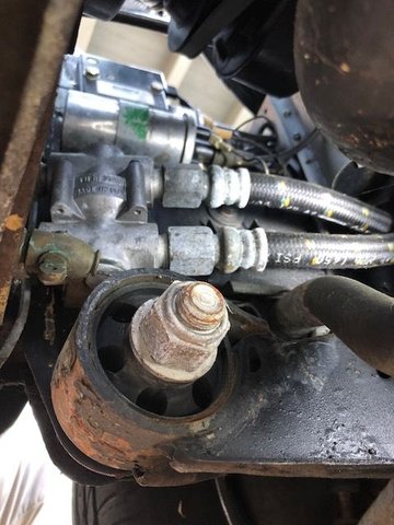

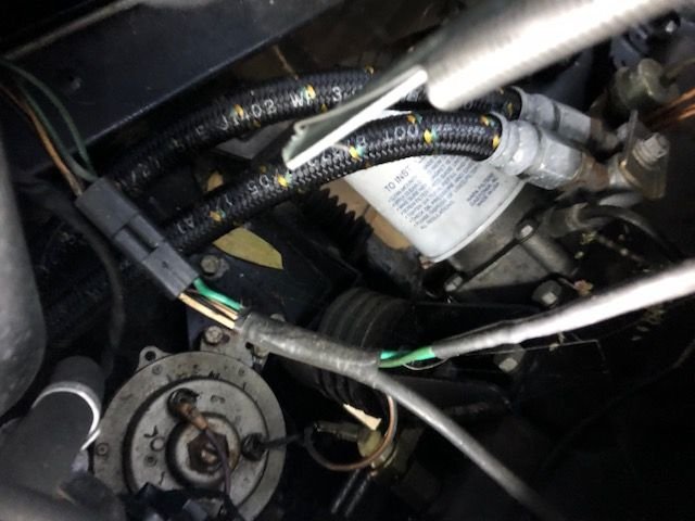

The Series III setup will likely give you the best results for the least work. It might fit using all the stock bits. I have the SIII setup on my '72 XJ6. I could not use the stock SIII pipe/hoses and cooler because they position the cooler where my car has limited room due to thicker radiator. I had to locate a cooler behind the grille and use hoses instead. I took the opportunity to install a Mocal Oil Thermostat to limit flow until fluid is warm.
