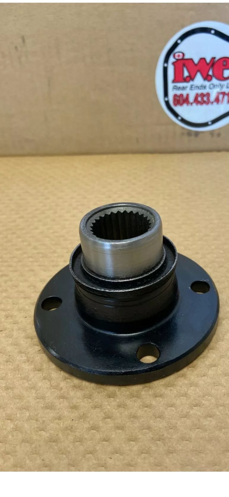

You can use standard dana ring/pinion, I would just swap the gears with what you have.
all you need is the gears(make sure you get a ring gear that is dual drilled) and the adapter flange(the factory Jag flange is unique).
i bought a flange when I was re-gearing my car as my original intention was to swap from Dana to Salisbury/GKN.
in the end i kept the Dana and installed 3.73 gears (gave away the 2.88 powerlock).
i still have the brand new flange if you are interested.

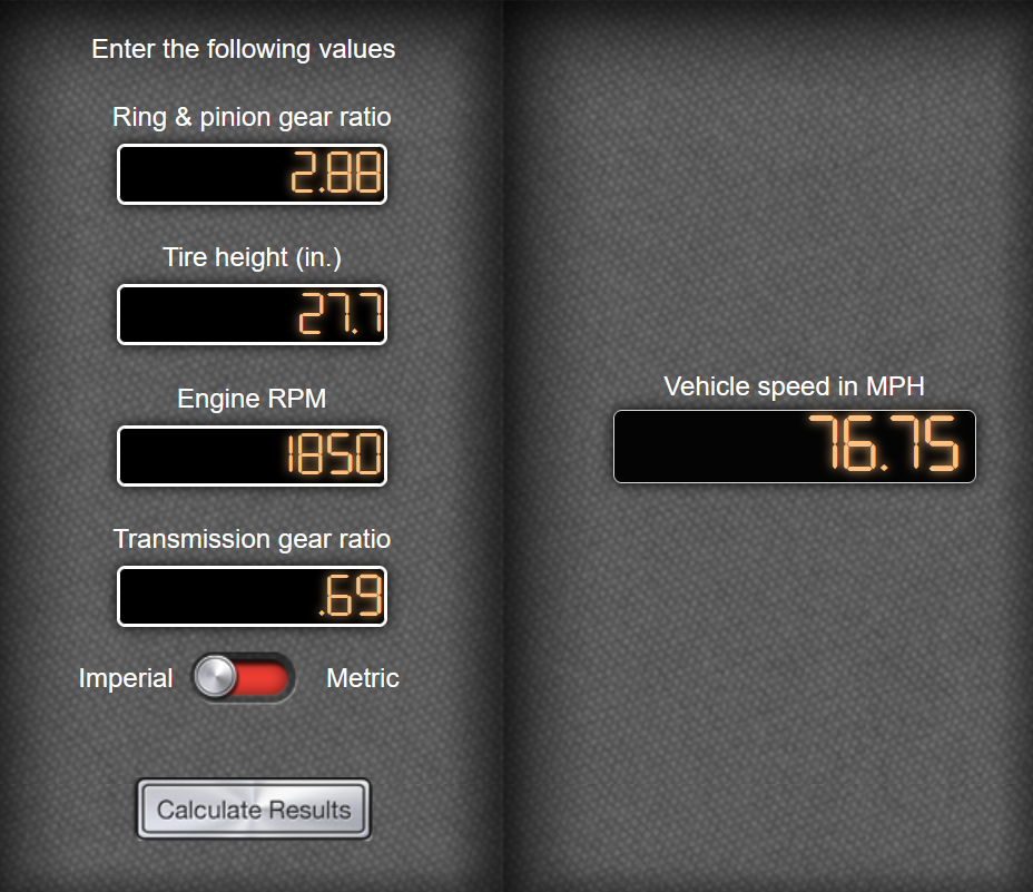

I took a step back and opened up Spicer's gear ratio calculator to put some quantitative data around this. My current combination with 215/75-15 tires, the 3.31 diff, and the .69 4th gear ratio of the 4L60e comes out to 2,125 rpms @ approx 77mph which is my normal highway cruising speed. 2,125 rpms is about what I see when I am driving.
If I changed from the 3.31 to a 2.88 rear diff, at the same 77 mph (ish) the engine would be turning 1,850 rpms. This would be at the expense of acceleration which is about 6 seconds 0-60 on the 3.31 diff.

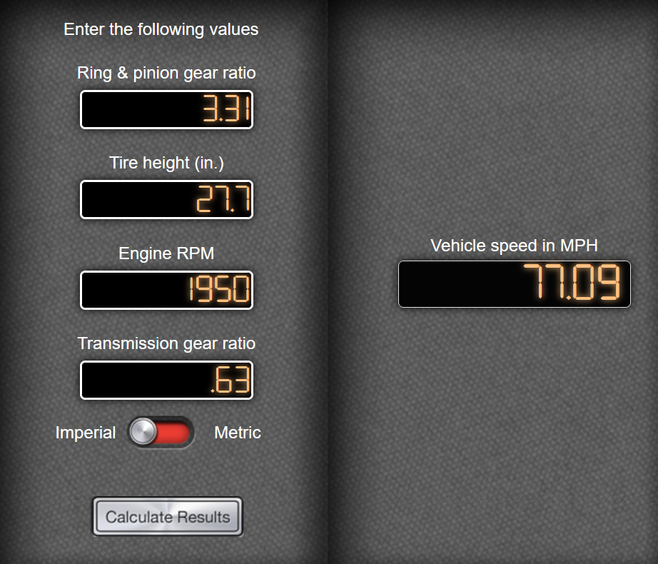

If I kept the 3.31 diff and changed the transmission to a T56 with the .63 6th gear, 77 mph (ish) would be at 1,950 rpms.

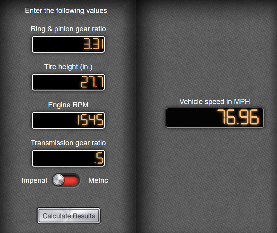

Keeping the 3.31 and going to a T56 with a .5 ratio 6th gear gives me 1,545 rpms at 77 mph (ish)

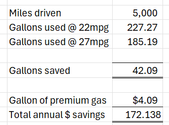

Furthermore, let's assume that I drive the car 5,000 miles a year and any of the above options improve fuel economy from 22mpg to 27 mpg. I think 22mpg is what I was averaging last year. We'll also assume $4.09 for a gallon of premium gas which is what I paid last night.
Continuing the financial analysis, assume changing the diff would cost $600 and a T56 swap would cost $4,000 to $6,000. The $200/year in fuel I would be saving IF these changes netted me a 5mpg increase in small and would result in a pay-off period that ranged from 3 years to when I retired.
In conclusion, there is no sound financial basis to seek an increase in mpg and if I were to attempt anything it should be the one that would be the most fun.
