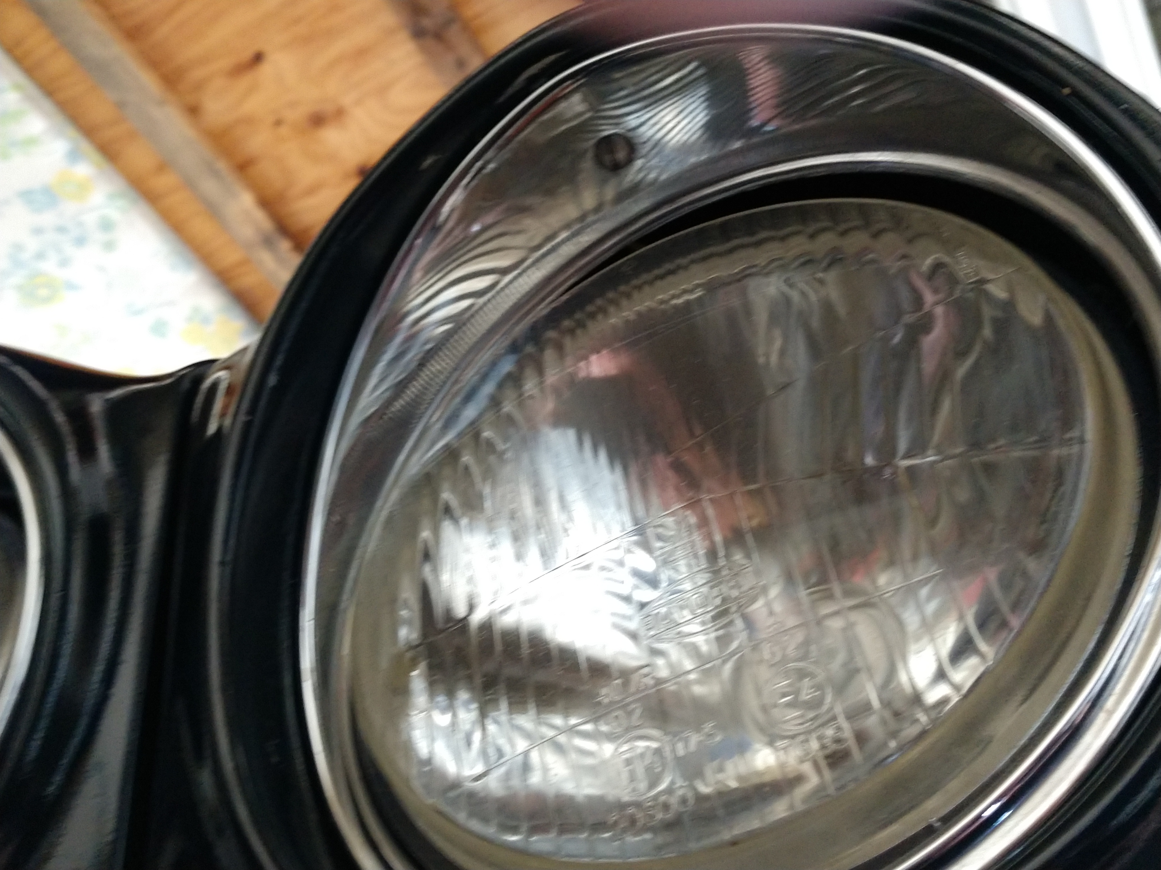

I put on new 7" headlight rings today with vents from Jaguar Specialties new stock.. can now feel air flow around 40 mph on the drivers side...have not gone faster yet.. really do not care but wanted to know for sure.
Wonder what my old rings fit (see last photo)??? They are seven inch with no vents? Maybe non USA cars? Will have them for sale SOON!

Some Jags must not have the side vents.. therefore, they would be fine for those cars.
