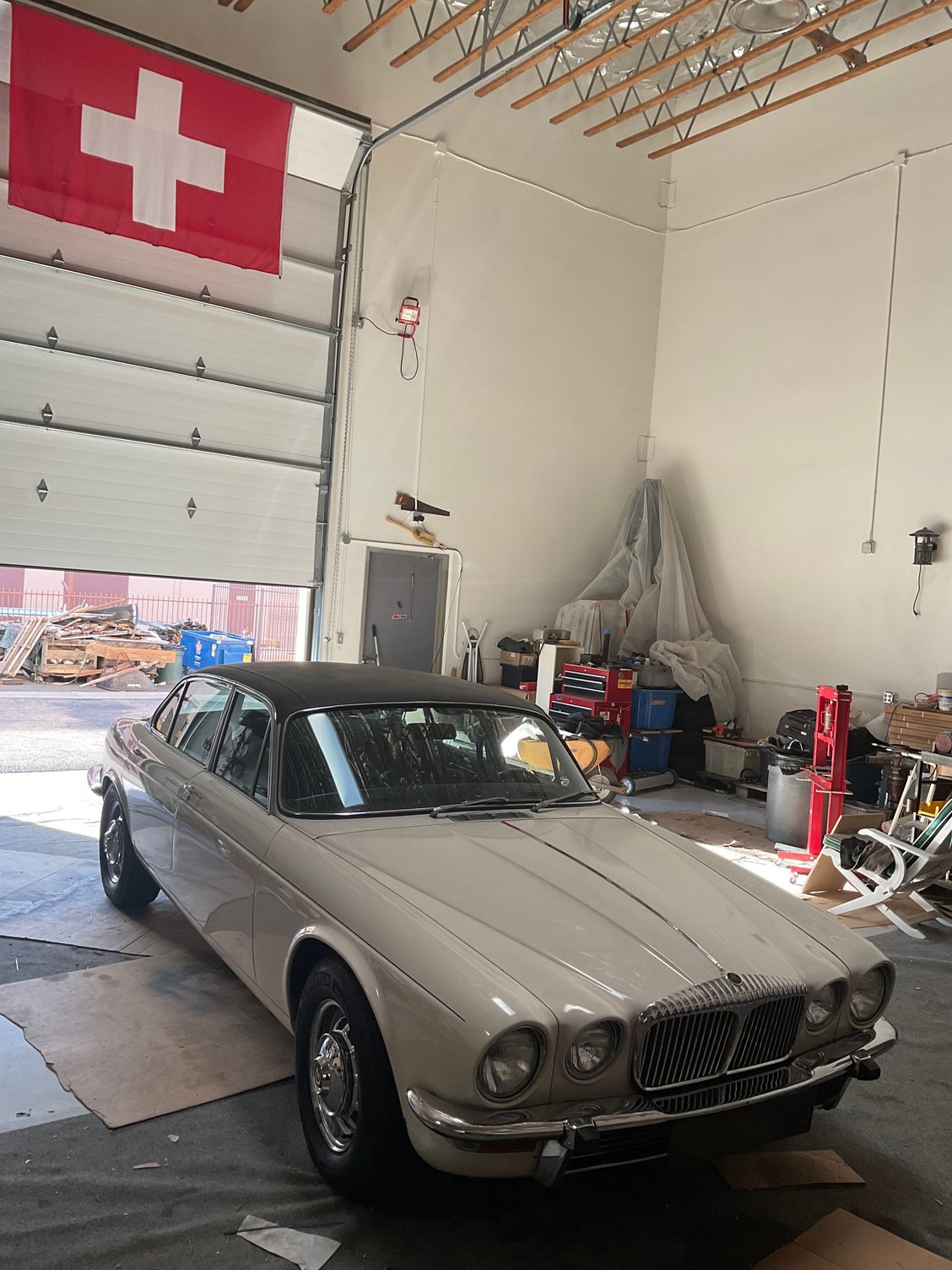

Not familiar with V12s. I know that all the cars I have owned (mostly v8,and a boxer12 bb512, a Pratt r2800 dc-6 engine r18) I can start it and it takes a while to get warm. You can still almost touch them after driving.
i recently purchased a Daimler Double Six and it gets incredibly HOT even after just 2 minutes! Is that how they are or is there something that needs investigating? I plan on installing 2 temp gauges (one on each side) to see if they get the same readings…. The dash gauge stayed Cold. Only idled it 4 minutes and i can’t even touch it !!!!

thanks. Beautiful car. 99% original Swiss delivery (Geneve)
so I touch the top of the cylinder (not the exhaust manifold) (near the logo)
the driver side untouchable after 1 minute of idling from cold.
passenger side touchable warm to hot. Not like the driver side..
coolant is present. I removed a hose and it’s there. On both sides.
43k km
