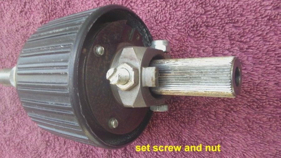

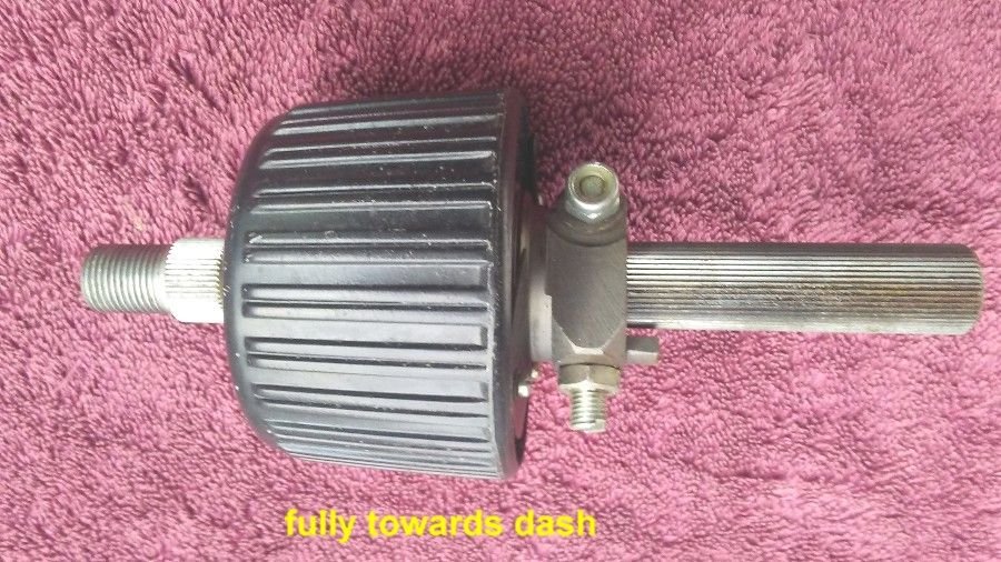

I will post pictures of a complete telescoping section I removed from another car, later.

here are pictures of the assembly, it really is a very easy assembly to remove.
