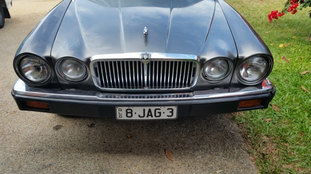

WOOHOO, now for the fun part,,,,,,,,,,,,,,,,,,,,,,,,,driving it.

Series 3 with SU carburetors? Is the fuel pump of the correct type?

I have absolutely no idea but it is on my list of things to investigate. Am really enjoying learning about this beast.

Enjoy the driving Rick, we are displaying our cars at the Caloundra air museum in June if you are interested in coming along.
