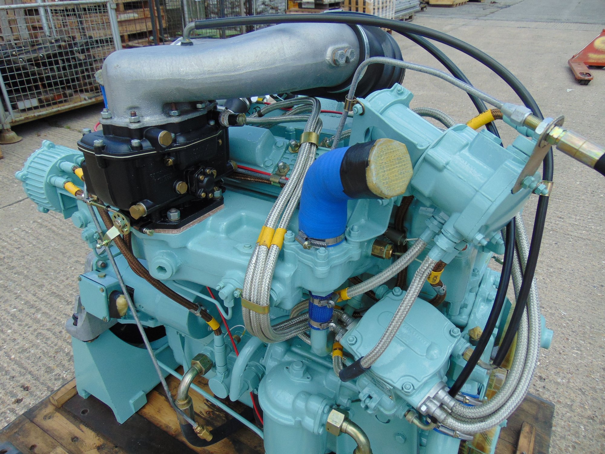

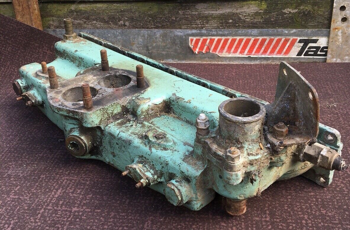

As far as I know there have only been 2 downdraft manifolds for the XK engine. One was for the original 2.4 and Mark 2 2.4 engine, but that won't fit the XJ6 cylinder head. The other was a manifold for a Solex carb that was used in the Scorpion light tank for the British Army. There have been donwdraft manifolds for the V12, but that won't work for the 6 cylinder.
Why Webers? The SU carbs are generally more flexible and give just as much (or more) power than a 3x Weber DCOE45. I have a friend who was into vintage racing and dyno tested both the trip SU and Weber carbs on his race prepared E type engine and he was able to get more power from the SU and as a benefit the engine used less fuel. He described the SU as the logical choice.
Tank manifold, and mounted on the tank engine:
