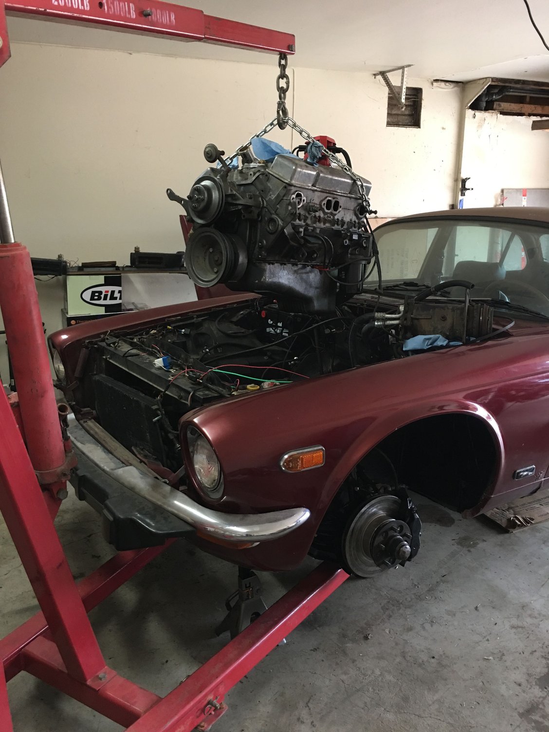

For the record, I grabbed a $200 harbor freight engine hoist and had my engine, subframe, and transmission removed in a few hours.
Part of this might be because I have a SBC, but really it can't be all that much more difficult with the original engine, can it?

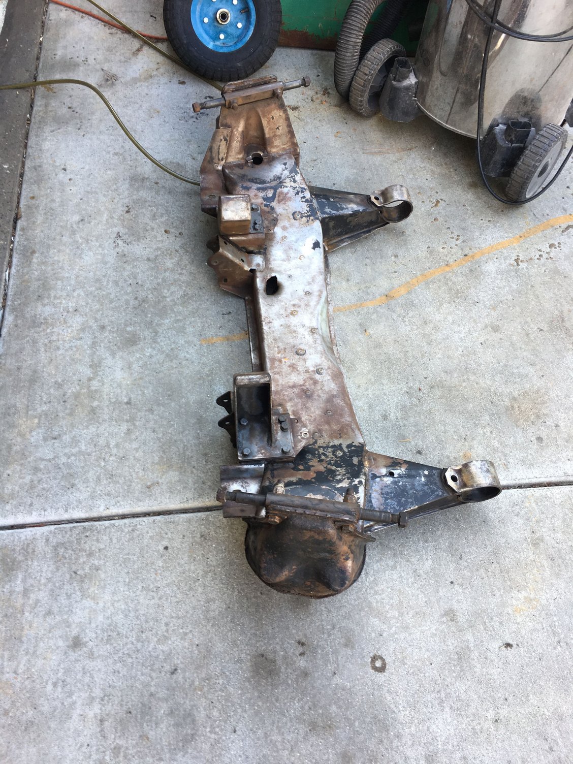

I have also just removed the subframe from the car without removing the engine. I supported the engine with an engine bar, ( also from harbor freight for a few $ ), and then removed the bolts from the engine mount and then the subframe bushed mounts to the body.
Actually, writing this i just remembered that I had already removed the steering rack to replace the bushings in the mounts. That may have made it a little easier :P
