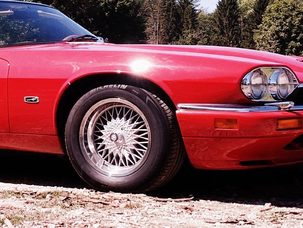

Another option would be Michelin Primacy 3. I'm happy with the comfort and the quality.
