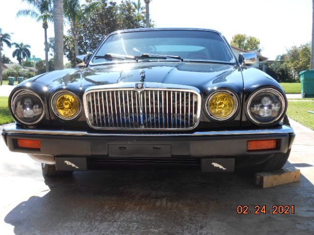

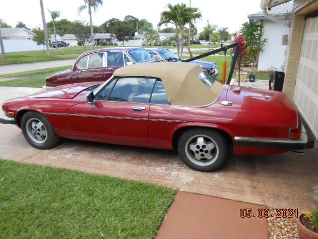

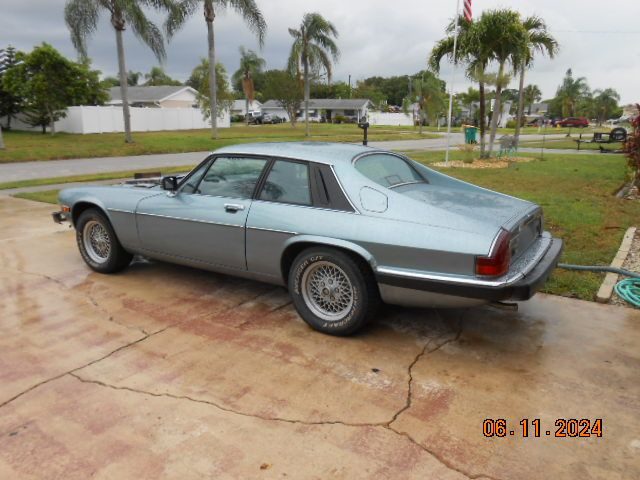

1988 XJS
1988 XJS
1990 XJS
1990 XJS
1985 XJ6
1985 XJ6

A very nice Collection of Cars that you have there and I also rounded off one of the Bleed Nipples on my V12 which was the main reason why I had to drop the Cage to take it out, at which point I decided to Refurb the IRS
