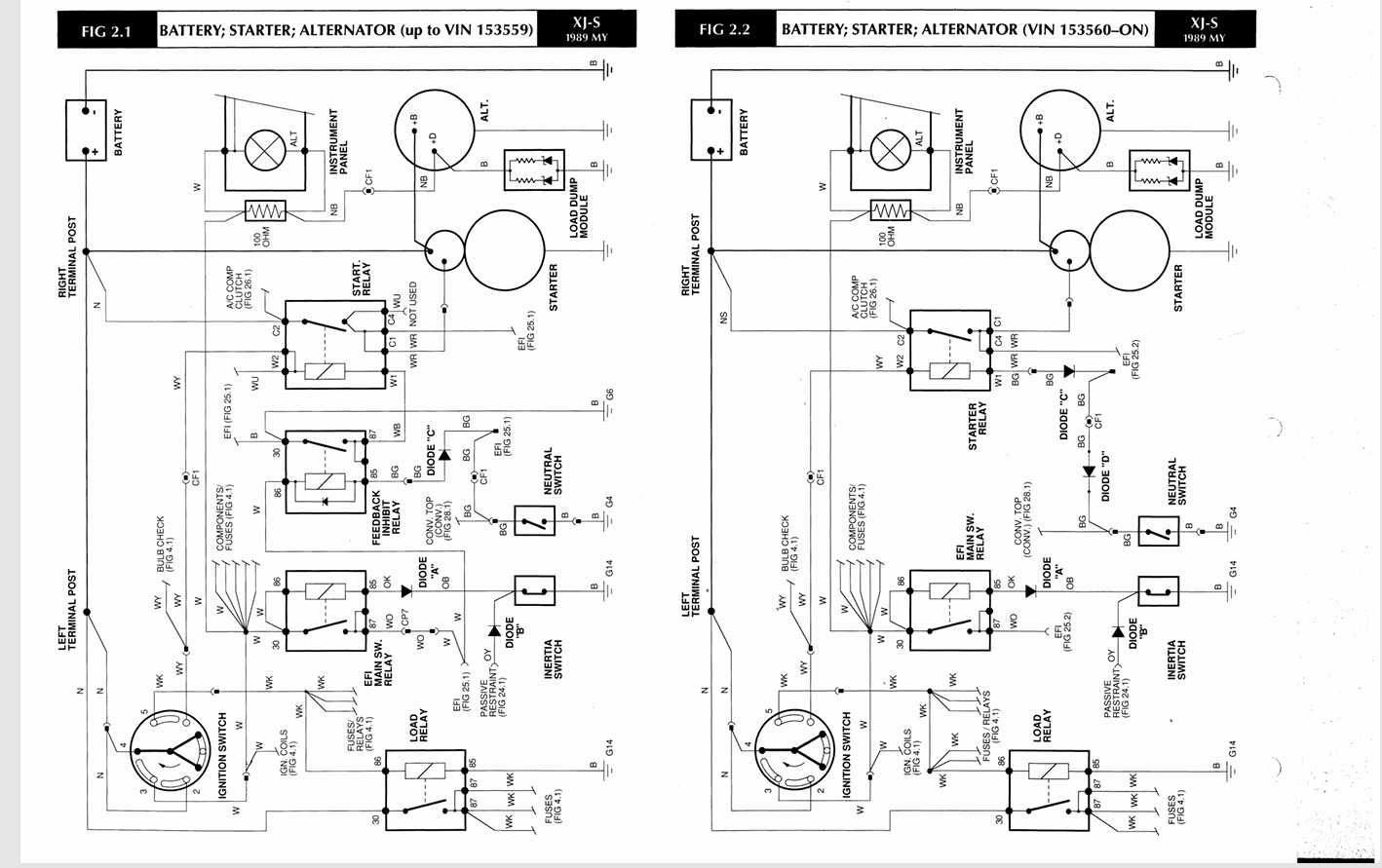

These diagrams show the dump module.
One wire goes to ground. According to the diagram they're both black. You'd need to figure out which one so that the diodes are in the right direction.

To my eyes it looks it might be brown/black. If so, that's the exciter wire that goes to the alternator together with the dump module wire
DD

Yes, it IS brown/black.
Thank you, Doug!!
