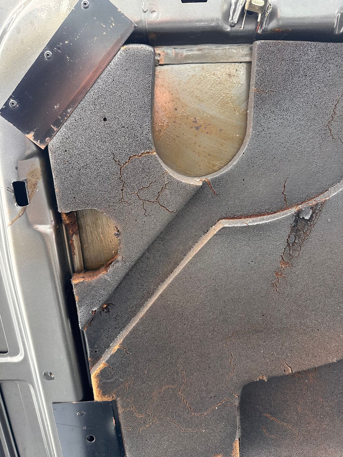

also you must make a cut out in hood insulation to clear reservoir cap.
still looks “factory”
