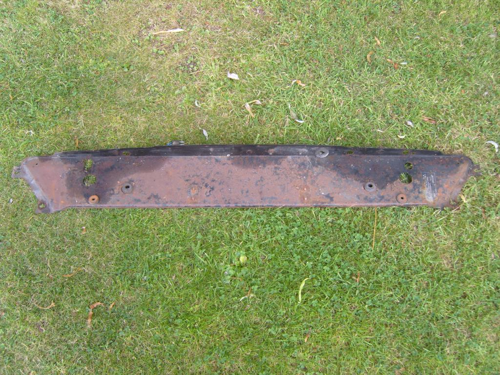

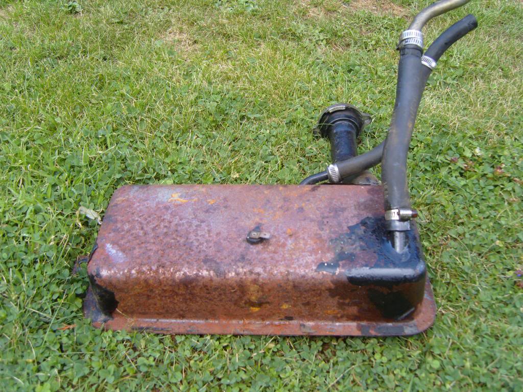

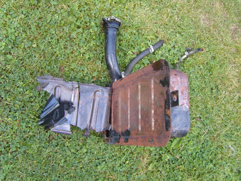

While adverse Weather Conditions are doing there best to slow me down, Thunder/Lightning/Rain and Gale Force Winds, I'm still making progress.
As the Fan Shroud looked a 'bit rusty' make that Very Rusty! I decided it was best to take it out and found it looked a whole lot worse than it actually was.
All the metal was solid as confirmed when I gave it a good Shot Blast, followed by a Coat of high build Primer.
This will then be followed by a Coat of Black Hammer Paint but only when the Primer has thoroughly dried out.
Although it was a little bit of a struggle to get out, as I did not remove the Yellow Fan.
This was nothing to the job of removing the Header Tank, which was on the Nearside of the Engine Compartment.(UK)
It was just so Red with Rust that I felt it best to take it out, so I could have a proper look at it.
It may clean up or else may need replacing, so I'll give it a Shot Blast and see how it looks after that.
But in any event, I will have to replace all the Hoses @'Greg in France'
It's only held in place with 3 bolts. (2) captive ones at the front and (1) nut and bolt at the rear, all of which are bolted through the Wing of the nearside Front Wheel Arch.(UK)
All (3) Nuts were so solid, that they could not be undone, without the risk of breaking off the Captives, so I soaked them in a mixture of 50% Acetone 50% ATF @'Greg in France'
After 3 days and nights of Soaking in this, they finally came undone, at which point I was able to remove it, after the slightly easier job of removing the hoses.
As you can see from the photos, the paint was not only peeling off but the overall condition, doesn't look that great.
So I will make a decision, on whether or not to replace it when its cleaned up, the only good news being that I've still got a spare on my Scrap Car, which may turn out to be either better or worse.

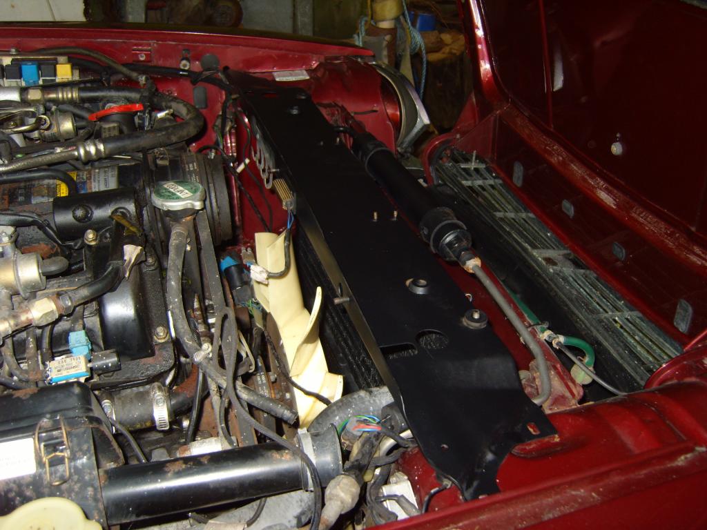

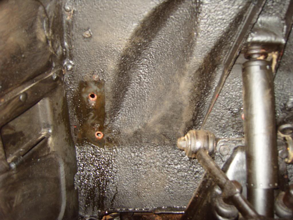

Default Radiator Top Closing Panel before and after painting
The Radiator Top Closing Panel was so rusty that I thought I may have to replace it.
After a Shot Blast and Repaint it looked at lot better, so I couldn't resist trial fitting it before I took the next photo.
But one of the studs that holds the dryer will have to be replaced.
Check out the Front Beam that holds the Main Rad, even after 24 years it still almost looks like new.
Also the Camera doesn't lie and shows up every little bit of rust! so some work to do on those pulleys and adjusters, before I replace all the belts.
She's very gradually starting to come together.

Terrific job on the cross panel OB. Congratulations. I am glad it is all coming together. The belts will not take too long, just soak all the adjusters with some mixture for a day or two before. The car lokks great and the cross member underneath the rad is amazing.
Greg
