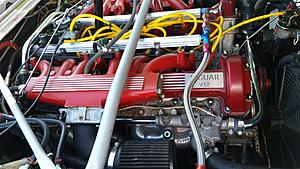

still a mess of old stuff.
go O-ring injectors ,top and bottom, custom rails,etc. can take over 200psi pressures. last for the rest of your life.
comon get into the new world.

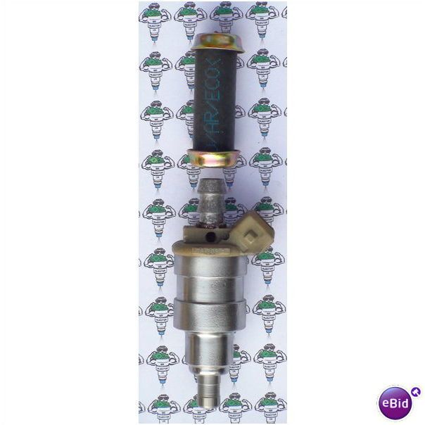

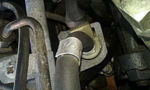

As can be seen from pics there were several different configurations of barbs on the different injectors used, some for ferrules/cups and some meant for clamps. Those with the single barb are for clamps and safe to use since there is no barb in the clamping area of the hose. I only have an image of the early clamp rail barb, the later model is multi barb same as later injectors and meant for push on ferrule use.
All hoses, at least on the HE are push on ferrule fittings. The pipe fitting shown is the right hand FPR to rail fitting with the original ferrule and a replacement of the type used to renew all my hoses from tank through to engine bay.
