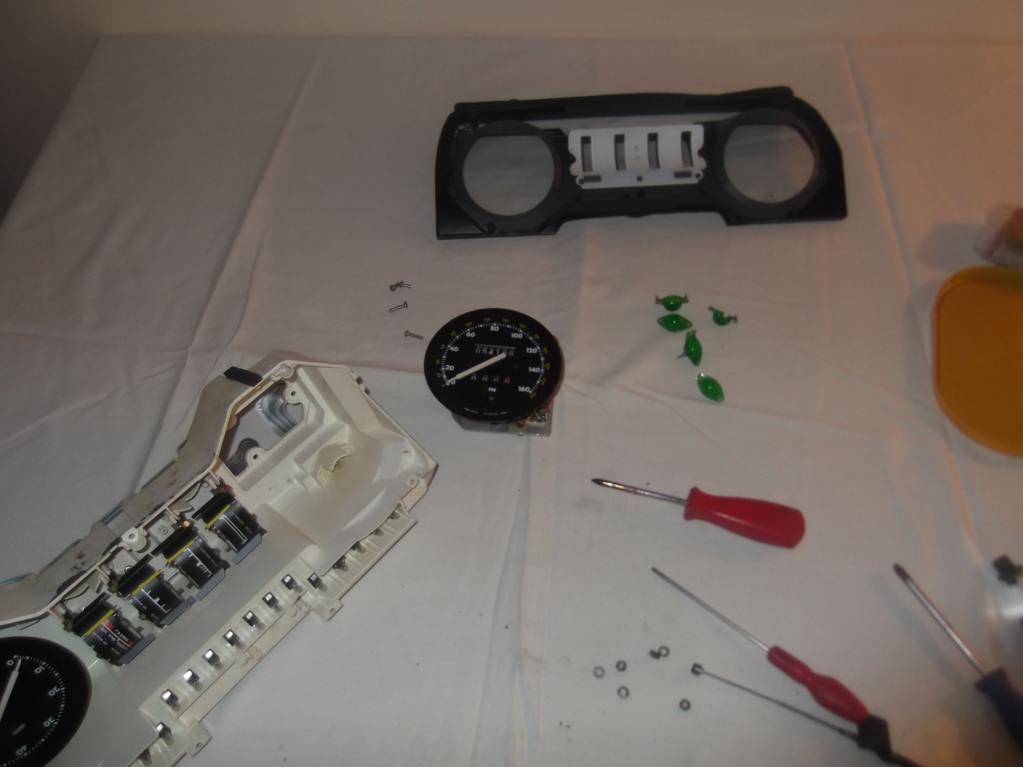

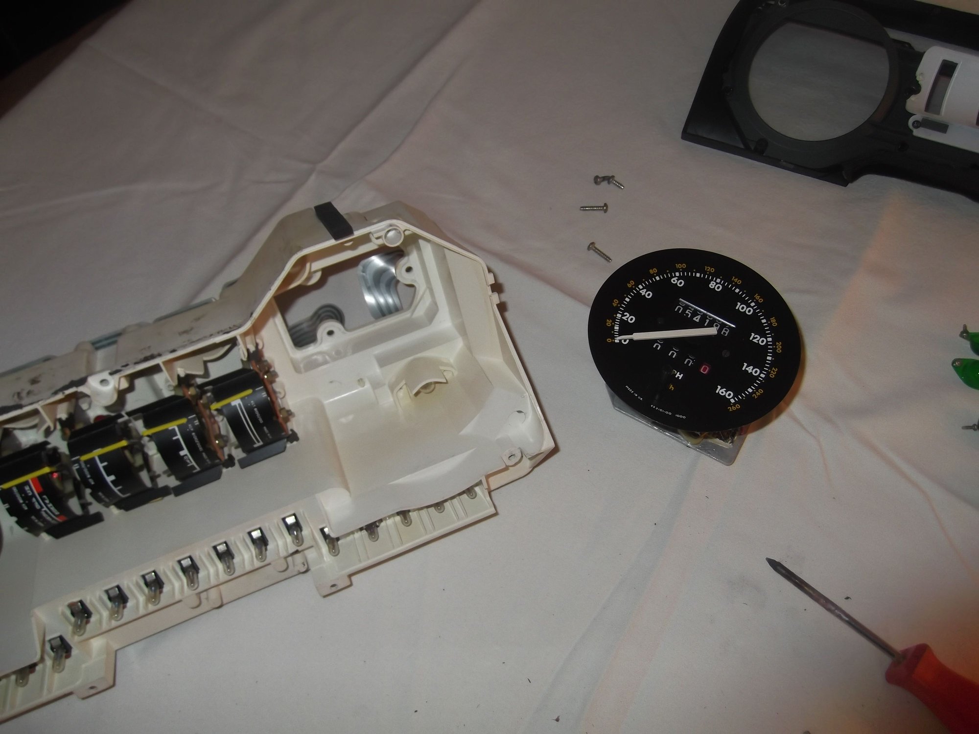

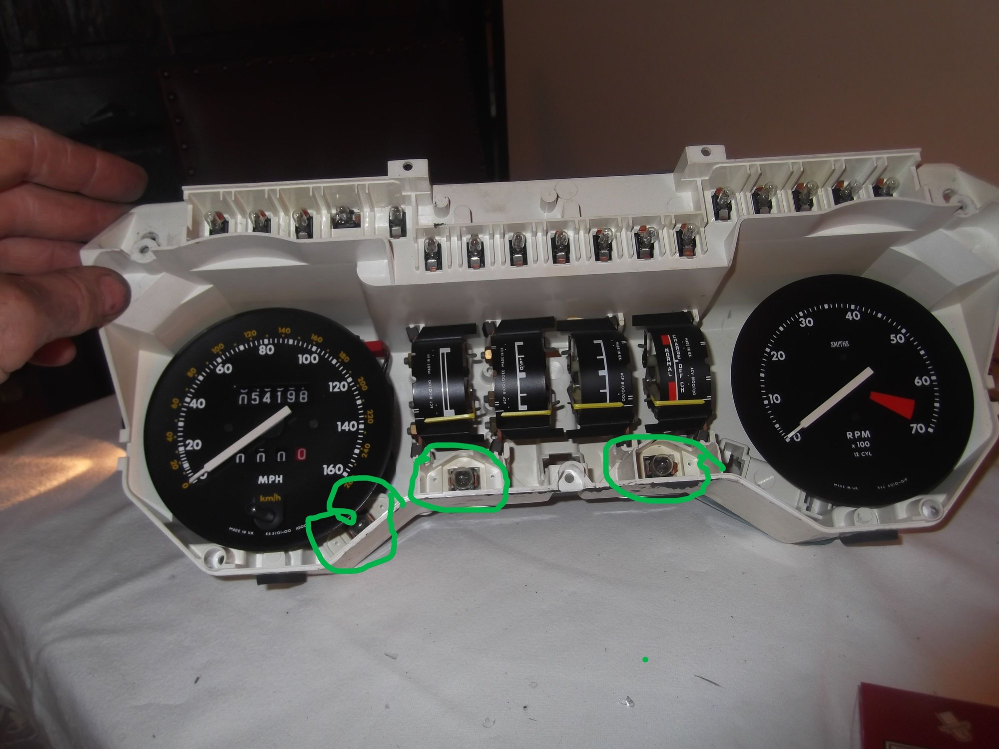

Cannot find my thread/posts, but here are some photos
Cluster white part off the black front part reveals the green filters
Green fiters off the cluster, these were, in fact, not darkened.
Some of the green filter locations, you can jusr see the small rivet holes that hold them on each side of the bulb hole
