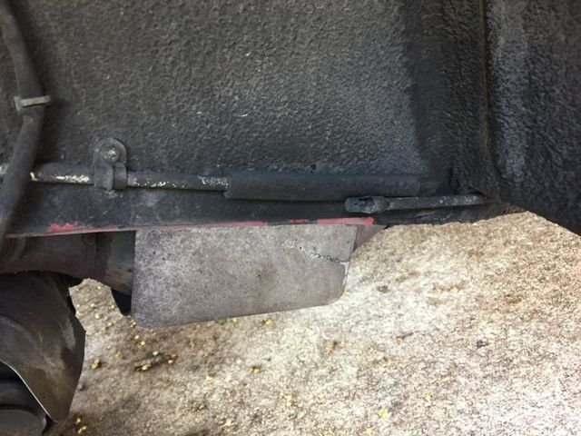

While accessing the overflow tank that is in the wheel well, I noticed what appears to be a disconnected and stoppered vacuum line in the LF wheel well.
What is this from? What's broken that I should probably fix??
Thanks in advance!
Brad
'91 XJS (Ginger, 72K miles, V12)
Should this be re-connected and the underlying problem fixed??

Looks like it's to do with the useless charcole vapor system.

Is that what the canister is that is forward of the LF tire in the wheel well?
Brad
Old Sep 2, 2019 | 12:49 AM
Greg in France's Avatar
Posts: 14,581
Likes: 10,775
From: France
Yes, it is.

Hello Brad
Just a question - yes it looks like the line that goes from your vapour canister near your fuel tank to the carbon canister under your Left hand front fender.
But if it stopped (or plugged) how is your fuel tank venting to atmosphere?

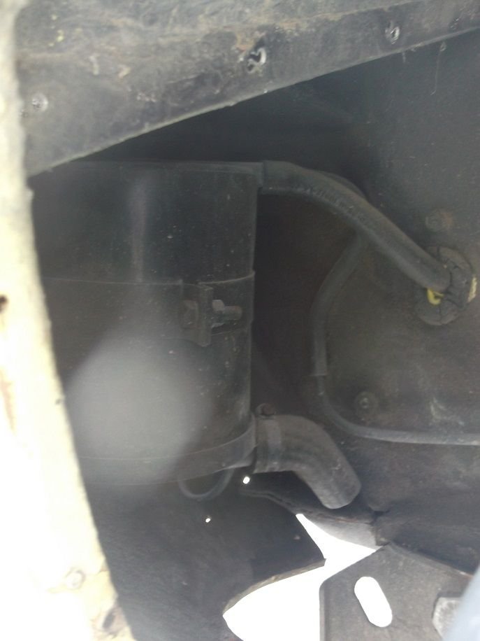

Hello Brad
Photo of my canister. My model is 10 years earlier than yours - so it might have changed over the time

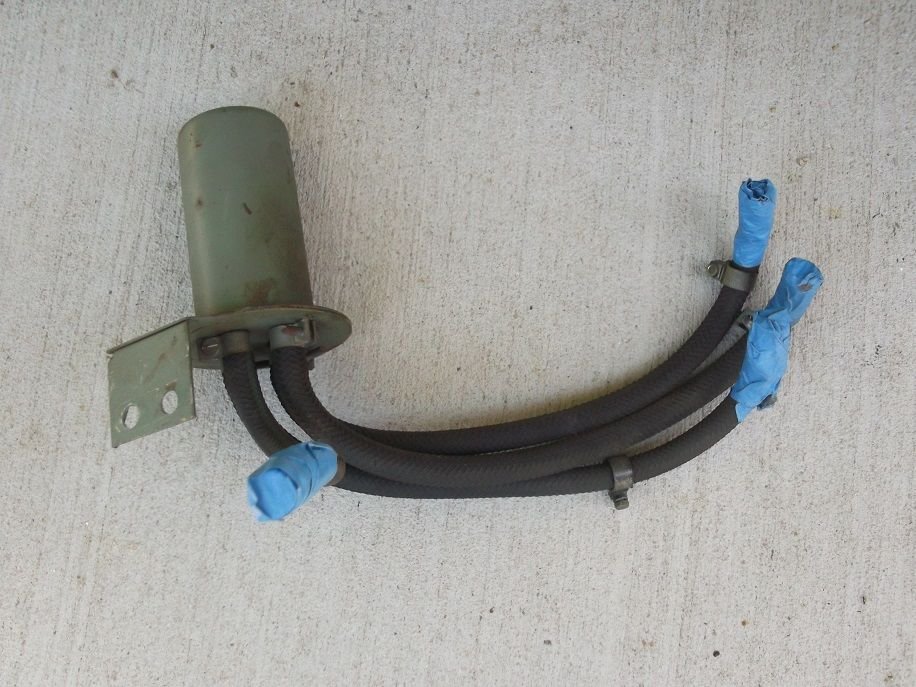

Hello Brad
My next question would be - where has the previous owner made the first change.
In the boot/trunk on the fuel tank - right hand top, there is 3 vent lines that go to what I originally called a octopus thing - which is actually the fuel/vapour separator, positioned above the right hand wheel arch.
2 of these lines vent the fuel tank (the 2 smaller hoses). the 3rd returns any liquid that happened to be in the vapour back to the fuel tank.
There is then an exit pipe that goes behind the fuel tank, under the car back seat, and then through to the LH fender charcoal canister.
If all of these lines are still in use - the easiest way to keep the pressure out of the fuel tank is by unblocking the vent line in your first post. Depending on where you are in the world, this is either acceptable or not
There is also lots of forum posts saying this vapour canister is not the best of designs, but to remove it and install another vent means the fuel tank comes out

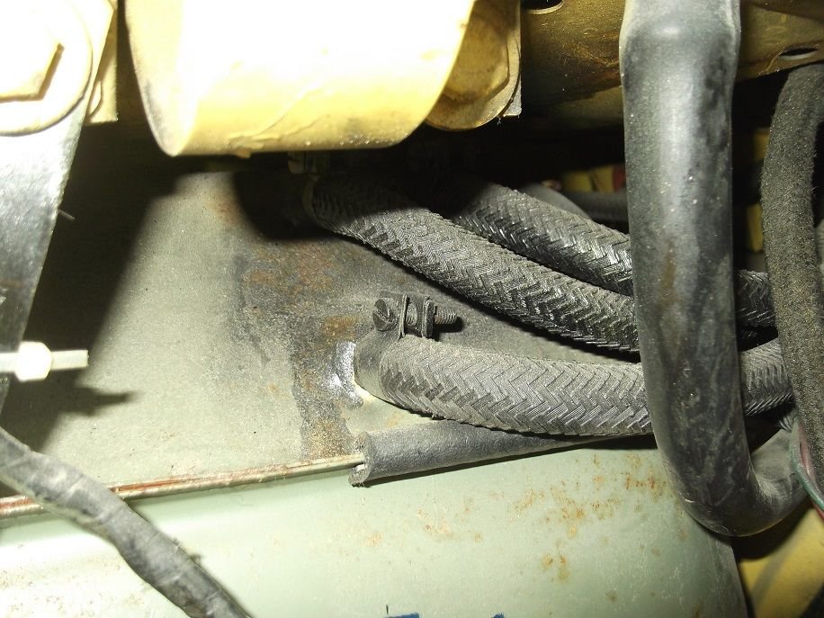

Top right of fuel tanks - top 2 connections are vent lines to the VS, bottom line is the return from VP

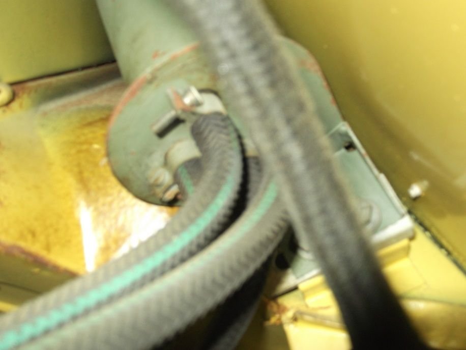

VP tucked in above the wheel arch
VP removed (is now redundant on mine)
