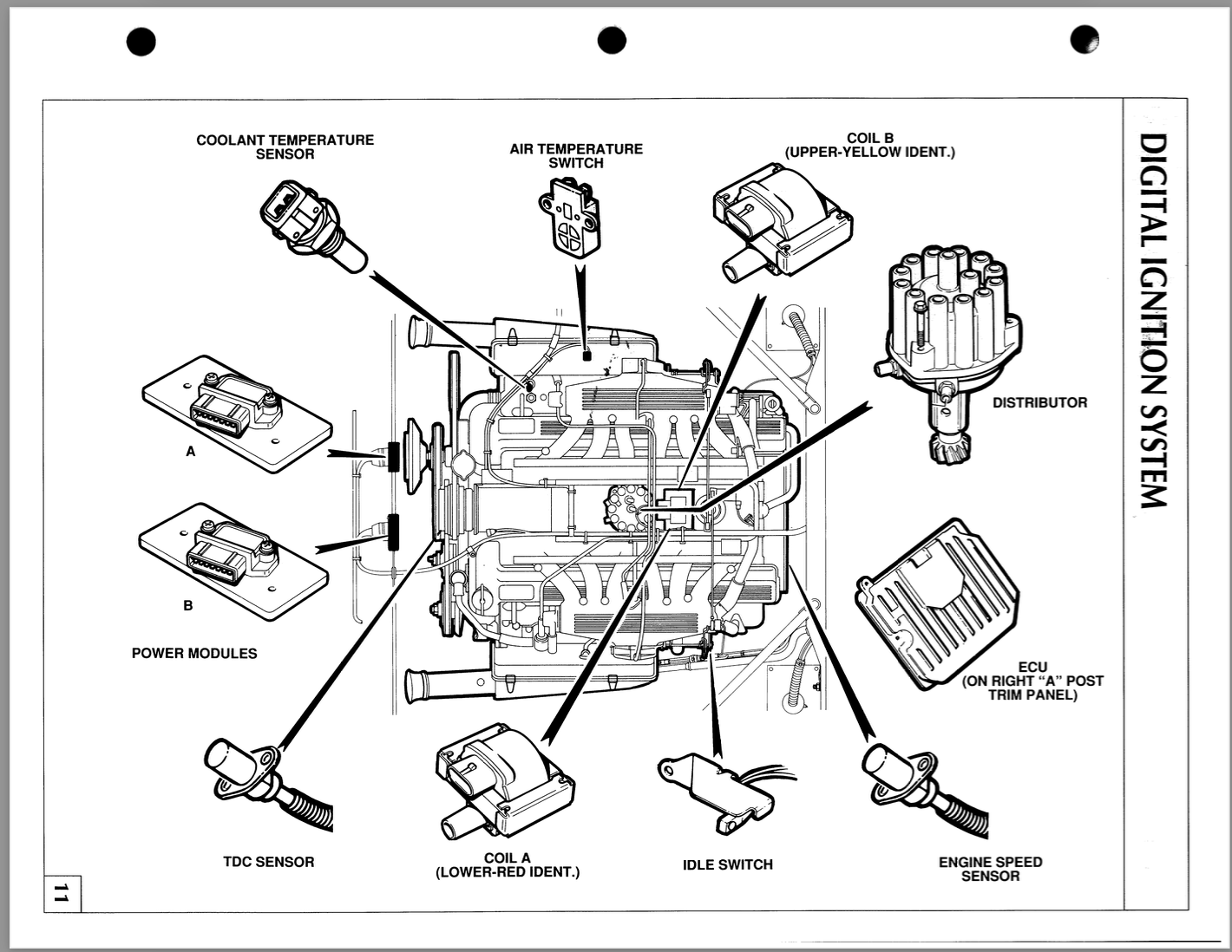

I might not have eliminated the CTS after all. I did the paperclip test on the sensor located on the LH side per @Grant Francis 's won't start .pdf; however, after looking at the Marelli Supplement doc, it appears that the Marelli cars use the RH CTS to send a signal to the ECU.
Is this correct?
The RH CTS is harder to reach and I don't want to go disturbing things to the do the paperclip test if I'm incorrect.
Also, it shows that it uses the Air Temp Switch on the RH air housing, and doesn't reference the ATS on the LH air horn. What does the LH ATS even do if it isn't wired into the ECU?

Mac Allan,
I've just read through various sections of the Workshop Manual and it's pretty clear that it uses the sensors on the A Bank as per your pic. It. also states that the Primary Inputs which are necessary for starting are the 2 CPS. It says that the CTS is a secondary input and will not prevent the engine from starting. Take that as you will!
Paul

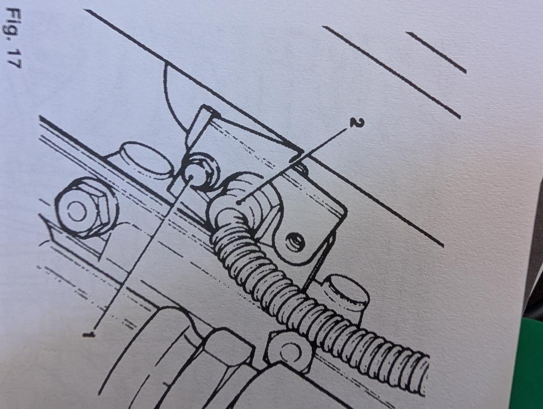

Old Aug 16, 2025 | 09:31 AM
RickE's Avatar
Joined: Apr 2016
Posts: 209
Likes: 91
From: Southwest Florida
Old Aug 16, 2025 | 09:50 AM
Mac Allan's Avatar
Joined: Dec 2014
Posts: 1,893
Likes: 983
From: California
Thank you @RickE !
What is the “timing bracket” in step 4?
