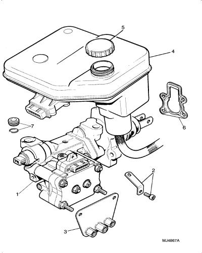

OB,
Found these part numbers.
1) O/ring and seal kit = JLM1477
2) Valve block kit = JLM11337
The picture from my parts lookup has a seal #7 shown, but NO parts number for it, which is rather frustrating. I reckon #7 is what you seek.
Attachment 110885
Attachment 110885

OB,
JLM1477 is the reservoir seal kit which contains the mounting seals for the reservoir as per your second pic. It doesn't contain the flat seals for the valve block. I'm struggling to find anyone who advertises that they can provide these seals for the Teves Mk II.
I think you're going to have to go to a seals supplier and get some suitably-sized ones which are made of EPDM or similar for the valve block.
Hope that makes sense
Paul
