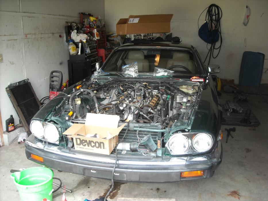

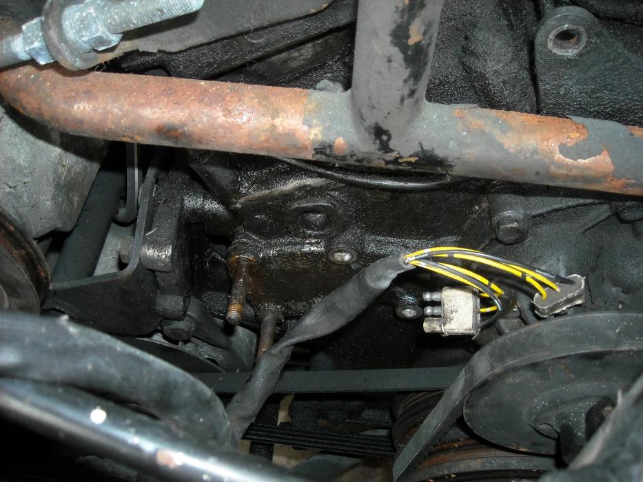

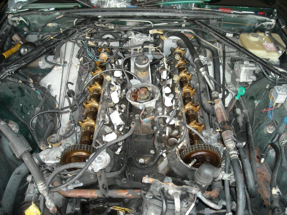

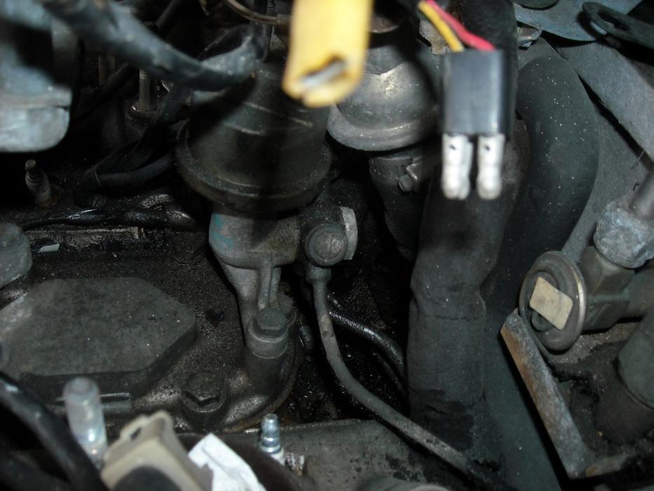

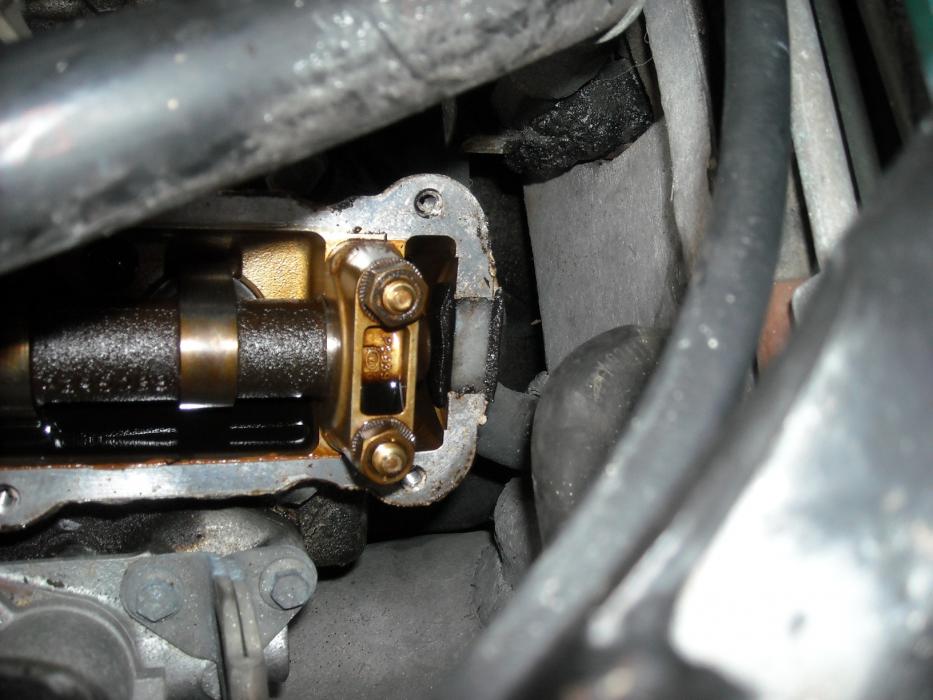

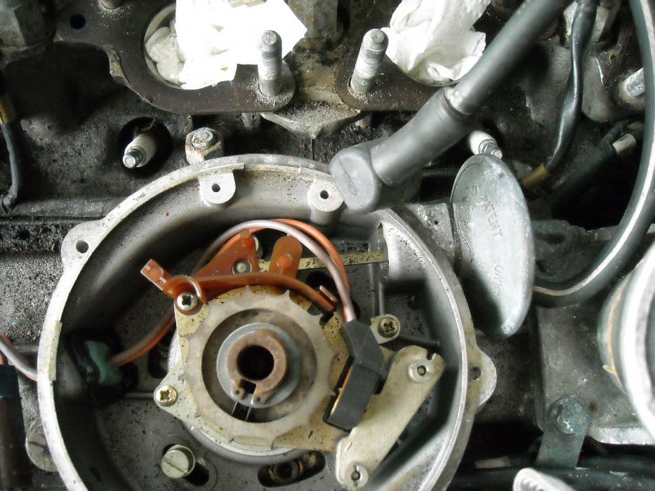

I've attached some pictures of my engine while I've got the valve covers off. Without the spaghetti maze of wires and hoses running around, it actually looks like an engine!
I've taken pictures of the common problem areas I've read about....Halfmoon seal on back of head (mine leaked) , oil banjo bolt (mine leak, the picture is the one on the sending unit), vaccum advance (frozen), timing adjustment plug (leaks).

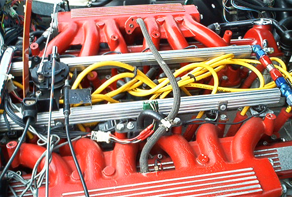

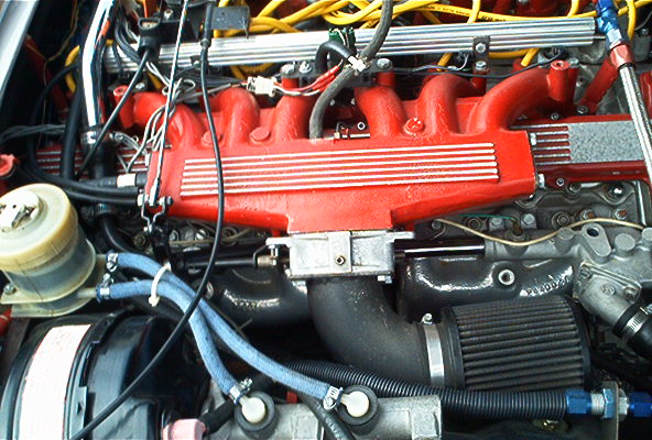

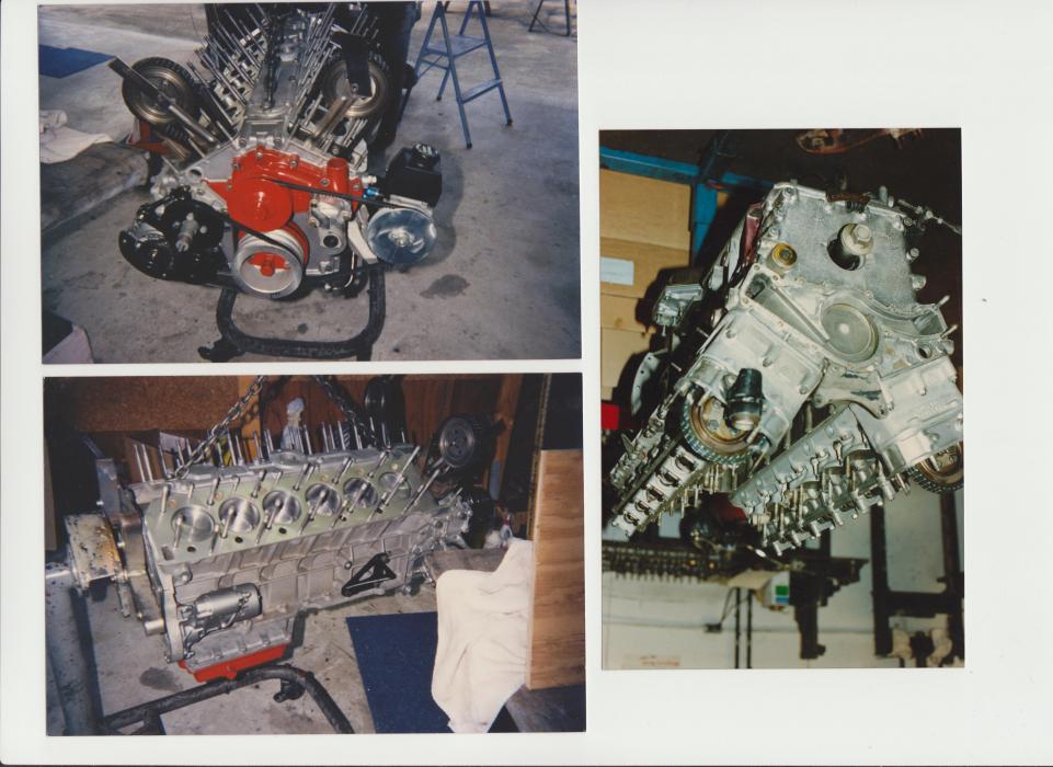

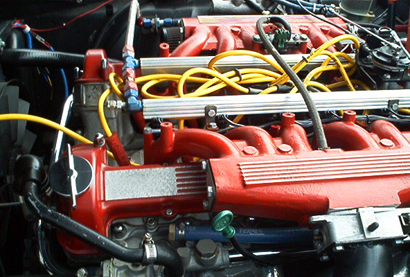

my engine after i removved a bunch of stuff, right on, you can actually see the engine .LOL

Wow! Looks great. I see you took out the A/C, I'd be lying if I said I wasn't considering doing the same thing. Removes alot of clutter and I would guess allows a little better airflow into the V of the engine withouth the pump in there.

In the first picture you can two wires coming out of the distributor. If the connector isn't fully seated the car will conk out 200 miles from home. With so much "stuff" piled over the connector you'll never be able to see the problem while trying to fix the car in the parking lot of an art museum. You'll give up and spend $300 to have the car towed home.

ronbros how did you make/where did you get that intake setup? similar design to a growler but the diameter looks bigger and doesn't look like it ran your $300+

made the elbows from 3" diameter 90*steel tubing ,welded to a flat plate ,cut and finsihed to the 6mm oversize throttle bodies.
tubing around $15. each , and around $20. for the air filters, K&N, 2 for clamps.
works great and low cost,give it a try, nice noise when on the throttle.
you do not need the big TBs, that cost a bit more(lot).
