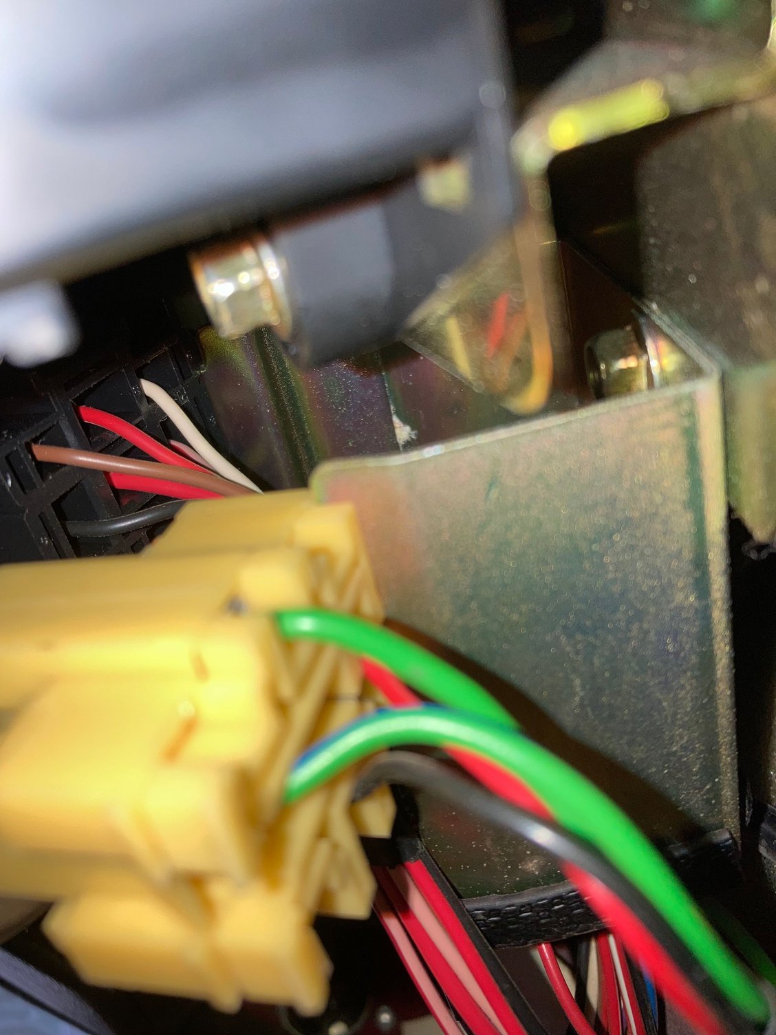

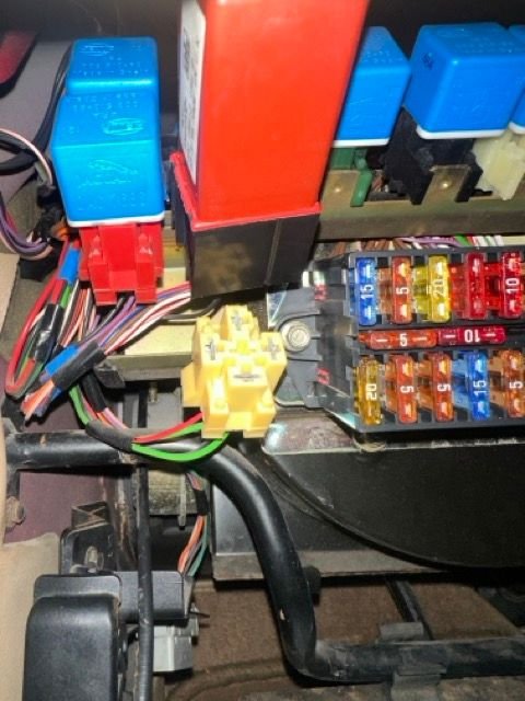

Hi, we have no indicators or hazards and I believe the relay flasher is missing as shown in photo below, situ LHS drivers side the yellow relay holder
Can anybody confirm the part number for the relay, i believe it is a 4 pin, thanks and any pictures welcome to confirm correct location

It does seem as if the flasher unit is missing.
I'm assuming you don't have the workshop manual etc? See here for the the electrical wiring diagrams for your car and you'll see the relay layout:
94 XJS 4.0L Electrical.pdf
Also see here for Jaguar's parts website and the part number for the flasher unit:
Genuine Relay And Fusebox-driver's Side For Jaguar Xjs Sports Coupe/convertible 1975 - 1996 Classic | Jaguar Land Rover Classic Parts
Good luck
Paul

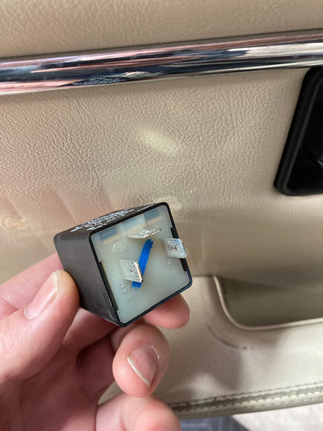

Fwiw, when I put LEDs for the turn signals in my '94, I used this:
Vensans Flasher Relay, CF14 JL-02 3-Pin LED Flasher Flash Relay for Turn Signal Light Hyper Flash Fix 12V_PQ https://a.co/d/c3NDOsR
It is a 3 pin and I believe should work for regular bulbs.

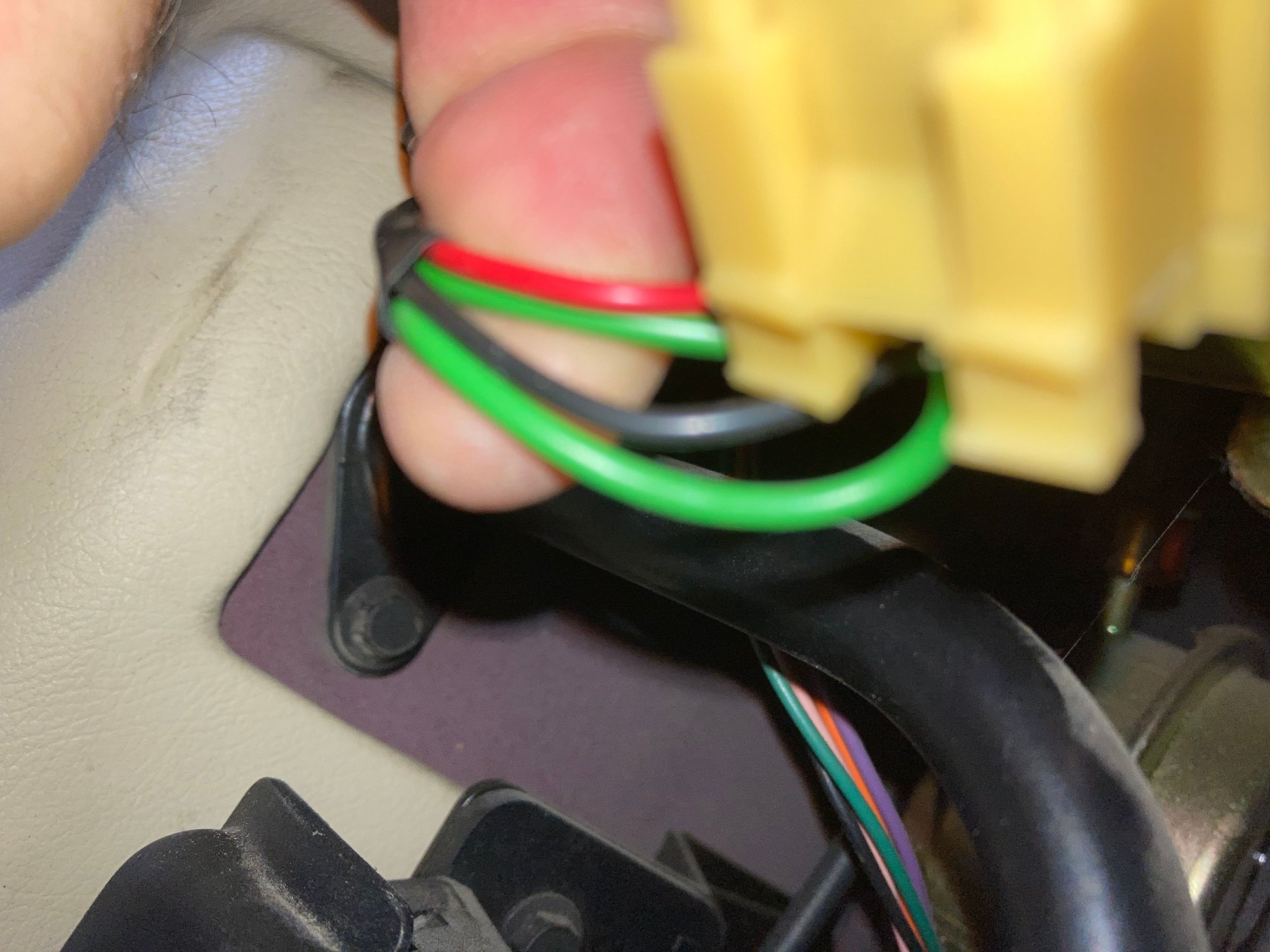

We come back to the flasher relay that we still need to source. We have 4 wires into the relay block as per first photo. It needs a 4 pin relay as we have tried the 3 pin and still no indicators or hazards (fuses blow)
Can anybody confirm the flasher relay used in a 95 Convertible ?
4 pin is a DAC 1731

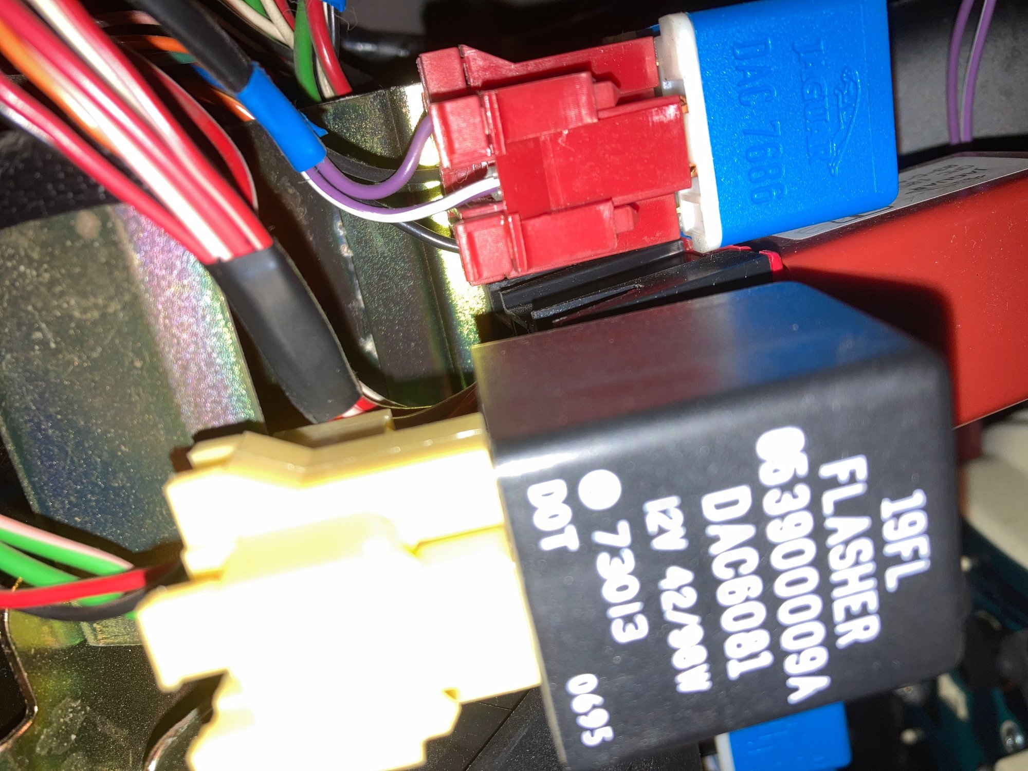

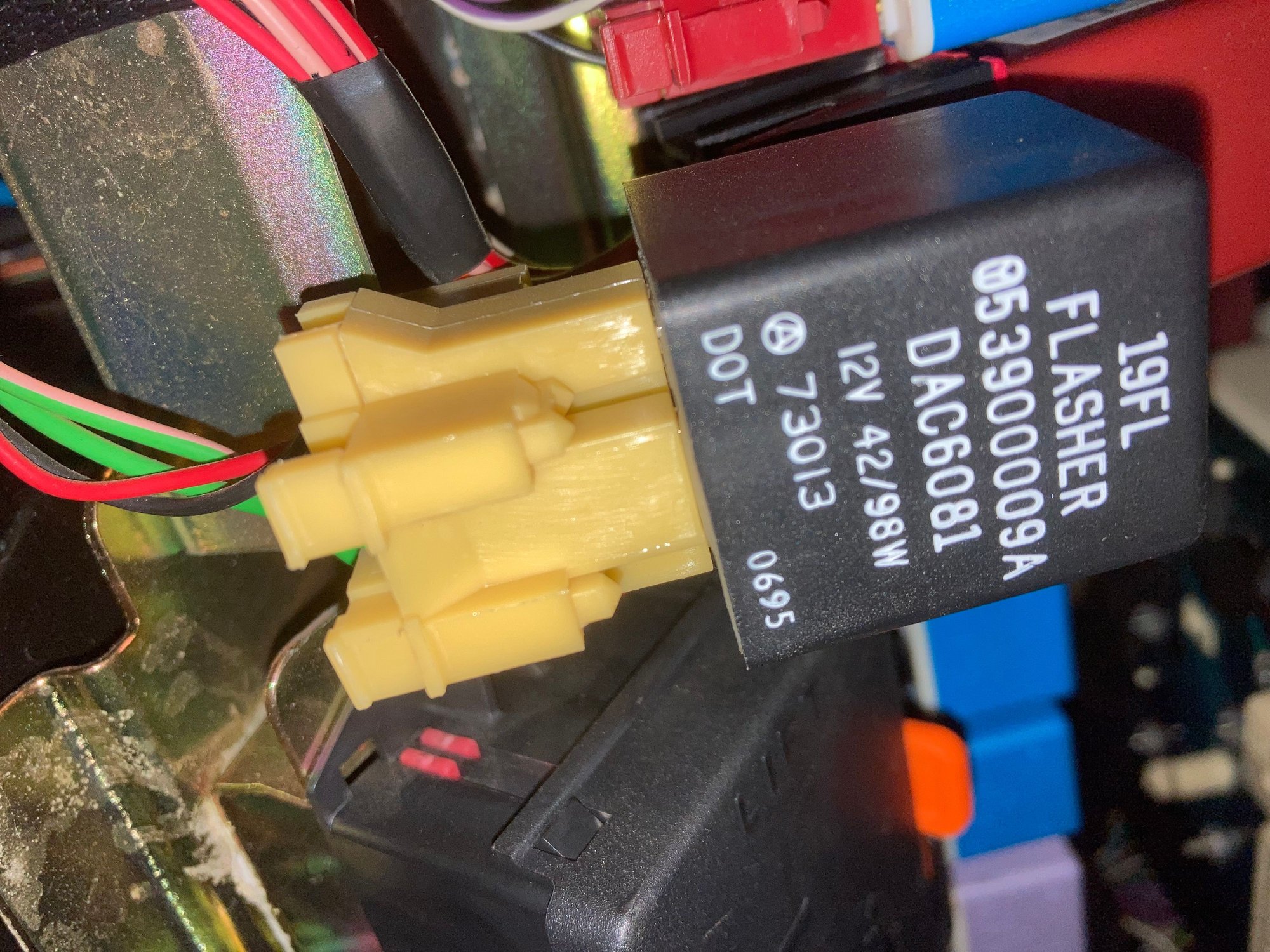

This is what is in my 95 XJS , I know it’s a little late but might help

Thanks, do you have 4 wires going to the relay flasher block (yellow) , that relay is only 3 pin correct ?
Old Feb 25, 2025 | 11:20 AM
Scottsxjs95's Avatar
Joined: May 2024
Posts: 25
Likes: 5
From: WA.
Yes four wires going in, three prong flasher.
