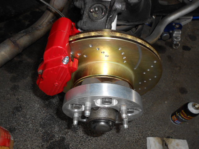

rotors,rotors, i simply bought new ones , made for performance work, slotted and dimpled, cost was cheap! and gold anodized coated(dust dont stick easily).

i paid $195. shipped to the door, pair of EBC Gold, slotted and dimpled.
1978 Jaguar XJS ,fronts!
i dont know about Genuine Brembos for $37. each.
heck , just throw a set of pads on it,forget the resurfacing, save money!

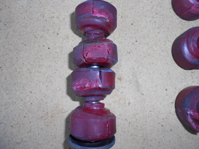

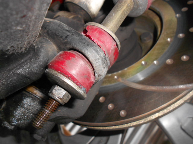

Sorry for the hijack, but what bushings are those? I would like to know so I can steer away from them, since they are coming apart in chunks.
thanks
i posted on another thread some pix, you are right cheap polyurathane bushes, changed to quality ploy-rubber , much better.
