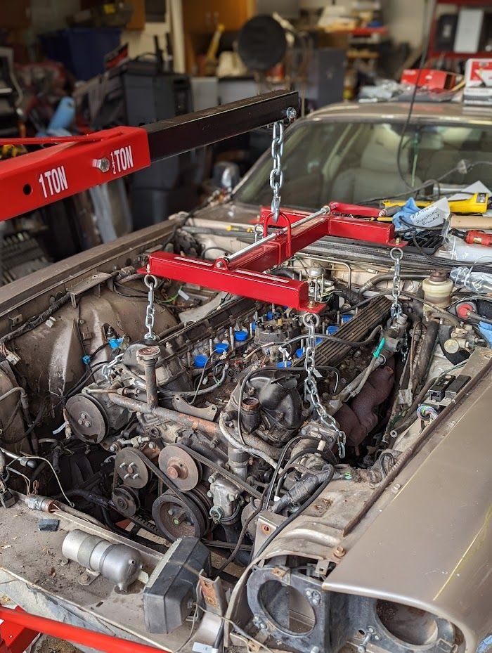

The plan is to remove the '88 engine and transplant it into the '85, along with stealing various bits and bobs from the '88 to replace worn items on the '85.

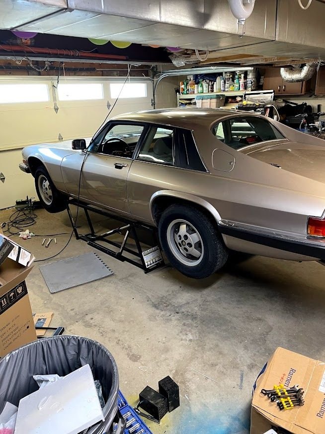

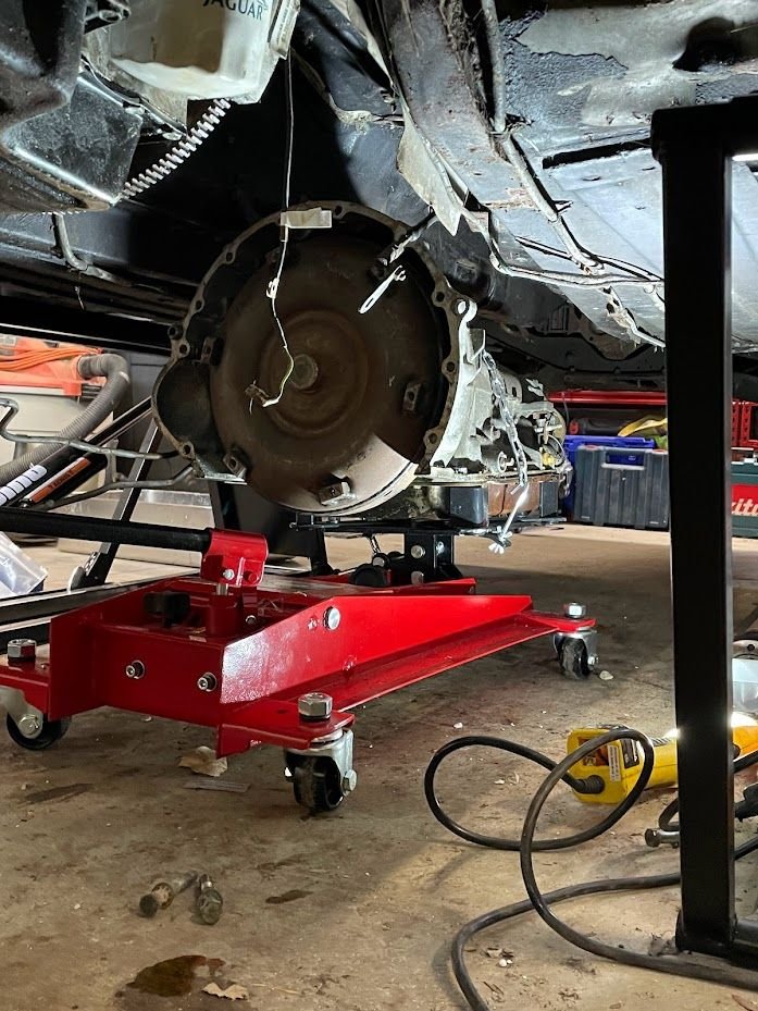

88 is in the garage and we're ALMOST ready to remove the transmission from below as our garage ceiling is too low for a full list as one unit. Not the preferred route, but I want to have the engine out and the destination 85 in the heated garage before the winter weather hits.

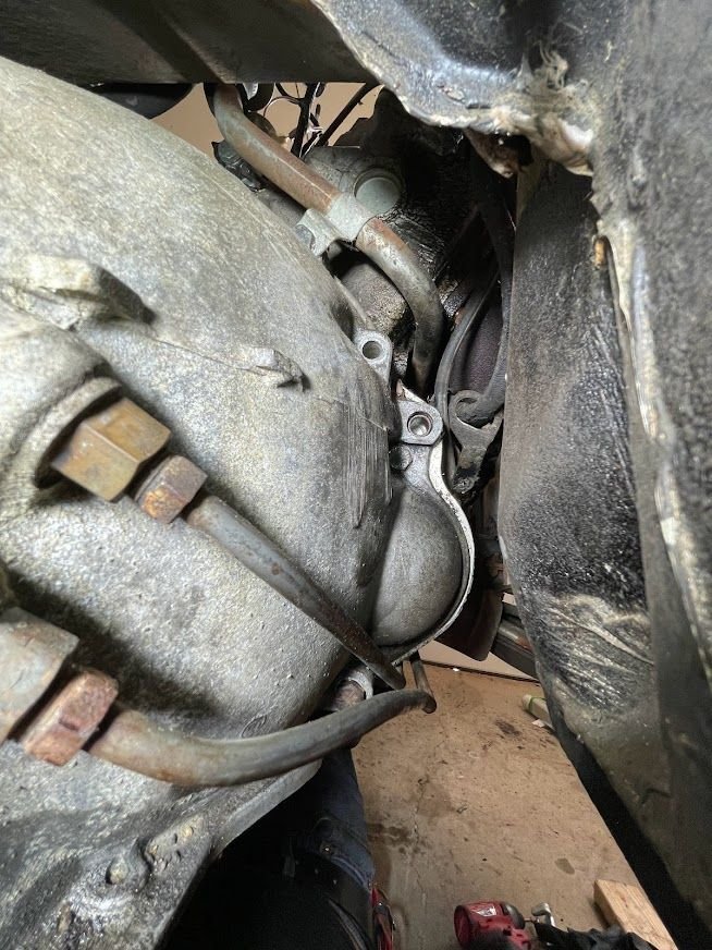

The issue is, somehow, someone managed to get the 9/16 bolt into the upper starter bolt position instead of the T12 that is supposed to be there. Grinding down sockets to make them thinner walled has proven ineffective, and I believe my next option is to grind the head off.
I am not overly concerned about damaging the transmission housing since this has shifting issues as well as a bad parking pawl and I do not intend to use it.

Victory!
I also now realize this "low lift" transmission jack is, in fact, NOT low enough, and I'm going to have to roll the transmission off the jack onto something lower

What version of Quickjack are you using? 5000lb? Extended version?
Jon
Old Nov 14, 2021 | 05:56 AM
AngryRadish's Avatar
Joined: Nov 2021
Posts: 7
Likes: 21
From: Wisconsin
Thanks!
I have the 5000 extended, and I cant say enough good things about it. Not having to constantly jack and place jackstands is quite the change.
After talking with the helpful folks at bendpak, the Jack points are exactly .5" too far for the standard version to fit comfortably.

You need min 21" of clearance to remove the th400. I had to jack my car up 24" at the lowest point to get it out.

When I dropped my trans, I had it in a floor Jack and a 2×8. When the floor Jack bottomed out I set the 2x8 on a stack of 2 bricks on each side. Then formed a ramp and did it to the floor and dragged it out.

That is a great idea about forming a ramp, I've been thinking all week about how I wanted to get it down from the jack this weekend before the engine removal.

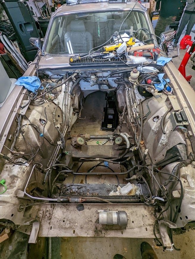

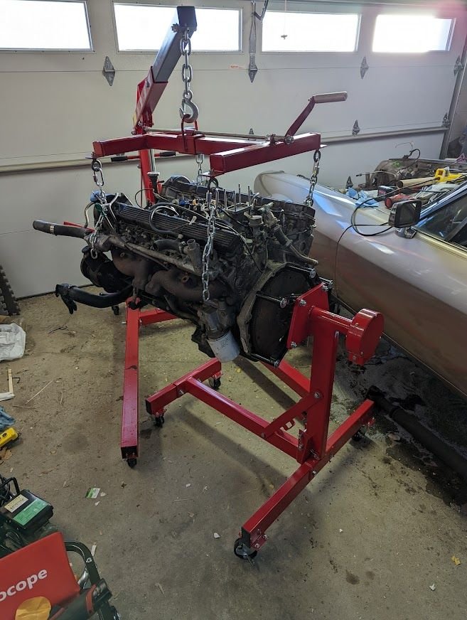

Rolled the transmission off onto some foam pads I had around, worked perfectly.

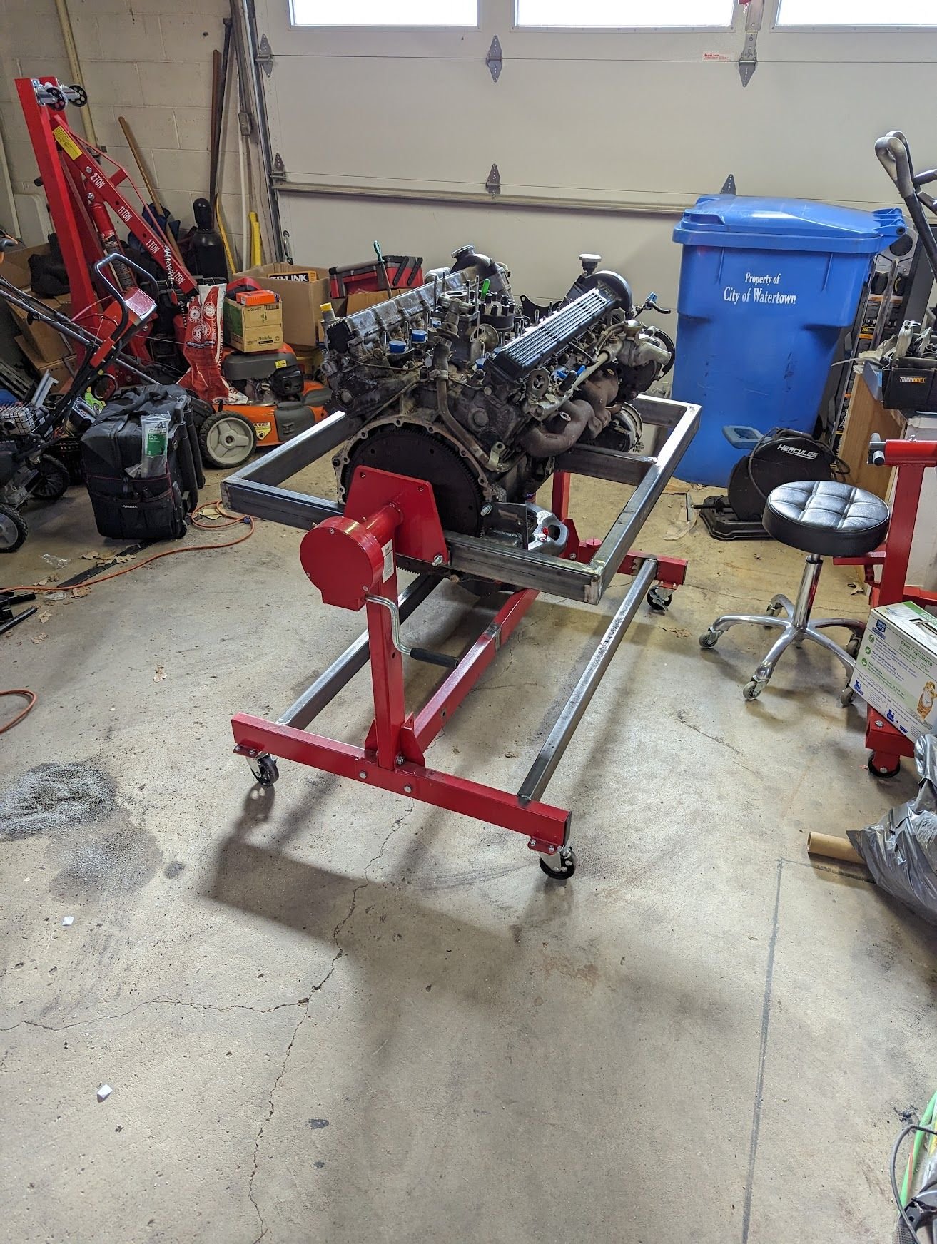

The engine pull went perfectly, however I don't really trust the engine stand with the full weight. The amount of flex is somewhat concerning with such a long block, especially loaded.

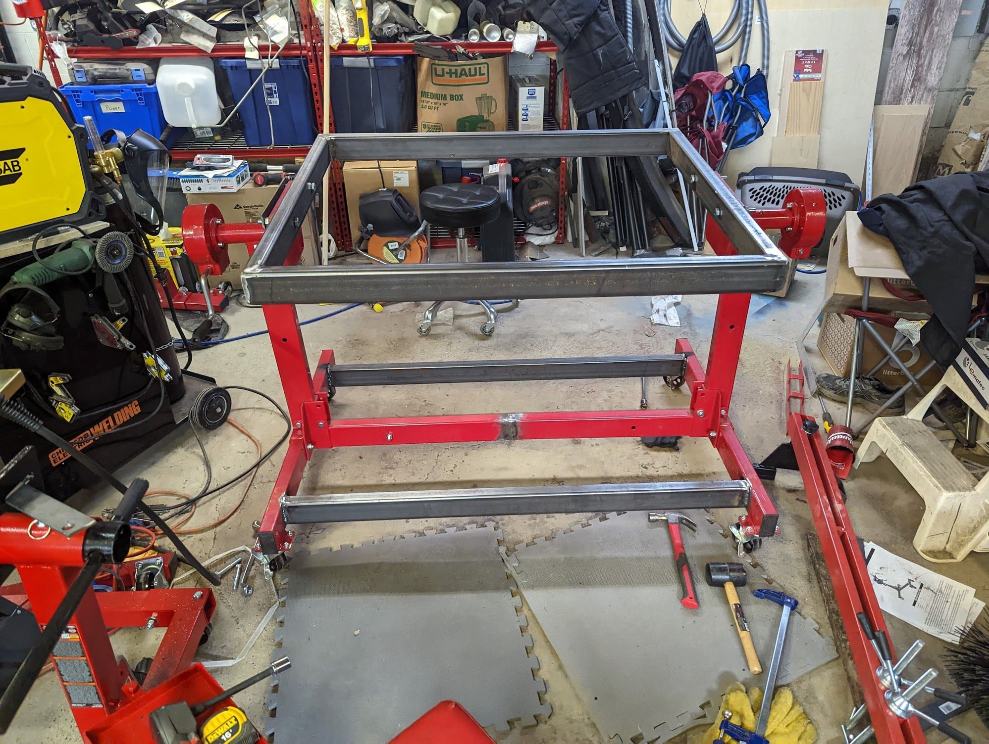

My current plan is to grab another engine stand and some more steel, and weld up a stand like over at

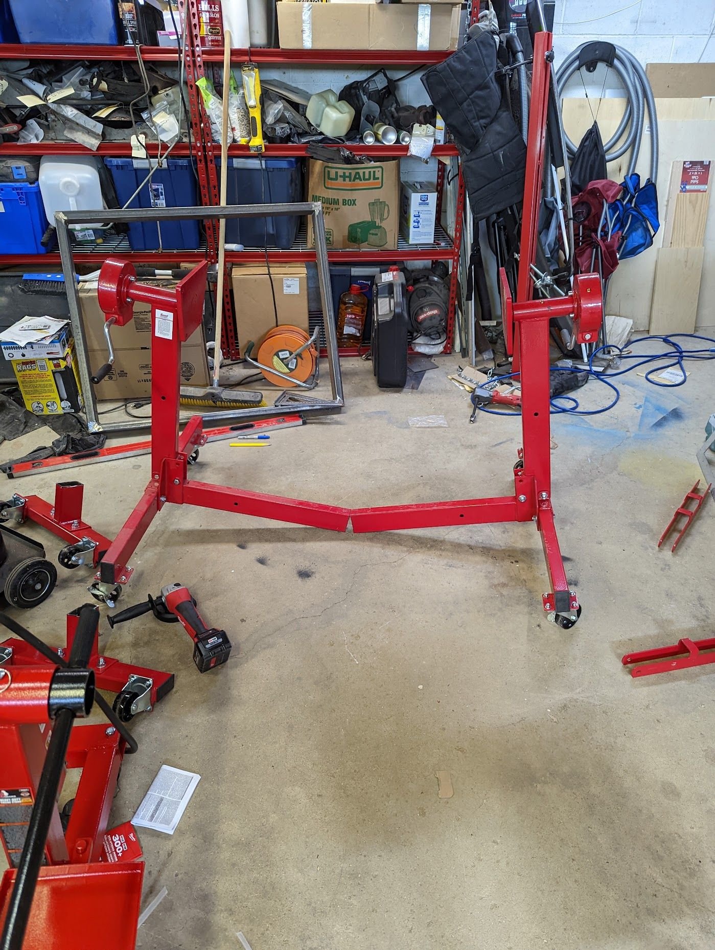

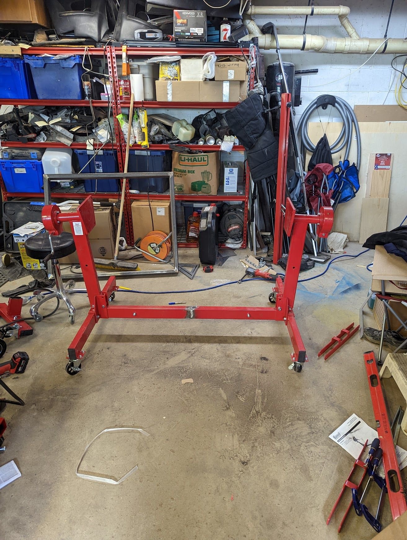

An Update,
Now that Summer projects (Deck build) are complete, I can get back to this thing.
Merged 2 hand-crank stands and am quite pleased at the balance and ease I can rotate the motor!
