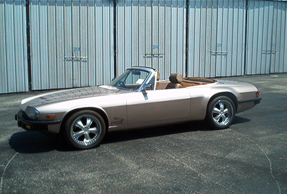

i used 18/9 frt wheels, 18/10 rears, ENKEI, with a spacer(mine is not an all out race car).
Nitto 295/35/18 rears,, 275/35/18 frts. KDWs.

that is a beautiful car!
nice flare in rear!

my tires are 275-35-18 frt,, 295-35-18 rears, and dont rub lock to lock!
been 20 yrs ,Maybe i was ahead of the curve back then, should i go to smaller tires?
this whole thing about tires and wheels is just a personal thing, and something to talk about.
to each his own, really all they have to do is go down the road, and make the owner happy!

Jon, post number 3, wheels are ENKEI. 9frt,, 10 wide rears. Pix.
